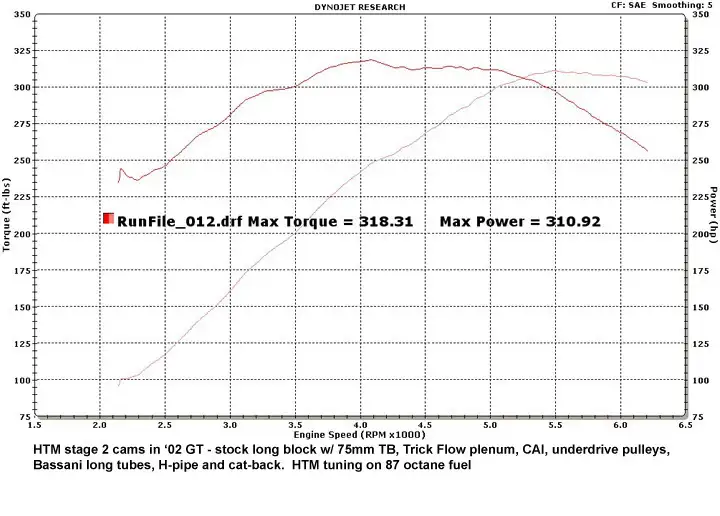

CobraRed you posted HiTech Stage One information. Let me post the stage IIs.
HiTech Stage IIs
I can't wait to see what I will make with 93 Oct gas if the above is just with 87.

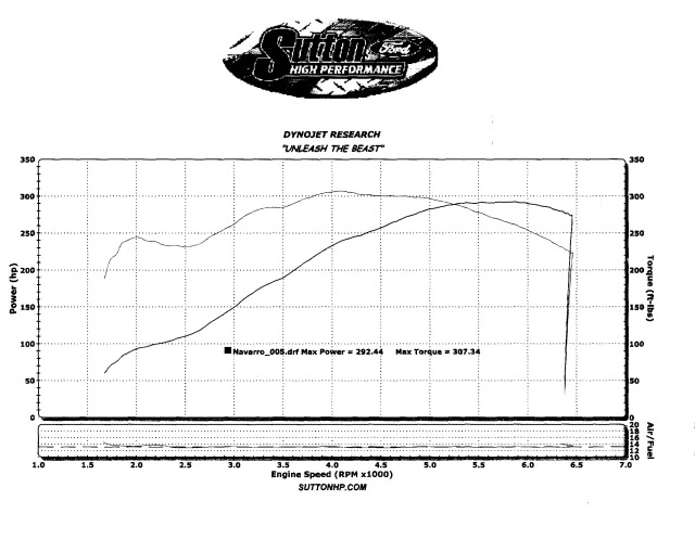

I bought my cams and valve springs straight from Cushman Motorsports website. Jim Cushman recommended Manley Nextex springs over the comp behive springs for the stage 2 cams.
Below is my dyno sheet......

Wow - I think that dyno sheet just made my mind up for me. Do you have any other bolt ons?
Here's a list of my mods.
1998 Mustang GT Auto
2001 ported PI heads
CMS Stage 2 n/a cams
C&L intake plenum
75mm throttle body
C&L intake elbow
Hooker long-tube headers
O/r X-pipe
Mac catback
Steeda u/d pulleys
24lb injectors
FRPP 9mm wires
Jerry @ Sutton HP in Mattson Illinois did the tuning with an X-CAL 3.
Yes I had major drivability issues without a dyno tune. The car surged at low speeds under light load and stalled when I would come to a stop. After the dyno tune the car drove much better without any stalling or surging.
