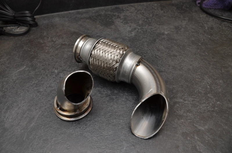

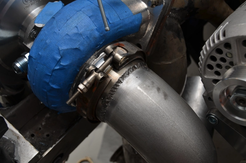

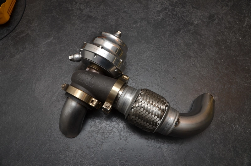

It's been tough to find time lately to work on the car, but I did manage to figure out the wastegate situation. I will say though, that it took me foooorrrrevvveeerrr to a) determine the best place to put the wastegate so it didn't interfere with anything and b) to actually cut the pipes accurately enough so I don't have huge gaps when it comes time to weld.
Part of the challenge for the wastegate placement was that I needed to position it so that I could fit a flex bellow between the discharge and the downpipe. I also wanted the discharge to connect to the downpipe in a configuration that would enable the exhaust from the wastegate to flow in the same direction as the exhaust from the turbine housing. I didn't want the wastegate discharge to have to "fight" the exhaust from the turbine in fear that it would affect its ability to control boost.

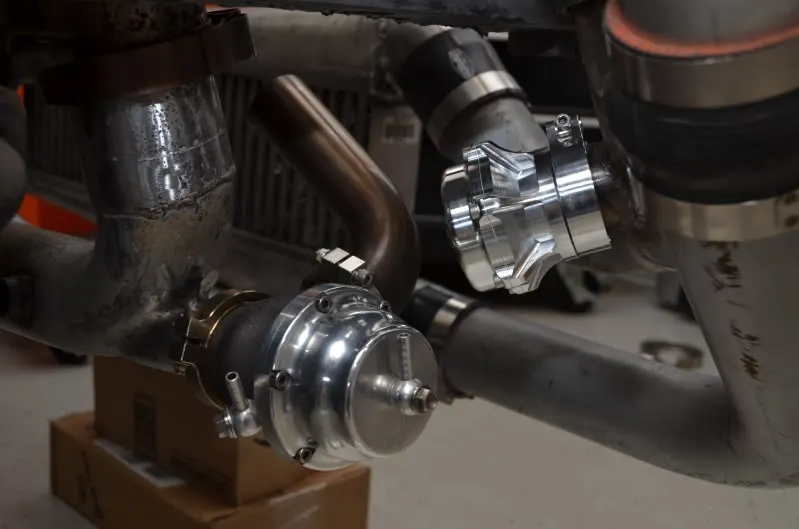

Here's the picture from the previous page again to show the clearance issue between the gate and the BOV

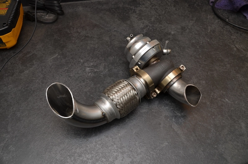

Here are the pipes that I labored over for hours (literally) to get them just the way I needed them to be:
Attached to the wastegate:

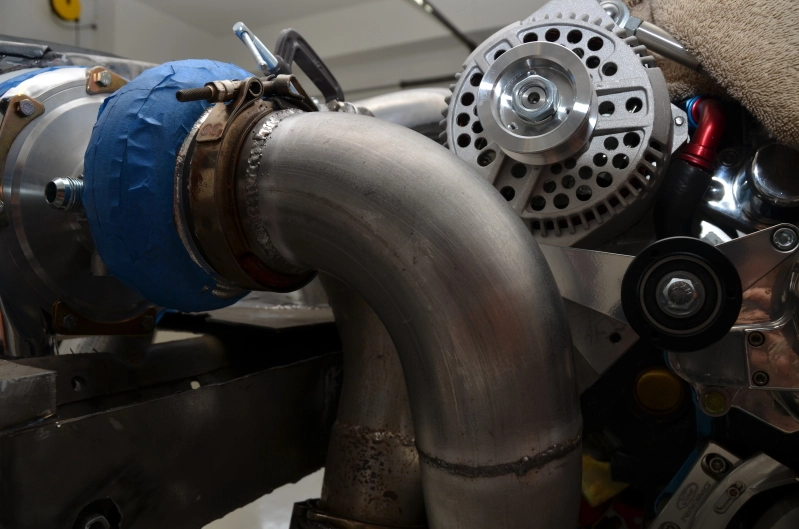

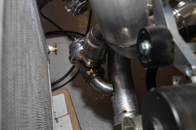

And tack welded in place:

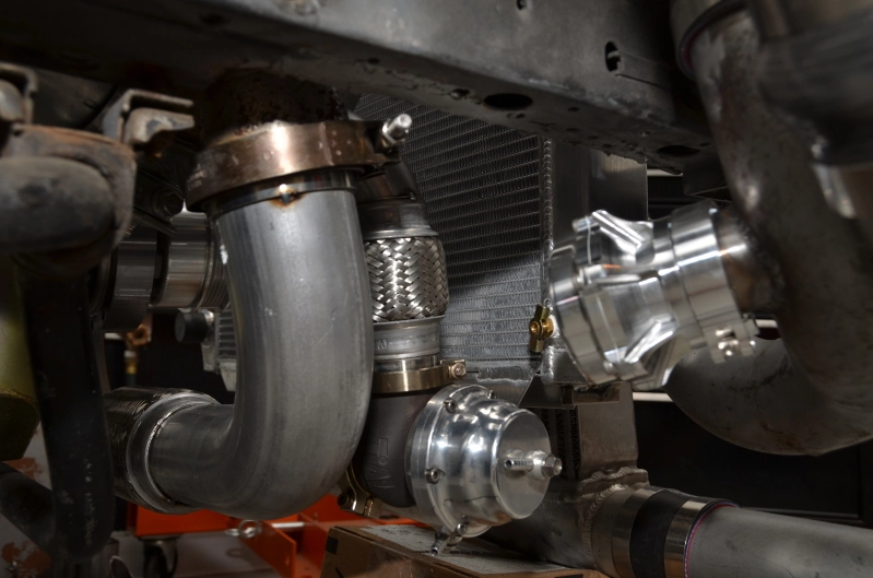

Good radiator clearance:

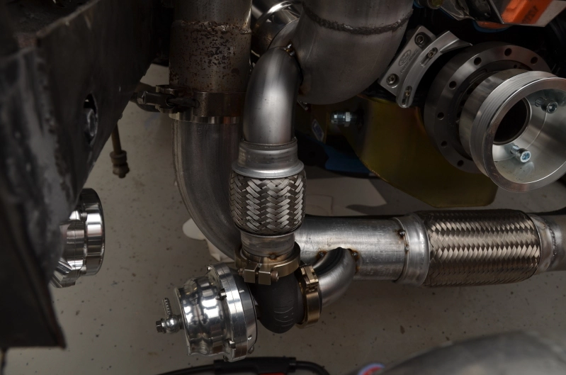

I should have some time tomorrow to finsh up all the final details of the turbo piping. I just need to weld hangers to the downpipe and y-pipe as well as weld up whatever pipes that are still tacked together. Then everything can FINALLY be sent to Jet-Hot.

It is a real challenge saying stuff today,....The board is pink, purple and blue, and keeps swinging back and forth.
Great looking work Scott. Glad you figured out your piping dilemma. Why did you have to wrack your brain on the solution? Looks like an "OH yeah, that'll work" to me.
Determining the actual position of the wastegate didn't take too long, but the execution of making it actually happen took some time for whatever reason. I think I was having an off day. It also didn't help that I was trying to use the leftover 1.75" piping from my header rebuild. I really needed another 90 degree bend piece, but instead of spending $30 to get one shipped to my house, I made one that I had laying around work.
