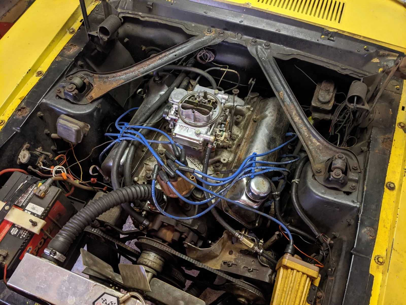

My dad left me a rust bucket full of sentimentality. The car's been rebuilt maybe twice in its life, originally the car had a 289, but early in its life someone put a 351c (4v) in it and swapped the trans for a C4. The motor had a really big blower carb on it that stuck up through the hood, and higher-end specs in the heads like "solid lifters" (not sure what that means). Then my dad bought it and rebuilt it with the intent to de-tune it for more comfort than performance, considering it broke loose whenever he left a red light hahaha. My mother drove this car daily for a period of time while pregnant with yours truly.

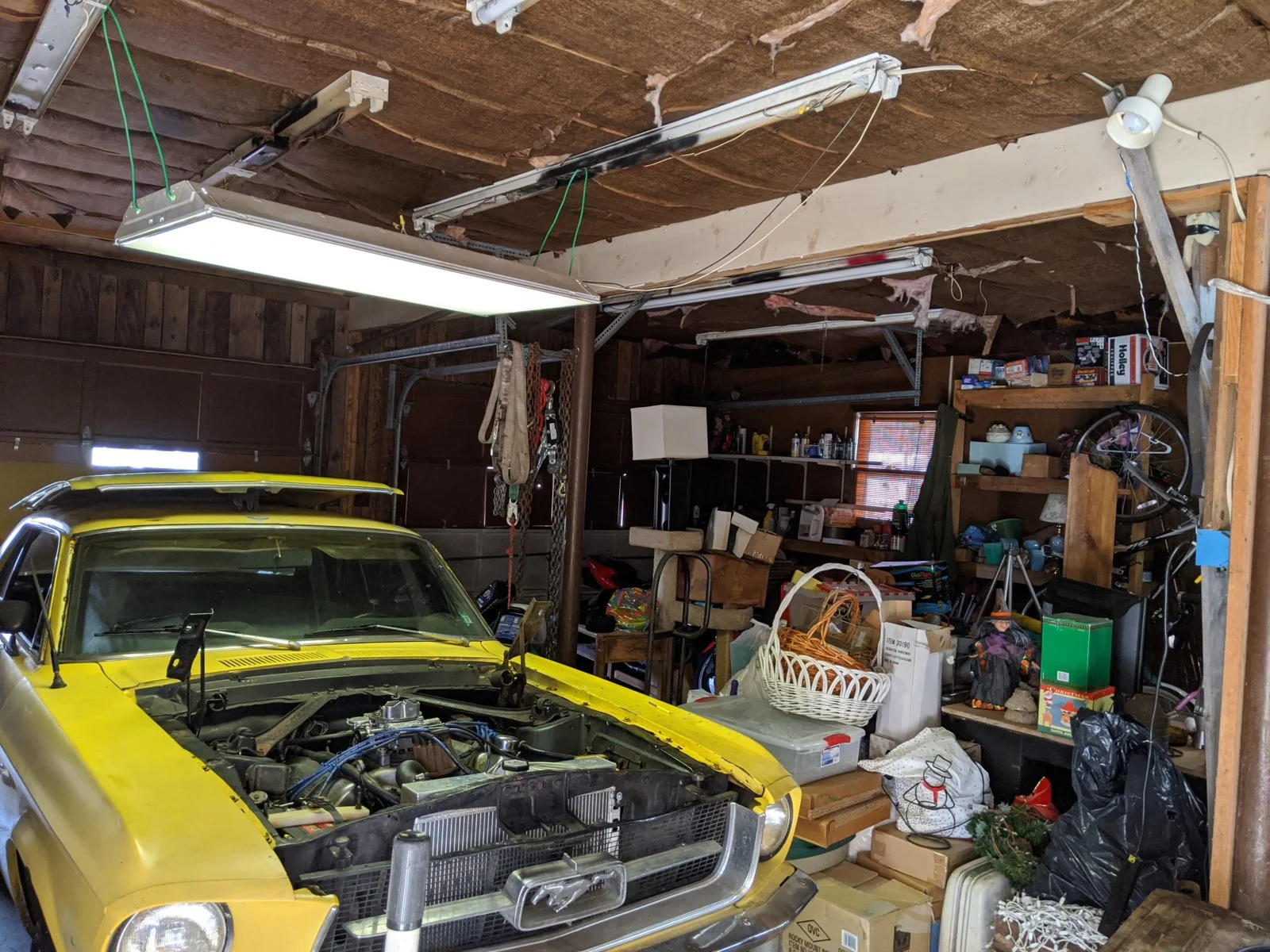

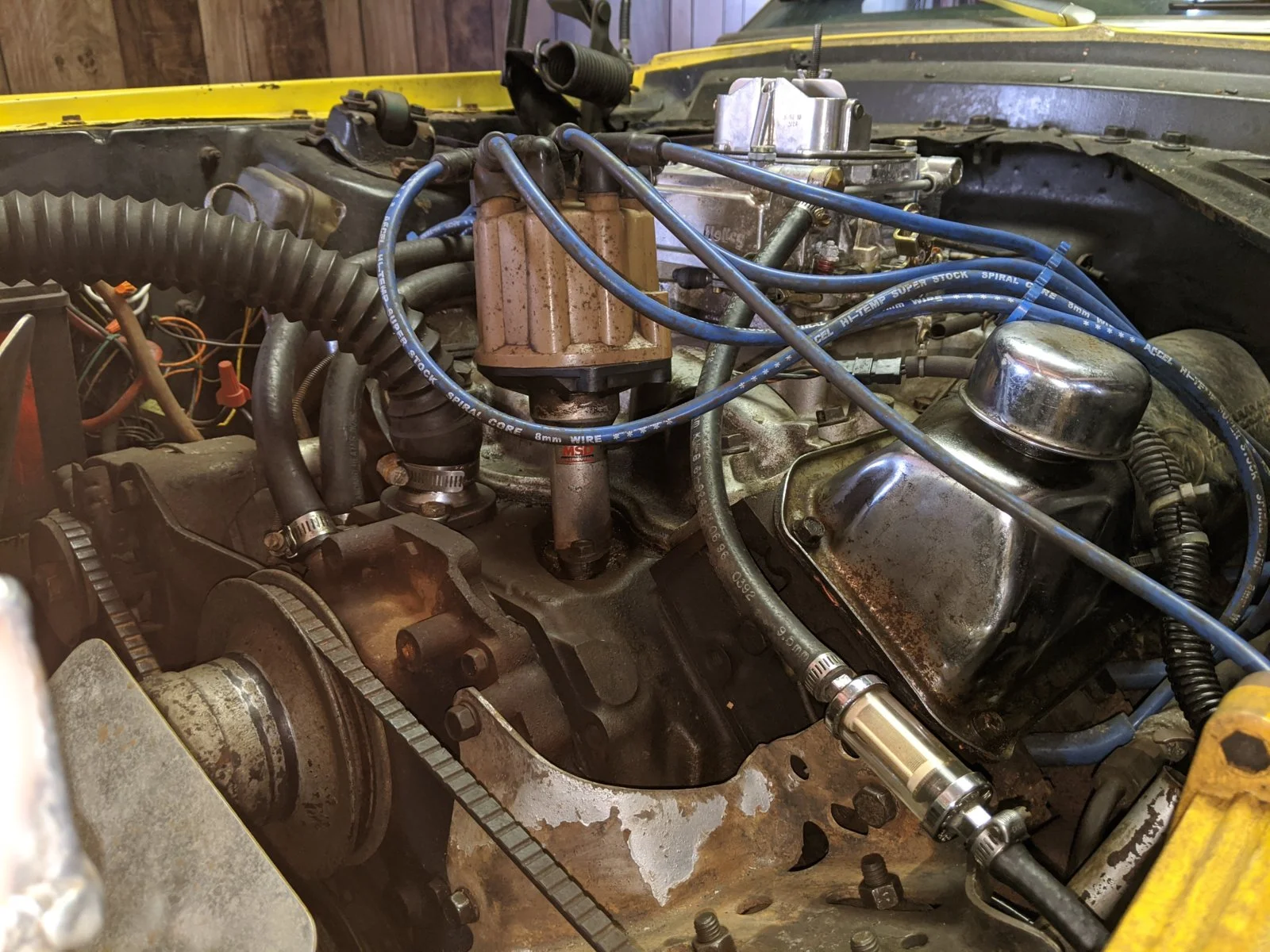

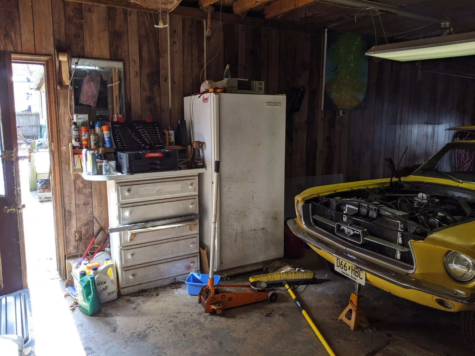

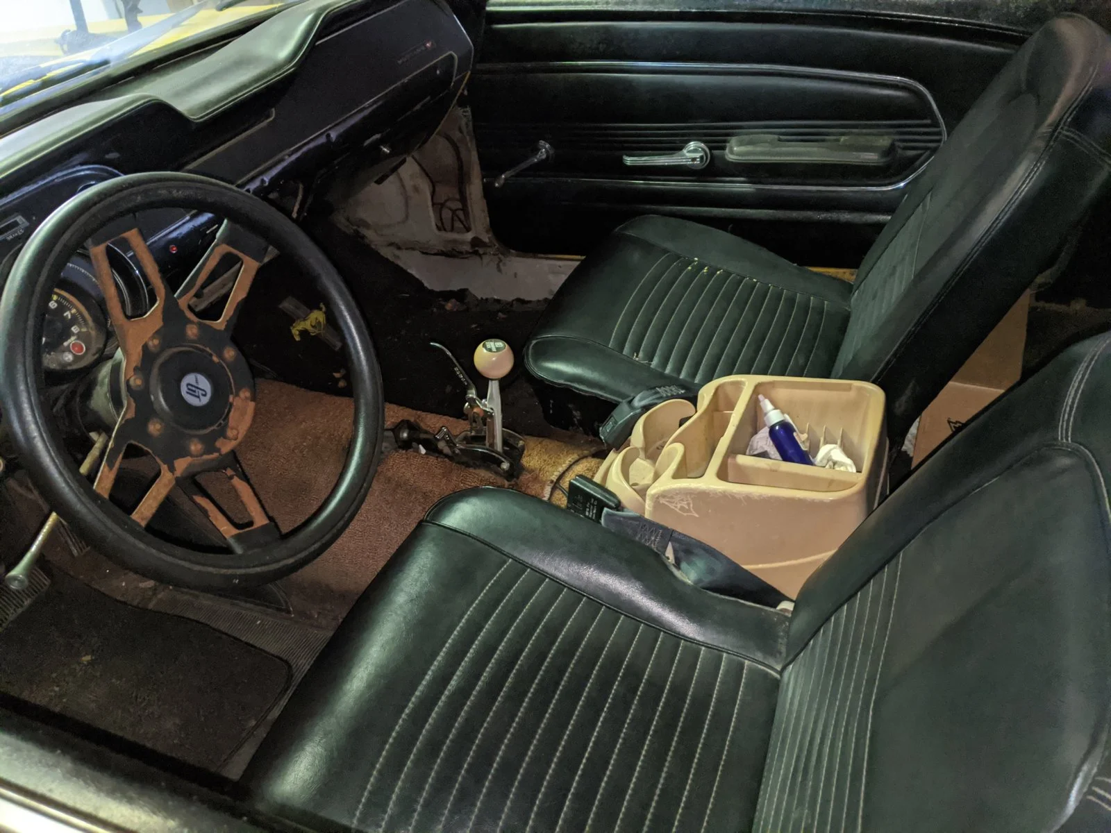

EDIT 1: Here's some of those pictures you guys might have wanted to see!!
when it comes down to it, I stare at this car for however long and never just "get it" the way some other people can.

I took off the power steering pump and looked around under the car to see what it was connected too and then examined that whole power steering assembly portion in the front.
lots of leaks, covered in grease and road grime and dirt and dust. id love to replace those hydraulics down there and then get an alignment once I got the engine running again.
I also replaced the gas tank because it was really gross inside and rusty and the float was basically a solid piece of rust.
I followed some of the fuel rails along the frame to check for leaks by pressurizing the line from the engine side into the tank and the lines seemed intact for the most part. this was important because well, it needs fuel first and foremost.

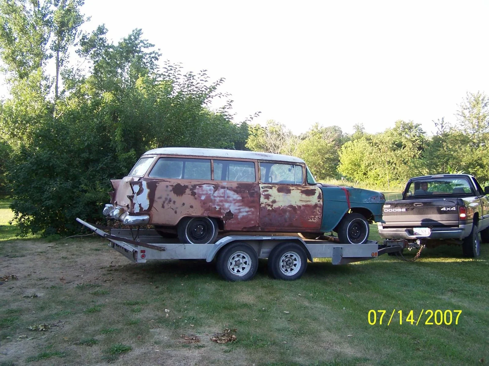

I'm sorry for the loss of your dad, it stings no matter how long it's been. I lost my dad when I was 11. I grew up working on his 55 Chevy with him, that's where I got my bug. He left the Chevy to me, so I can relate to inheriting a rust bucket! :D Here's me with his buddy's 55 - the one that was left to me is the one in the background.

Clueless67 If you can change brakes and work on lawn mowers I believe you can get that car running. Those early Mustangs are some of the simplest cars ever made in my opinion. You have already realized you needed a new gas tank. The carb may need cleaning and new seals too and the fuel line may need flushing out or replacing. Other than that, if I were in your shoes I'd pull the plugs, ( one at a time so you don't mix the plug wires up ) squirt some oil in the cylinders, change the crank case oil and filter, put some fresh gas to it and see if it will run. There are videos all over youtube of people cold starting engines like yours that haven't run in years and some of them are by people your age. Check out a few of those. I can post some links if you want some. Some of the best money you can spend at this moment is on a genuine Ford ( they make reprints ) shop manual for the 67 Mustang. Don't get the generic manuals that you might see for sale at bookstores. The genuine Ford one tells a lot more and gives a lot more detail. Better pictures too lol. I like your project. Keep us posted.
