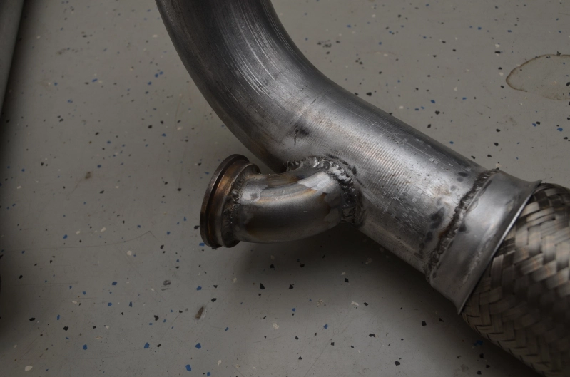

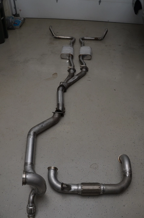

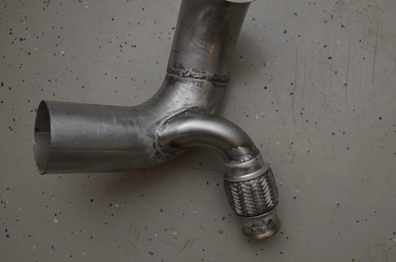

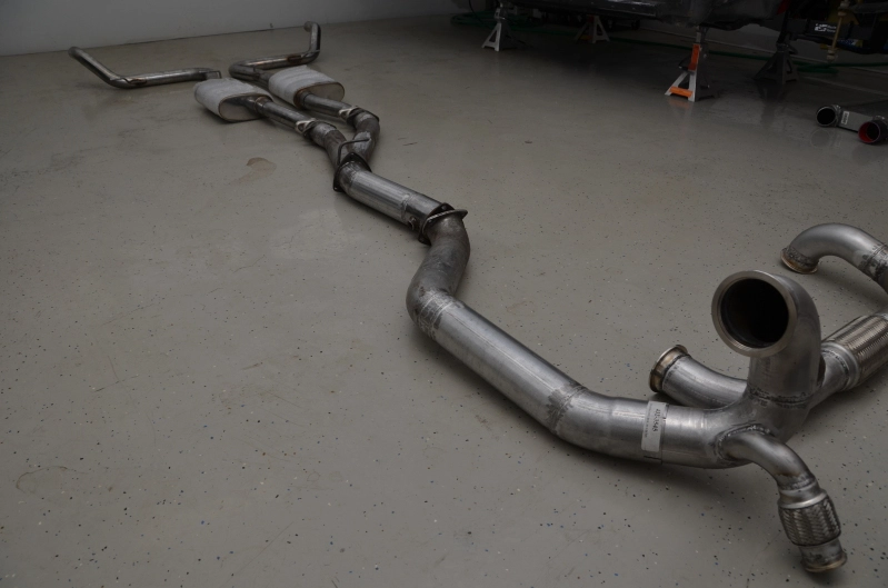

Finished up the welds on the rest of the exhaust piping:

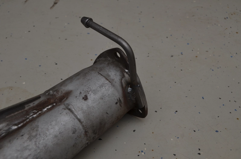

Bent an exhaust hanger and welded it to the y-pipe:
This is the only hanger between where the downpipe mounts to the turbo and the tailpipes right behind the mufflers. I had everything tightened down and it seemed solid, but if I need another hanger down the road, I can just get one of those deals that strap around the exhaust pipe.

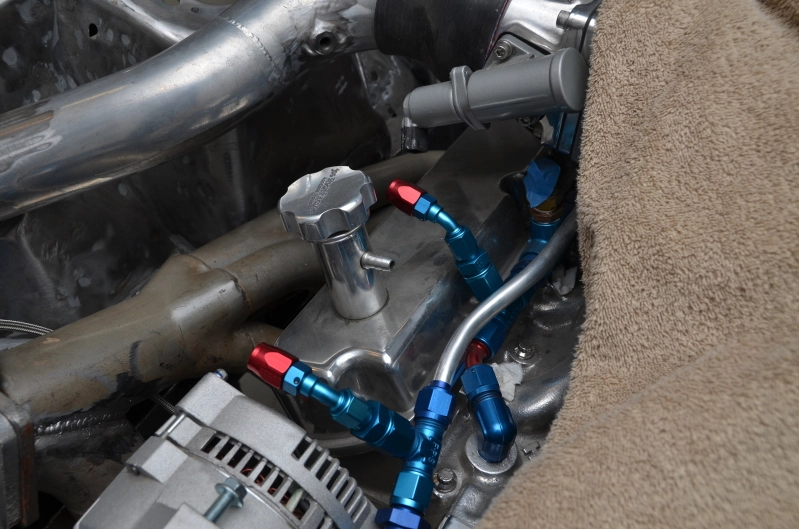

I also bought some AN adapters so I could tap my heater lines for the water feed to the turbo:

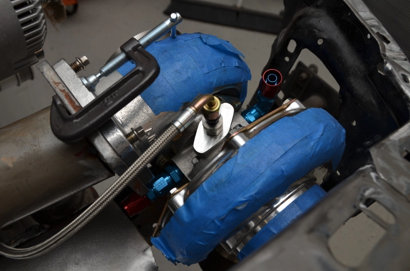

Because of the location of the flange and the way the turbo sits, I had to clock it slightly so one water line would clear the flange. It's only clocked about 10 degrees. The general rule of thumb seems to be not to clock it any more than 20 degrees, so I should still have adquate oil drainage.
I just need to weld up the turbo mounting flange on the passenger header and then I'm going to drop off all the piping at the local powder coating shop so they can sandblast everything. I want to make sure the imperfections in the pipes are all gone (or at least visible so I can fix them) before I send it away for ceramic coating.
