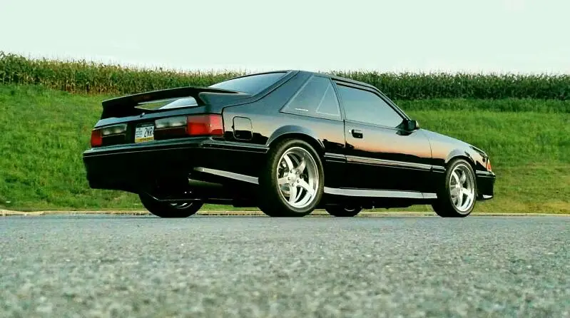

I got a pretty decent picture of the car last night while the photographer was doing his thing. It's impressive what a cell phone can do when you have a clean background and some nice, natural light.
I just we'll oh man it happened again I need a change of undies that thing is like sex on wheels !

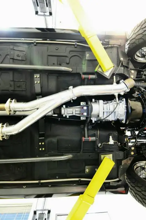

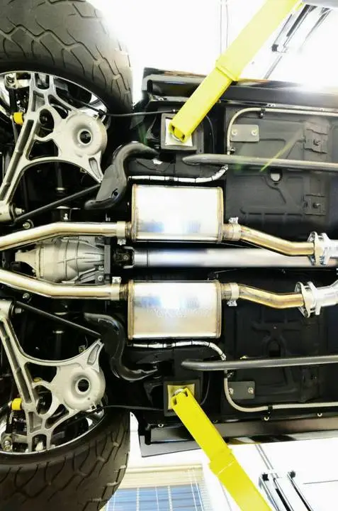

The fuel lines are near the mufflers. I have them wrapped in a aluminum sleeve, but I may need insulation and a heat shield in that area.

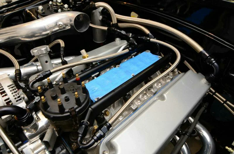

Here are some pictures of my current fuel line routing.
The feed comes from the driver side wheel well, under the brake booster into a Y and then along the firewall into the back of the rails. The returns come out the front of the rails, loop to the firewall into a Y and then across the passenger valve cover to the regulator behind the strut tower into the passenger wheel well.

Not sure if serious... What aside from circulation, would be heating the fuel? Of course it's the pump. We see something along these lines what... once a year at least.
All that fuel is being pumped through the rails and returned to the tank. Over and over and over and over.... What's the flow rate on that pump? How much of that fuel are you actually using at idle and cruise? Heat soaking the whole time?
I wonder if this was the same problem we encountered on the dyno originally?
With quite a reserve of fuel left in the tank it is not likely that the fuel got so hot that the pump was heat soaked by the fuel, insulation issue for the fuel lines or not. I've seen plenty of fuel systems installed laying on hot components under the hood and throughout the car without issue. I have seen on plenty of occasions fuel pumps over heating and having issues. When a fuel pump is dead headed (low or no fuel usage) there is no fuel to cool the pump, I run into situations like this all the time with building hvac systems and especially split case pumps ( @MikeH686 knows what I'm talking about there). What size return line is on the pump and just how much fuel is it designed to flow? I've had to install on many cases a return line equal if not bigger than the supply line to remedy similar problems. Up until last year we were using a step down controller on my big Weldon pump to keep it from overheating while street driving. It basically pulses the ground signal to slow the pump speed and reduce heat created while large amounts of cool fuel are not present.
