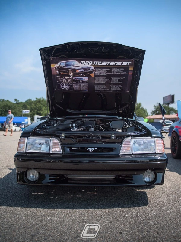

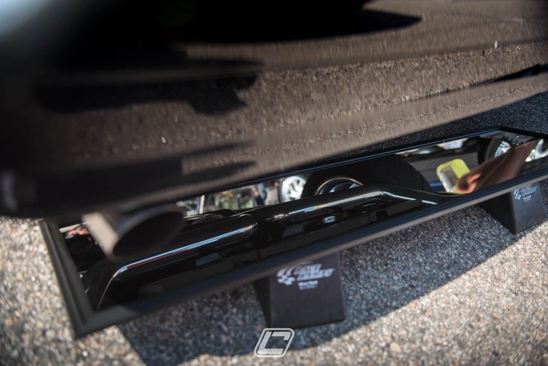

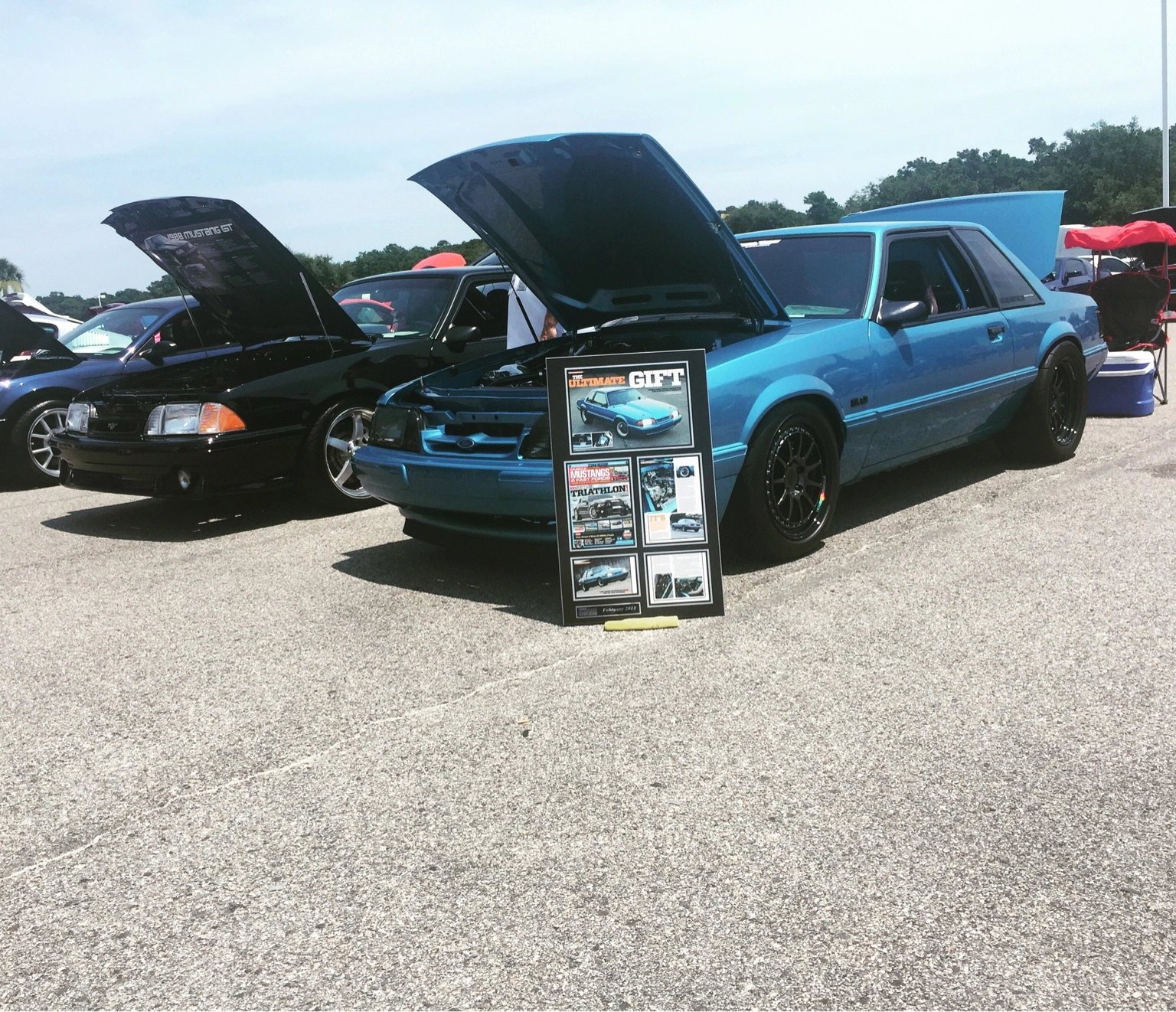

can you post a picture of your "show board" or whatever its called? i think whats missing from your car at the show is how clean your car is underneath. A couple jack stands and mirrors on the ground would get you that little extra push to get to the top.
Congrats!
I'm not a huge fan of the cars sitting on the race ramps or jackstands at shows. They always look 'off' to me. Even though they are at proper ride height, being a foot in the air just doesn't look normal to me.
I did actually have a mirror under the back of the car as well as a photo album sitting in the hatch that has over 500 pictures detailing the build.
That $6 Wal-Mart mirror and wheel chucks got the job done!
From my recollection of that show they don't allow you the typical "props" that complete a car that's being shown. No jackstands, no mirrors, no signage.
You have to consider that in a sea of worthy competitors, all w/o the benefit of any special widgets detailing the special "behind the scenes" build mods,....the car itself was the only way a judge could come to a decision.

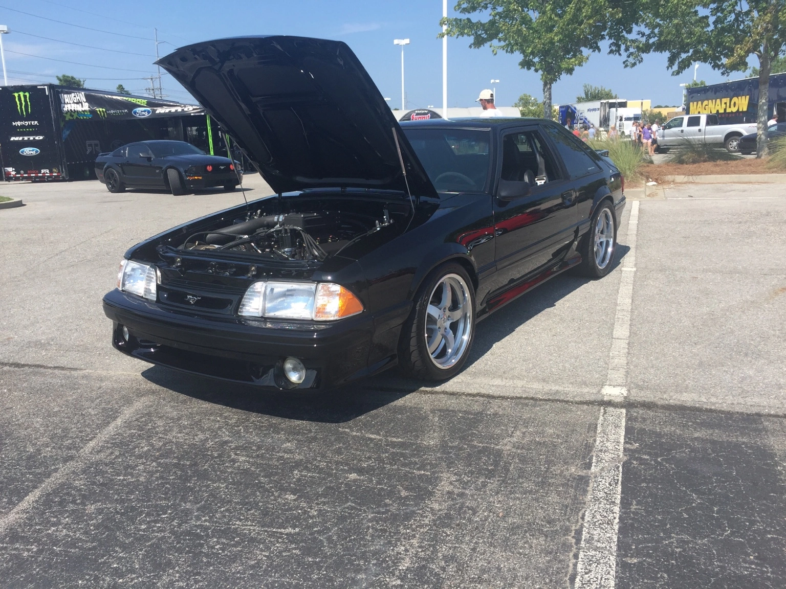

I'll be the first to admit , Scott's car and Marios blue coupe are a step above my car . I said it to Scott while we were there I went down not expecting to win a thing . It's a street car that I enjoy the hell out of . It has its beauty marks etc . The car was in the Vortech booth Saturday though which was awesome in it self . I saw Brian from Vortech Friday and he remembered me right away from when he had me in the booth at the AM show . We chatted quick and I kept it moving . He reached out to kris that night to get in touch with me about using the car for the booth Saturday . Of course I accepted ! First time at MW and I get asked for my little old streeter to be in the booth ? Hell yes . That in itself topped off my week .
Either way it was still a blast every bit of it . Congrats again Scott I can't tell you enough how happy I was to see you win the awards . Your car is nothing short of perfection !

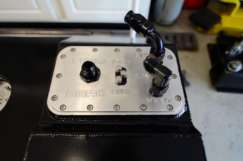

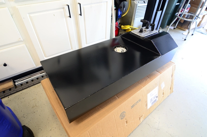

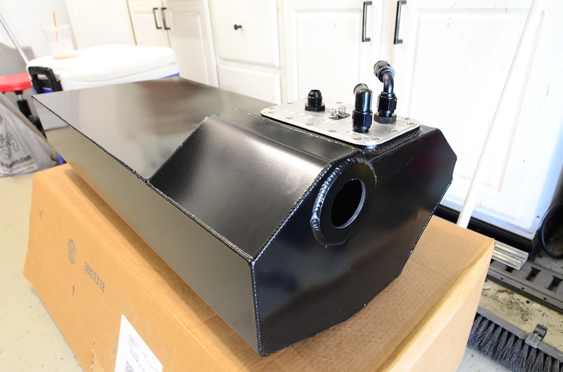

So in true turbo car fashion, the car was back under the knife immediately following Mustang Week.

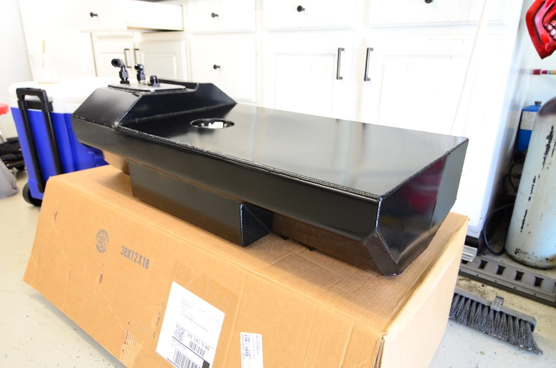

The only problem I have been having with the car is the fuel pump setup. There are some flaws in the way I have everything setup. I learned that the Fuelab pump can be a little sensitive to it's location as well as the tank design. For those that aren't familiar with my setup, the fuel pressure regulator acts at the fuel controller. It measures the return fuel flow and adjusts the voltage to the pump based on that return flow. Less return means the engine is using more fuel, so voltage to the pump is increasing. The design of the return in the tank is apparently very important to the function of the system. My BBRC tank is an older generation and just has a splash return where the fuel is dumped into the tank from the top. The Fuelab regulator doesn't like this. The splash return causes air bubbles in the fuel, which the pump sucks up and cavitates slightly in the process. The regulator sees that cavitation and gets confused because the pump is speeding up, so it trys to slow it down. This creates an oscillating fuel pressure.
The up and down in pump speed and cavitation is creating excess pump heat, making the pump angry. Couple that with 95 degree weather and it can create full blown vapor lock sometimes.

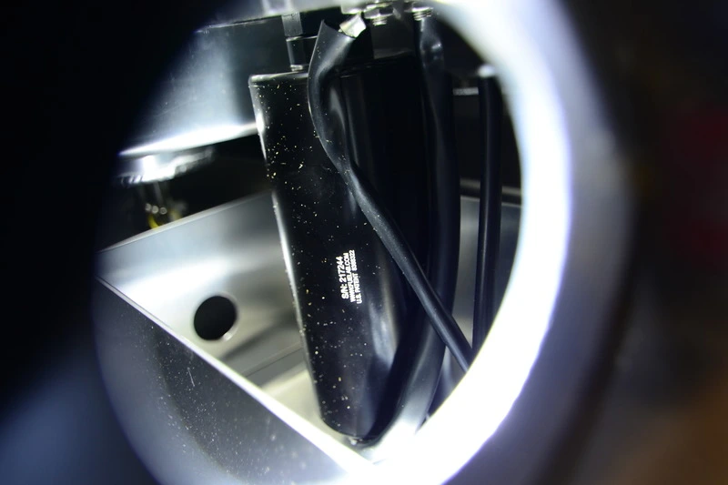

So, whats the solution? I could fab up a dip tube for the return so the return fuel enters below the level of the fuel in the tank. There is a second issue though. My pump is mounted too high. When the fuel level gets below half tank, and I do hard braking or cornering, the pump starves. Thanks to the IRS, I'm limited where I can put the pump at a low level.
Here's my solution. BBRC tank 2.0...
It's an 18 gallon tank with the pump mounted internally. Same exact pump I have now, but just inside the tank and 4 more gallons of capacity. The baffle design and return setup are much improved, so the pump should stay very happy in here. I tend to hear that in-tank setups are more reliable on the street compared to their external counterparts. If this doesn't fix my issue, then I know the fuel is getting too hot from the engine and I'll slap on a fuel cooler and call it a day.
I will be selling my old setup (minus the post-pump filter, I still need that) after I install that dip tube I was talking about and after I have Fuelab make sure my pump is in good working order. I don't want to sell something that could have been potentially damaged from the cavitation that was going on in there.
I've already got the tank mocked up. I'm cutting a hole in the floor and installing a door so I can get to the fuel hat easily for maintenance. More pictures to follow...
