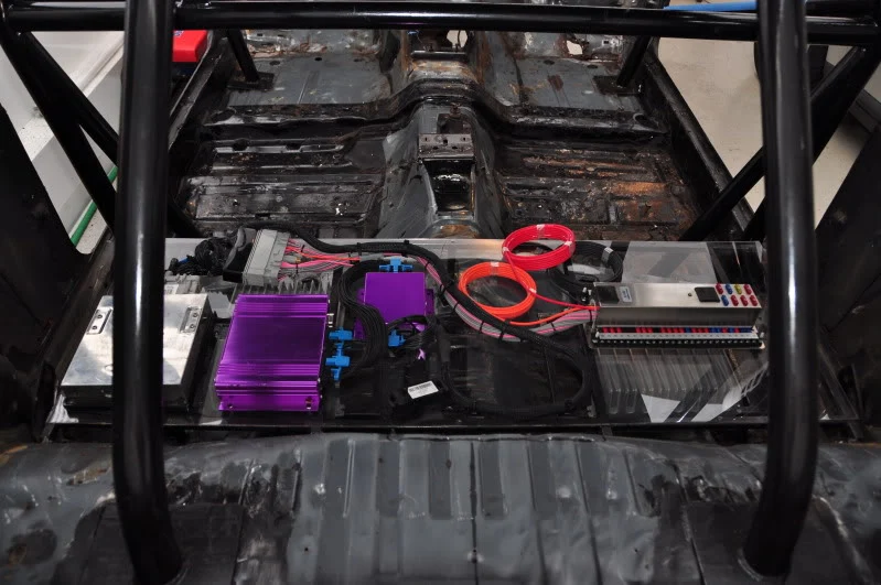

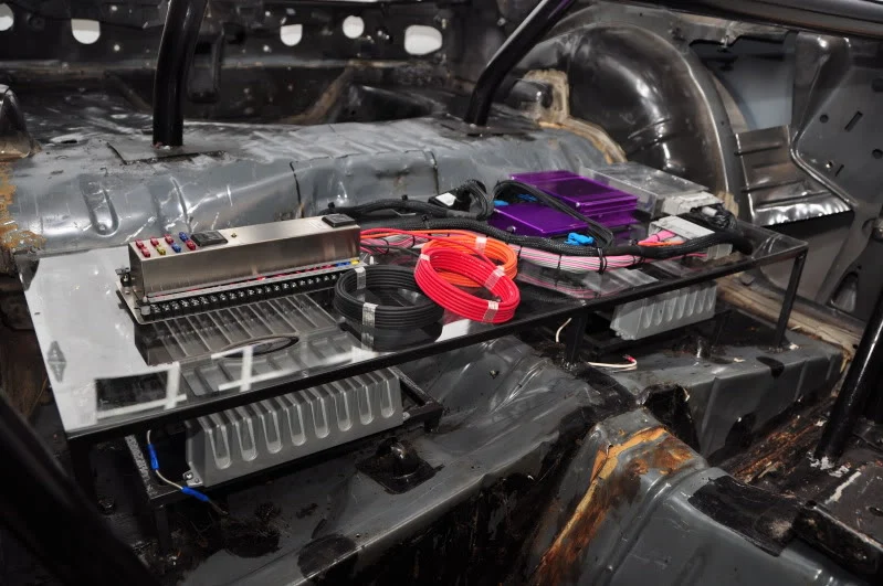

So here is what the setup will look like for all the electronics. The large fused terminal block will be where all the sensors for the engine get connected. I'll be welding together a false floor frame that MDF and carpeting will eventually attach to. The frame will hinge after the roll bar mounts and I'll install some small gas struts so I can easily access the all of the components on the rack.

Maybe instead of plexi on the rack, you could have some black diamond plate made to size and laser cut? Might look cool and not too "pimp my ride." If you're going for the pimp my ride look, I'd add a fish tank to the center console and a headliner of corinthian leather, that's too many awesome homes.
The rack installation is a product of functionality and not looks. I used plexiglass because it makes it easier to look through down to the amplifier connections if I ever need to adjust or change anything down there. The entire rack assembly will be out of sight and enclosed in what will essentially be a rear seat delete. The top will hinge so I can get inside if need be. If people were acutally going to see all that electronic crap, I'd pretty it up a bit more, but they won't see any of it. Think of it as a car dashboard, take the dash off and it looks funny. Well, I haven't built the dash yet :)

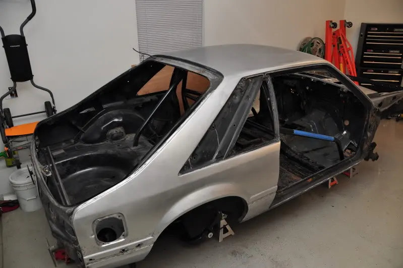

Stripped her naked this weekend.
Found some filler in spots I didn't expect. The car must have been hit in the driver side rear quarter at some point in its life. It's not bad at all, just obvious that repairs were made.
I also cut out the rusted areas of the car. Luckily there aren't many. I knew the framerail was bad when one of the stock k-member bolts looked like it was being chewed on by a rabbit for 2 decades. I'm going to have to weld in some sectons of pipe to replace the original reinforcements.

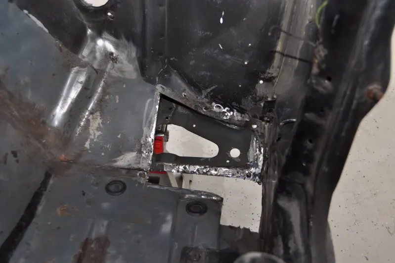

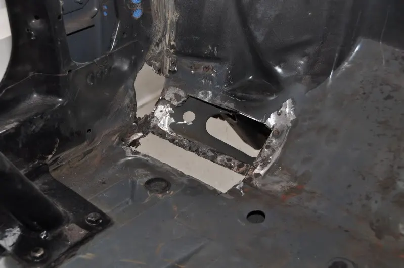

The footwells were bad enough to make me cut out some of the floorpan.
So, a question for the sheet metal pros. What's the best way to repair these footwell areas? I have some 16ga sheet metal that I can use. Can I just weld in some pieces to close up the areas I cut? Ford had some reinforcement pieces spot welded on. They were too rusted to save. Do I need to reinforce any of this area, or will welding in the sheet metal work fine?

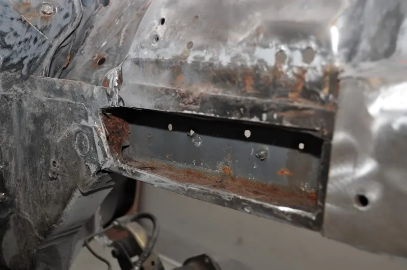

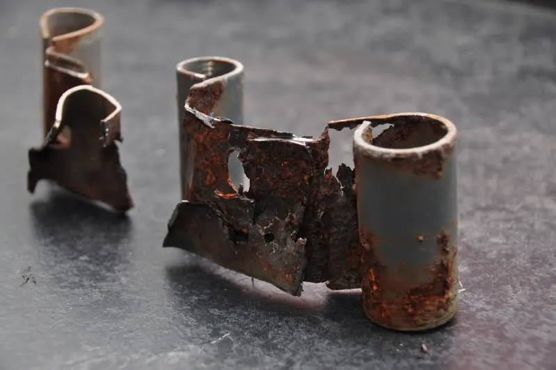

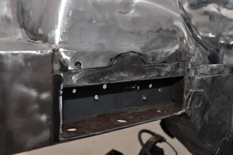

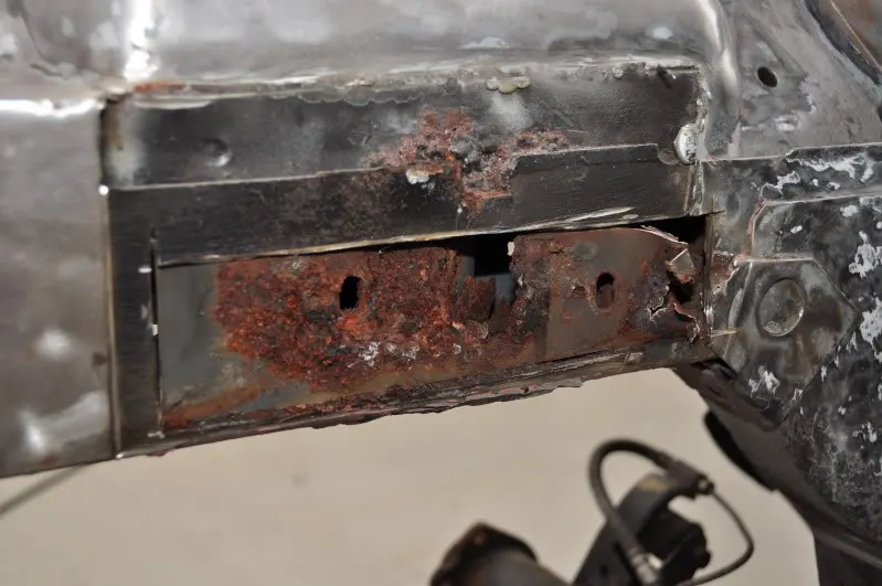

I'm glad I decided to cut open the passenger side framerail. Surprise surprise:
The supports were on their way out. Not as bad as the driver side though.
Cleaned it all up. Just have to order some tubing and metal plate to button it all back together.
I don't know how you guys with rust buckets do it. I don't have much rust at all on this car and I'm already sick of dealing with it!

You got it. The k member bolts go straight through the bottom of the framerail to the nuts mounted in base of the shock tower area.

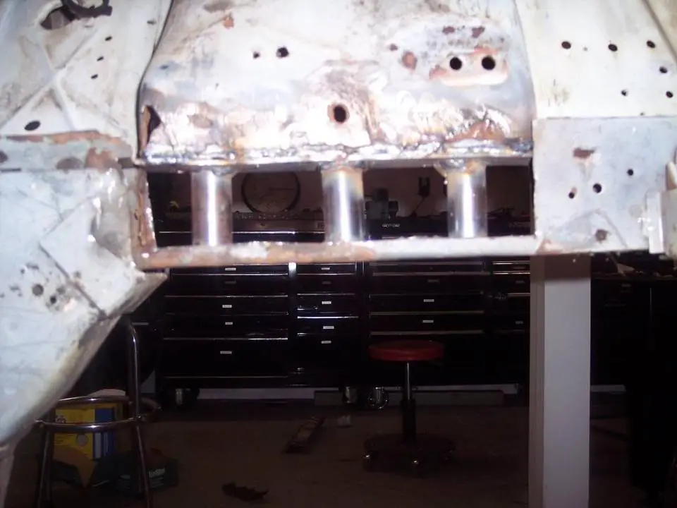

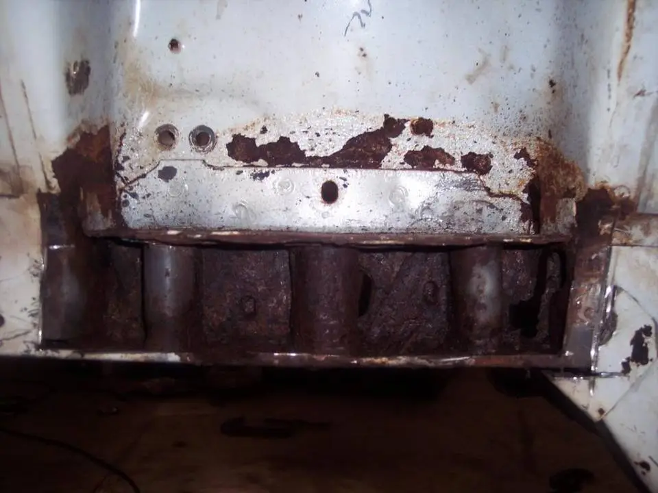

Here's a picture of from trbofox's thread when he did his car. Shows the supports in the framerail.
Before:
After:
I'll be doing something very similar. Luckily I didn't have to cut out nearly as much as of the framerail as he had to.
