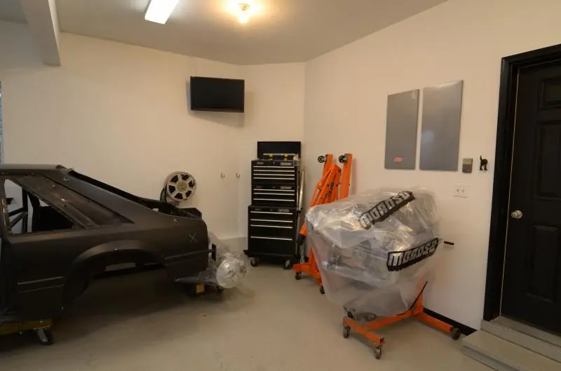

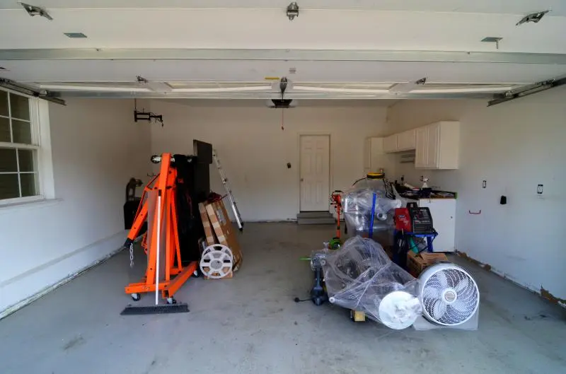

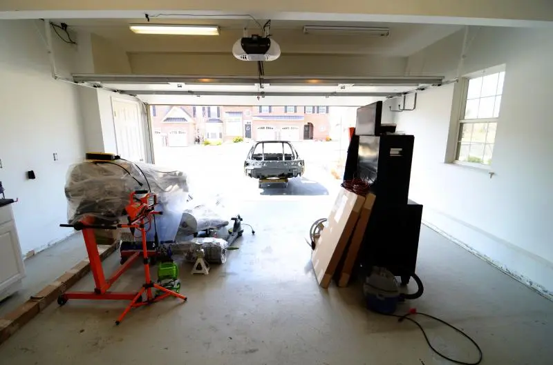

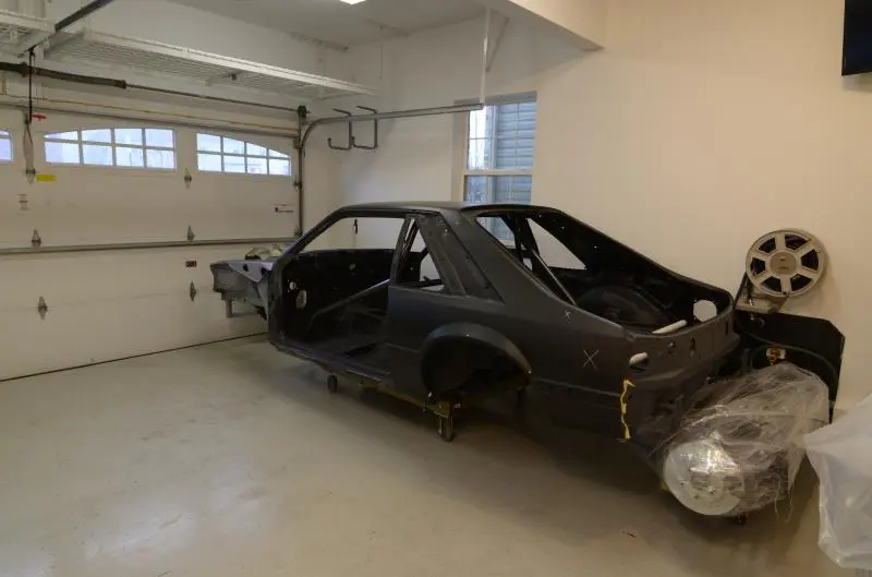

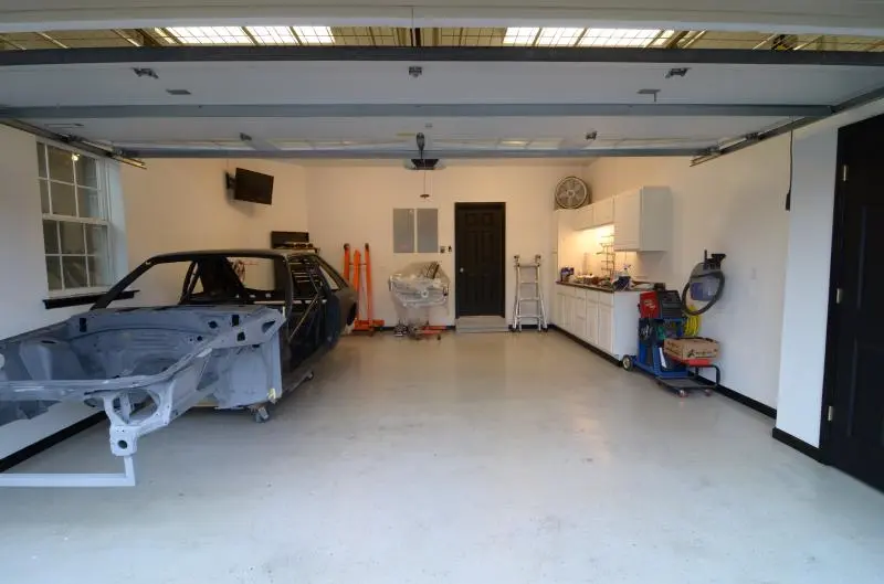

Well, because I apparently like to dress up like a pretty girl now o_O ... I had to dress up my garage like one too. Cleaned, wiped, and painted everything. Looks much better now.

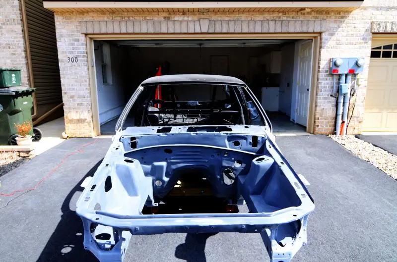

I was able to safely roll the car outside to get it out of the way.
All pretty now...

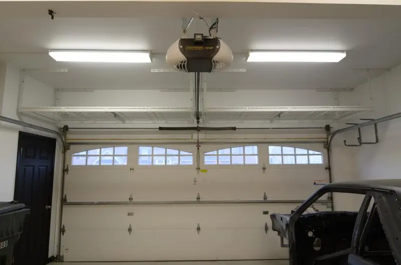

I also installed two 3x8' racks above the garage door. They will mostly hold wheels/tires plus some storage bins.

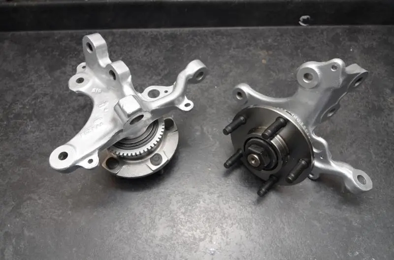

Used what I had leftover of the G2 caliper paint to do the spindles. Came out pretty nice. I was originally going to have them powder coated gloss black, but I needed to use up what was left of that paint so silver it is! Color doesn't matter anyway. You can't see them behind those 13" Cobra rotors :)

What's so special about this G2 caliper paint? - I have to paint my calipers and spindles one day soon - is it a heat issue? can't you just use an epoxy paint of some kind? Just wondering.......
Reactions: RacEoHolic330
Hey Scott -Your work .....as usual is outstanding :nice: .....this car better be in 5.o magazine when it's completed -
I'm sorry... The G2 caliper paint is G14 classified. :ninja:
Reactions: JustinL
Depsite the top secret classification (G18, actually), I can tell you this: The G2 paint is a two-part system (paint + reactor) and it has a 980* rating. It's super durable from what I can tell and has a nice, glossy finish to it when it dries. It's not as cheap as a can of hi-temp caliper paint, but the little can it comes in goes a VERY long way. Takes 3-4 coats to completely cover whatever you're painting. A can will easily coat 4 calipers and brackets with some left over. I got mine on Amazon. If you get it, ditch the brush it comes with and use something better. That was the only bad part of the kit. I would say their paint is the next best thing to completely tearing down the calipers and having them powder coated.
