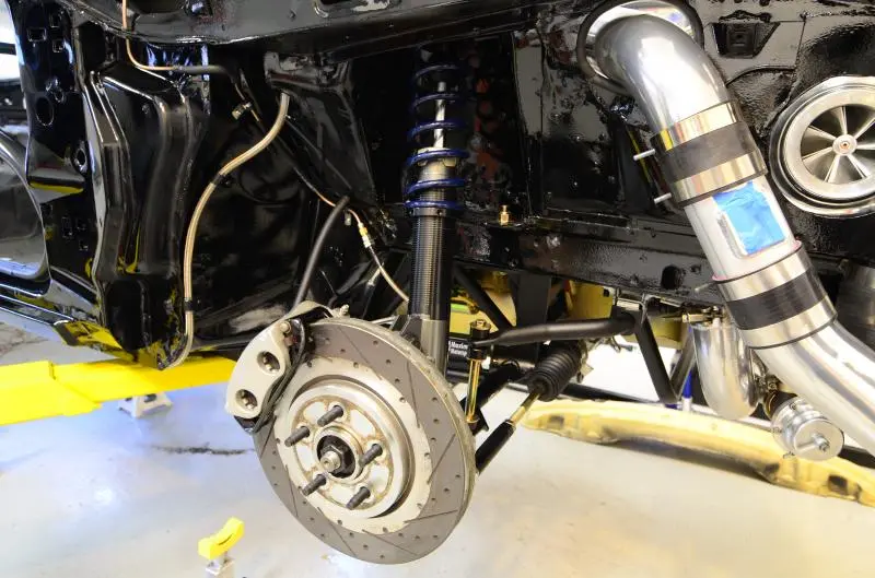

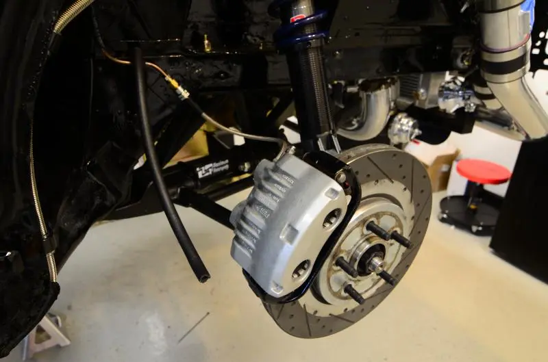

Front suspension and brakes are all installed. The car officially has rotors on all 4 corners now . I still need to get a set of brackets to mount the soft lines to the chassis. I seemed to have misplaced my original ones.

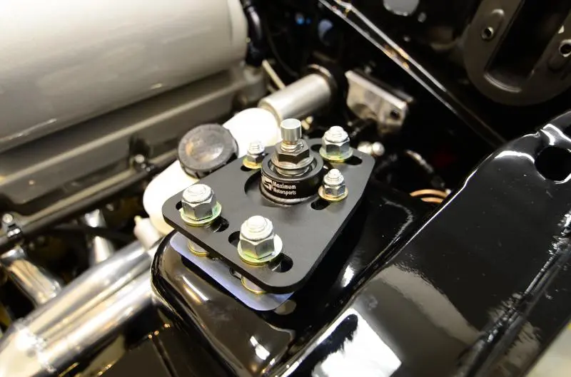

MM C/C plates. Thanks to Rick for the idea to use slick tape under the mounts to protect the paint and make adjusting easier.

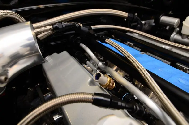

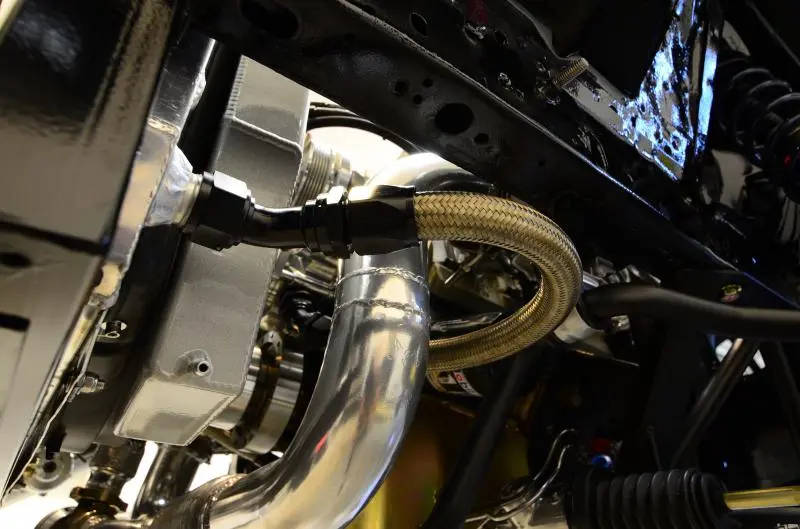

Lower coolant hose is installed. It fit perfectly between the crossover and the sway bar.

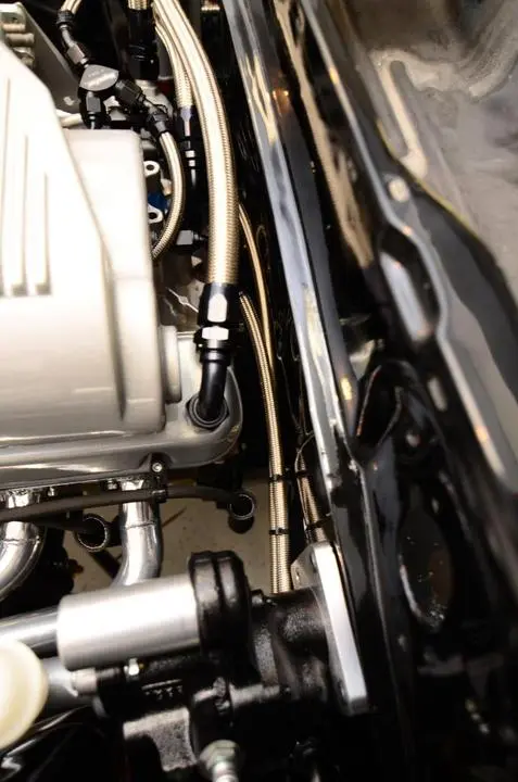

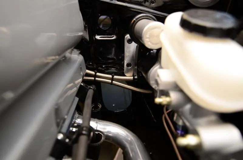

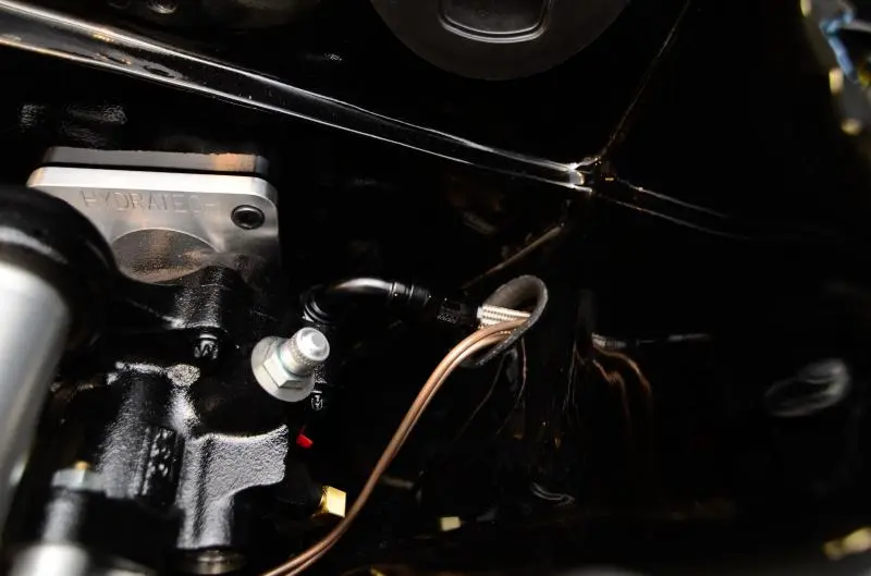

I also finished all of the fuel system plumbing as well as the AN heater hoses. Here is were the -10AN feed comes out of the driver side fender area.
Under the brake booster is a y-block that splits the -10 feed into two -8 lines. The zip ties are temporary. I'll get some fancy separators eventually. The lines will just clear the steering shaft when it's installed.

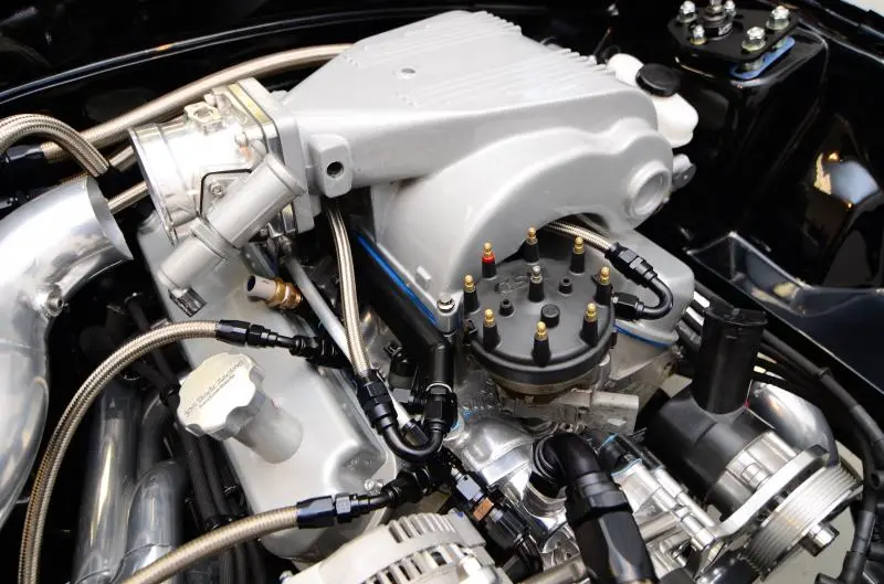

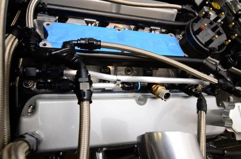

Each of the lines then go into the back of their respective rails.

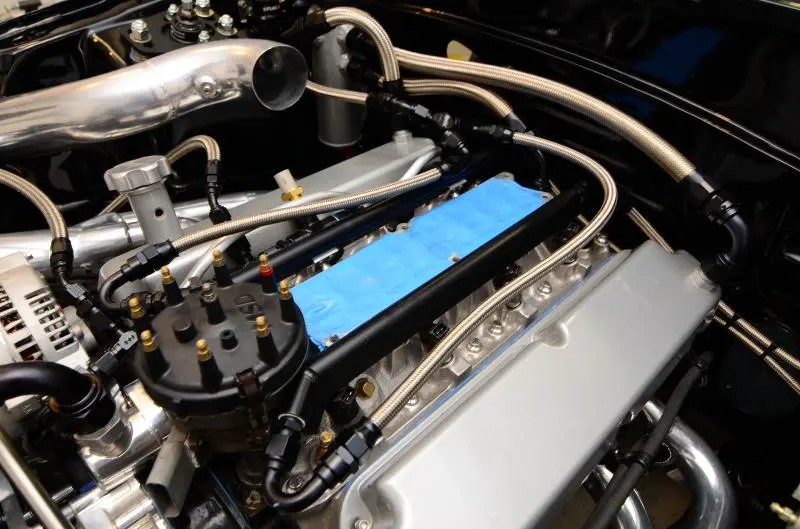

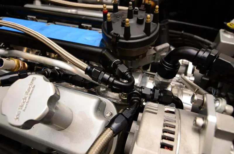

The return lines loop back around to the back. This was in an effort to not have lines strung all over the engine bay. It's a mess of AN lines in the back, but they are somewhat limited to only that area. You can also notice the AN heater lines. Those were a real PITA to make and get lined up so nothing is rubbing.

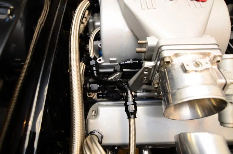

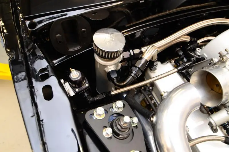

Both return lines then come into another y-block with a -8 outlet into the regulator. I need to fabricate some kind of bracket to bold the y-block to the throttle body. It's just hanging there right now.

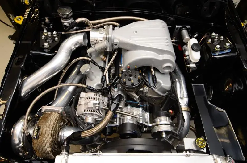

And that's how she sits right now.
Madspeed, nothing wrong with plugging the PCV port on the lower. I wanted to utilize it because that is the best place to vent the crankcase. The lower intake port will do most of the venting, and the valve covers can take up the slack. Most just don't want to go through the hassle of having a bung welded to the lower intake. My setup is a bit of overkill. Two valve cover vents would probably still have gotten the job done fine.
Dave, that is a stock distributor. It's dirty as sin right now, but it will clean up. IMO, nothing beats a stock dizzy and TFI module.
