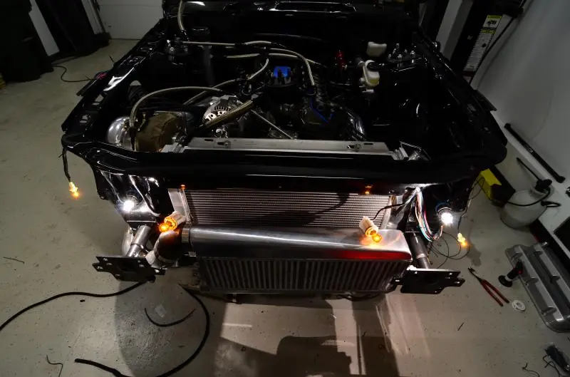

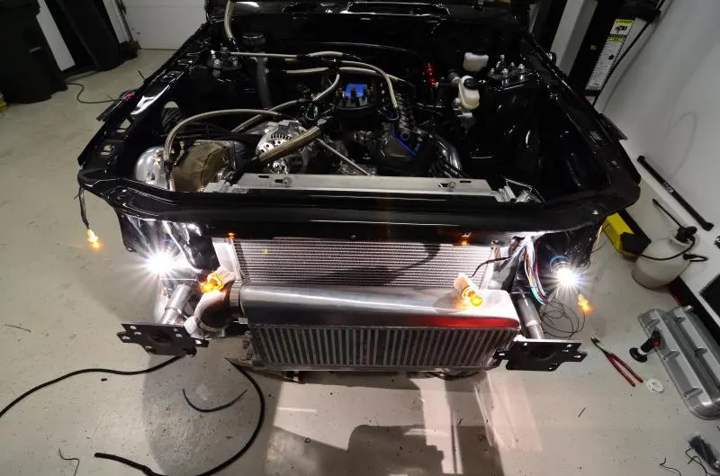

Here are the pictures from the lighting progress.
Got the switch wired in. No fog lights yet.

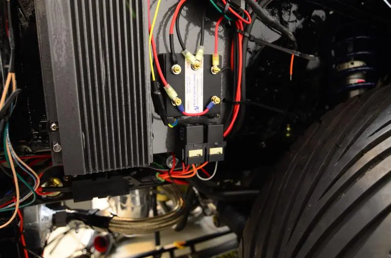

The RJM headlight relays. One for high beam, and one for low beam.

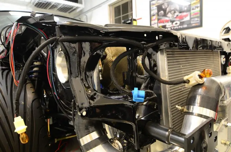

Passenger side all loomed up and pretty.

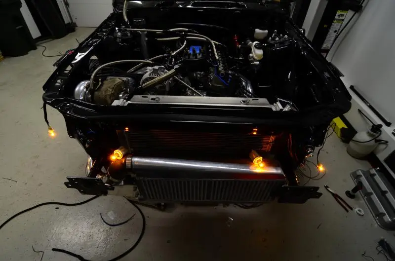

Parking lights.
Low beams.
High beams.
All that light and nothing started on fire. I'd call that a success. Next up will be the tails.

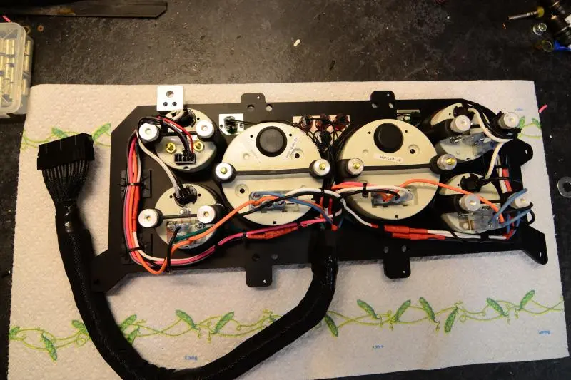

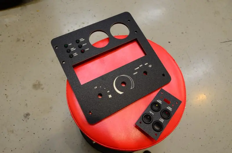

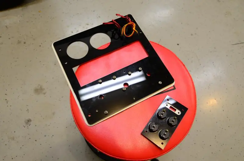

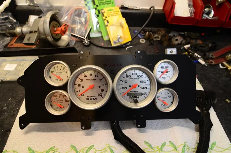

I built this gauge setup a good 2 years ago when I was preparing to revamp the electrical system on the car. I recently swapped out an oil pressure gauge for a fuel pressure gauge, so I had to make a few changes. It's all done now. The plate is made by MC Machine. I had to search high and low for the 24 pin connector. A quick disconnect was a must. No way would I want to pull apart 20 wires to take the dash out. The other end of the connector is partially wired into the dash harness. I have all the wires labeled on that end.

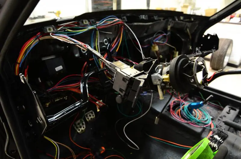

Got some of the wiring done on the turn signal stalk. I recently decided I will not be running wipers. That will eliminate a good bit of wiring. I can always add the circuit in later if I want to. Oh, the horn works. Woohoo.

You might consider a Greddy or Innovate analog AFR gauge to go with the others. Would be a shame (to me anyway) to ruin all that work with a digital gauge in the cockpit.
I like that idea. I'm going to roll with it. I assume they silk screen the lettering on, so maybe they can just cut the A/C writing away. Glad you like your PLX gauges. I had their older wideband years ago and it got the job done.

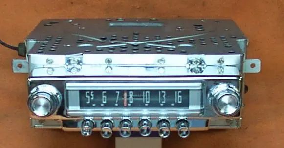

No radios with digital read-outs, huh? Is this the head unit you have in your car? :eek:
Mine is similar looking to that. It does have provisions for an I-POD or other player though. It's a modern rendition of an old radio.
When do start looking for a receiver, I'll also be looking for somewhat of a vintage looking one with a clean and simple design, but with an SD slot or USB input. I dislike about 95% of the receivers out there. Too many tacky designs.

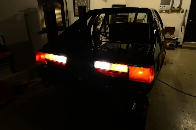

Lights in the back all work now.
You wouldn't believe the amount of wires required to make the hazard switch work. Took quite some time just to get a couple of lights to blink at the same time.
I also received my gauge plates. They came out amazing. The quality and feel of these things is impressive. They are extremely well built. I'm very happy with them.

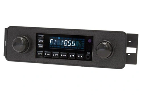

Here's the receiver I'm probably going with.
Keeping it old school. Like I mentioned, I dislike the cheesy, futuristic look of most aftermarket head units. This one by RetroSound has all the typical modern features. USB, SD, 3.5mm jack, equalizer, 4 channel external amplifier outputs, etc. It's all I would need and I love the look. Had I known I would have been going with something like this, I would have had the gauge plate cut specifically for the head unit and knobs. It will still look nice with the back plate though.
