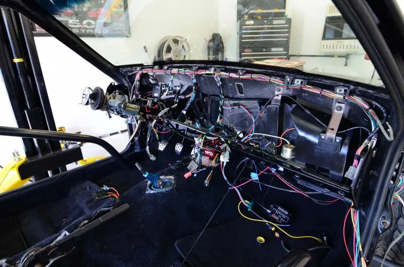

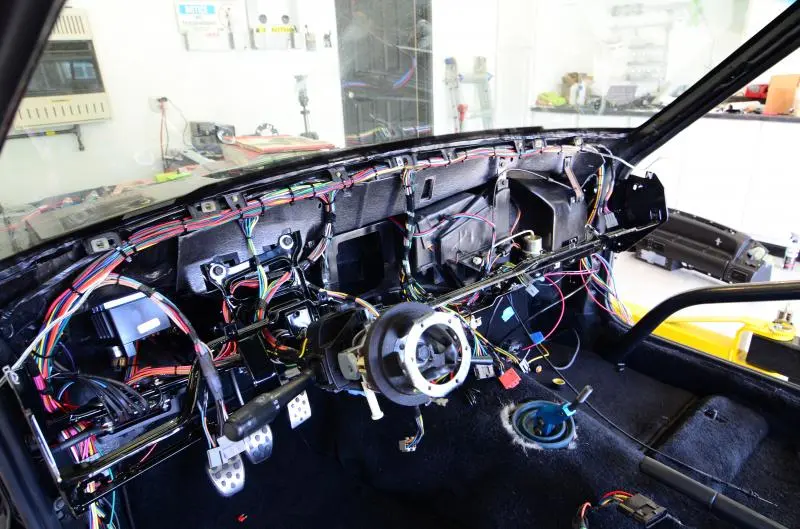

Speaking of interior, got a little more done today.

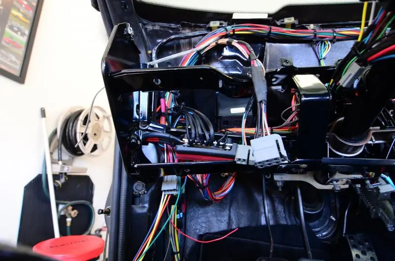

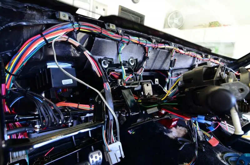

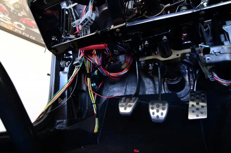

Got the mess of wiring under control for the most part. Enough for me to be able to get the dash in.

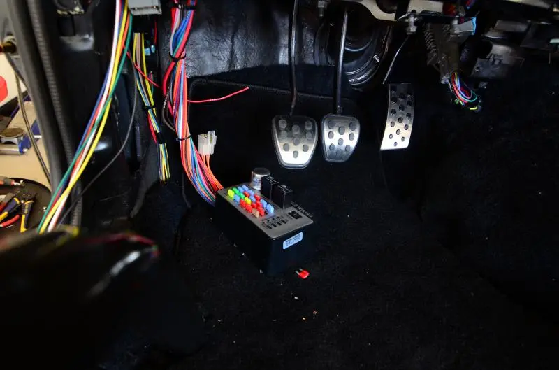

Here's the fuse panel pulled down from it's magnetic mount. Makes getting to the fuses SO much easier.

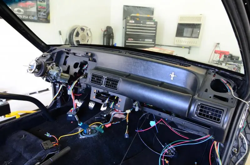

The dash is in its final resting place.
I didn't bolt it up yet, but everything looks lined up fine. It was a tight fit with the bundle of wires running across the firewall. Next up is getting the gauge cluster in and then the center console so I can get the PLX gauges up and running before I start the engine again.

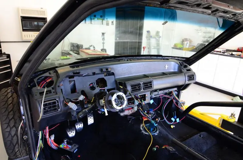

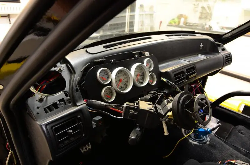

Test fit the gauge tonight. After cutting out the plastic behind the cluster area, they do fit...barely. The new Auto Meter gauge mounts stick out further than the older style, but the plate does sit flush against the dash. One little tab of the dash frame had to be cut out as well.

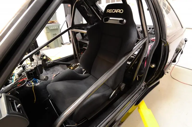

Oh, for those that were curious about seats. Got a nice second hand deal on these puppies, so I couldn't pass them up.
OK, This is where I'm confused now. I thought that everything on your elec panel would live under your flip lid in back. Evidently, your RF panel has a separate hub then a remote fuse block, where my Express panel is all locked in one place then?
It's fine by me though. I'd much rather flip a seat forward, lift a hinged panel and deal w/ a blown fuse that way then get down on one knee, contort to find the under dash fuse panel, and try to deal w/ it in that manner.
Everything in the rear seat area is solely for the ECU. The large landing label back there is for all the engine wiring. The chassis wiring fuse panel is under the dash held up via giant magnets. I would have liked to put that behind the seat as well, but it would have made the wire runs too long. RF advises against putting the chassis fuse panel anywhere other than under the dash. It could cause voltage issues.
Didn't I call recaros earlier? Must be psychic. ....
Looking good btw, you've probably mentioned it, but which gauge panel is that, mc?
