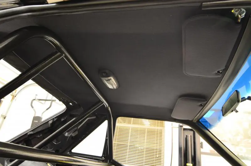

I managed to install the TMI headliner and visors. They are very nice quality. The visors are not lighted, but I didn't feel that was necessary. Definitely not the easiest install. Everything had to line up perfect for the mounting holes in the headliner backing board to be in the right spots. After a while, I got everything alinged where it needed to be. That is an SN95 dome light. Works great with the additional map lights on the sides.

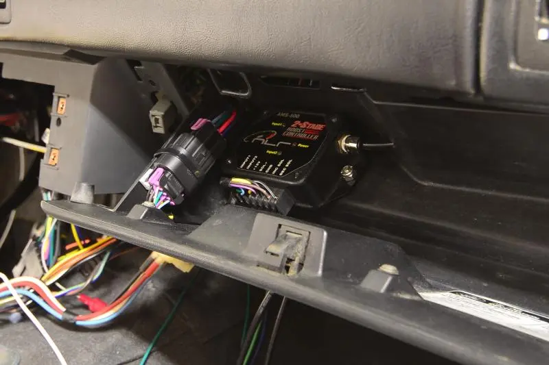

I also finished wiring and installing the boost controller. Fits perfectly mounted in the glove box. I used a GM throttle body connector to make it easy to disconnect if necessary. Beats fooling with the individual pins on the controller.

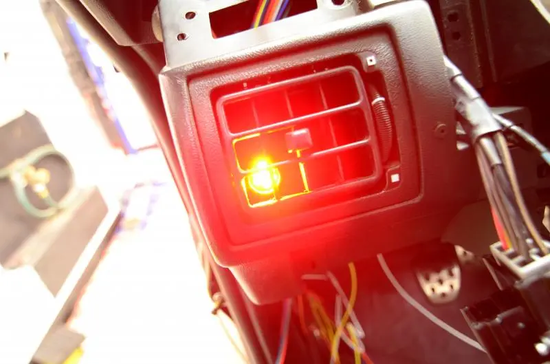

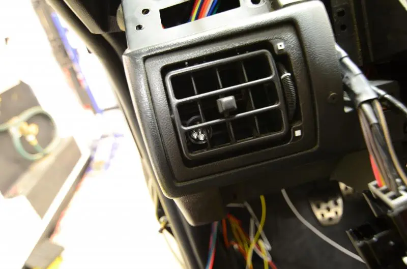

And here's the raptor shift light hidden behind the vent. This thing lights up bright. The second picture is only 3 of the 6 LED's that come on when the igition turned on. I'll have no problem seeing it in the daylight.
