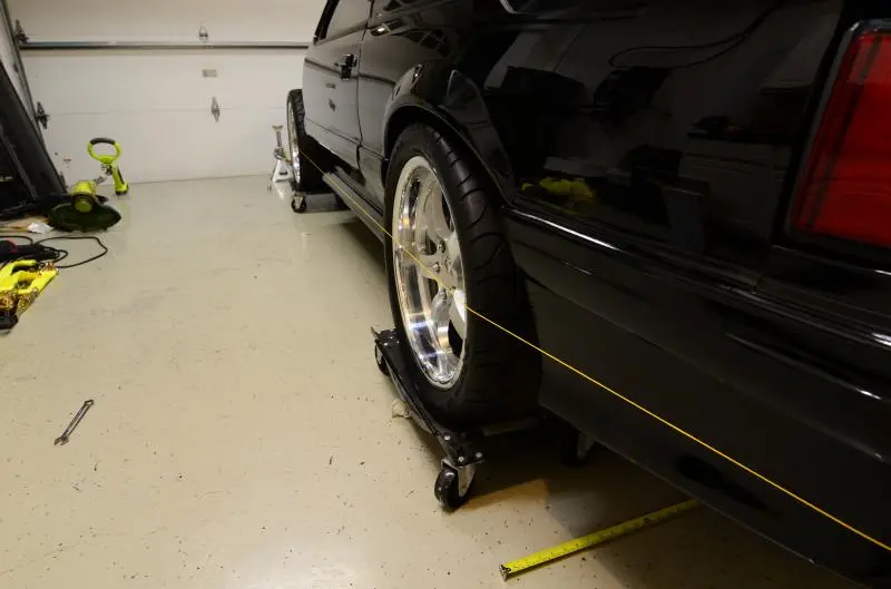

Next came time to get the front toe adjusted. I used the string method to get it close, taking into account the 1/16" of toe at the rear.

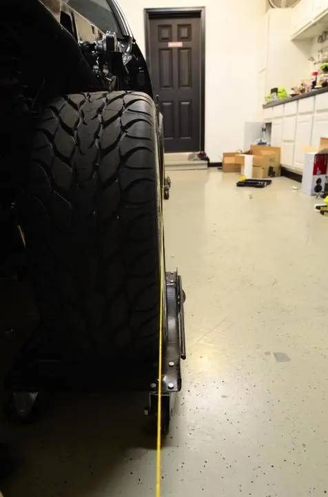

This is where I ran into a real head scratcher. Here is the driver side string against the front tire. Looks fine.

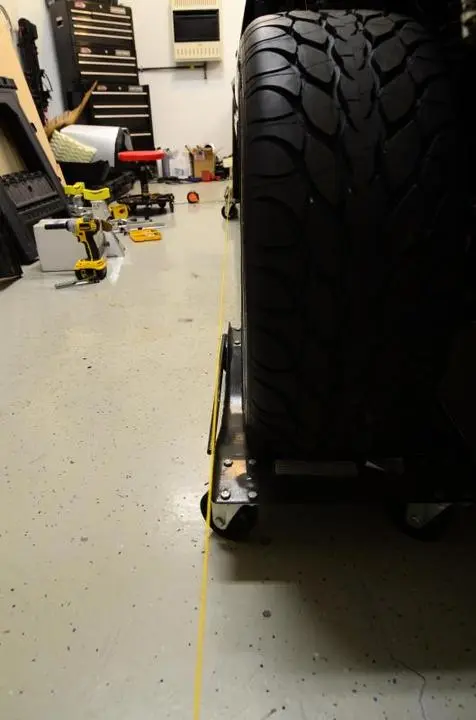

But here is the passenger side. The string is over an inch away from the tire.
I expected both tires to be the same distance from the string. It doesn't make sense that the front of the car would track 1" to the driver side. I first thought that my wheels might be the culprit. I swapped the wheels and nothing changed. Then I started measuring the a-arms. They are both the same length. Next I measured the distance from the rotor to the k-member mount. Both those values were the same. I have no signs that anything is misaligned up front. When I put a straight edge horizontally across the front tires, there is a definite difference when I compare the distance of the straight edge to the edge of the door. The driver side is further away. That eliminates the string as not being setup properly.
The strange thing is that when I mock up the fenders on the car, there doesn't seem to be a noticeable difference in the clearance to the edge of the fender. Both tires seem to look the same compared to the fender. A difference of an inch would be incredibly easy to see. Am I missing something here or is that just how these cars are and I'm experiencing some kind of illusion?

This Sir, is because the dude that built the damned thing is off the rails OCD. :)
