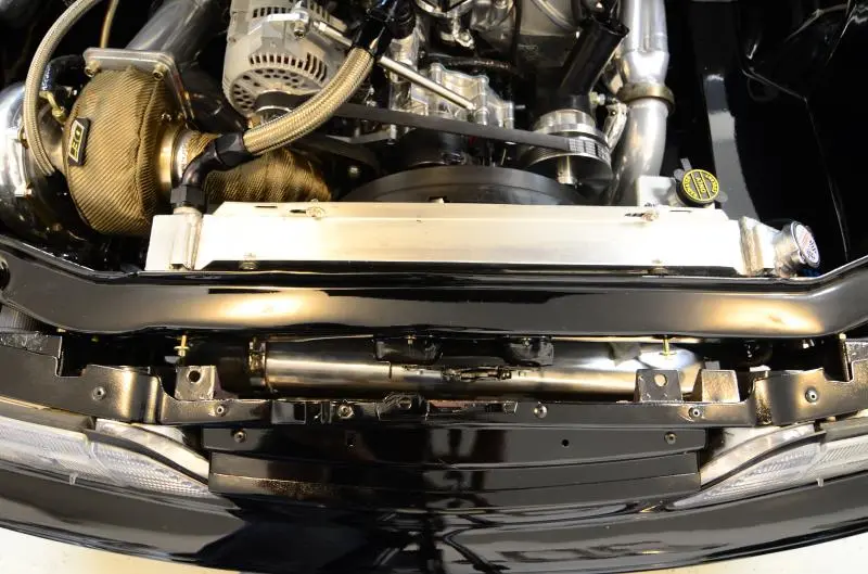

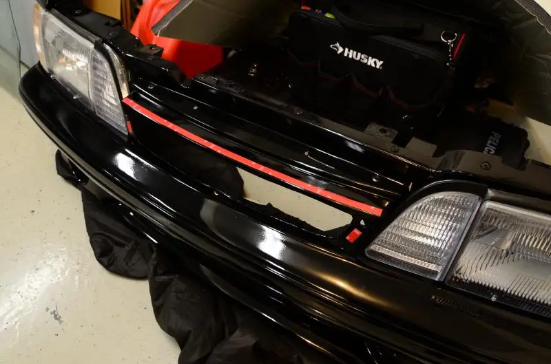

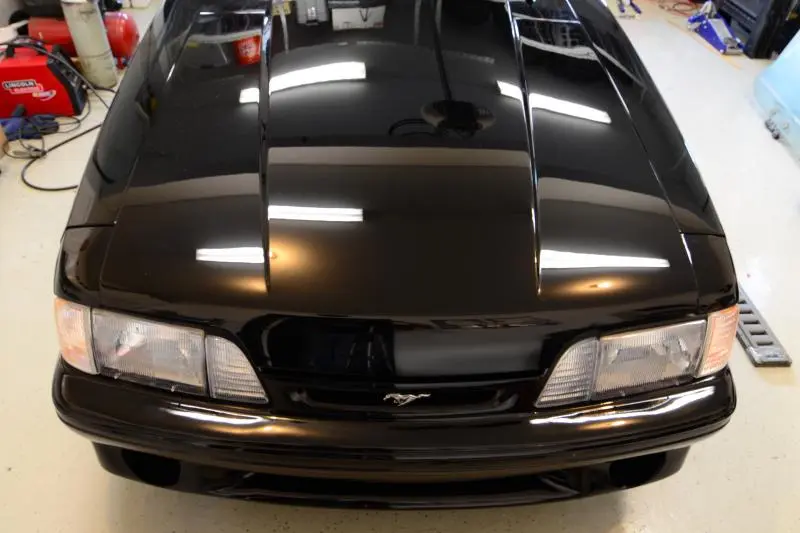

Started getting the bumper ready to mount. I need to trim the back side of the headlight panel a bit to clear the intercooler. I also don't have the cobra grill insert fully mounted yet.
The fog light bracket will also need trimming thanks to the intercooler. It's going to be a very tight fit. I may need to space it back further an inch or so.
It's nice to see the cars face though! The headlights are NOS Ford pieces that I scored on eBay.

I had to look at the pic for a minute.........Initially, it looked like you had all that stuff coming outta the hood. I was thinking that maybe my scoops hanging off the body won't be so bad after all, if Scott is gonna let all of that stuff hang out.;)

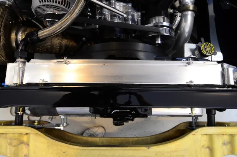

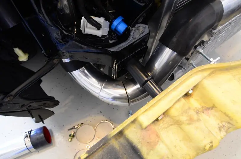

So, it appears that my cutting and welding isn't over yet. I was messing around with the bumper to intercooler clearance last night and I need to move the intercooler back about 2". The issue with that is the top coldside pipe is not going to allow me to do that without making it shorter. I'm going to have to get the welding tank filled again. It sucks that the pipe is already coated, but it won't be seen so I can just spray the new welds with some regular paint. Slight overlook on my part. I didn't anticipate the headlight panel to be so close to the intercooler. Pictures to come soon.

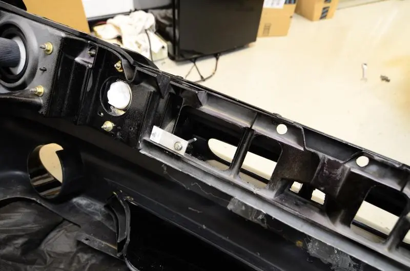

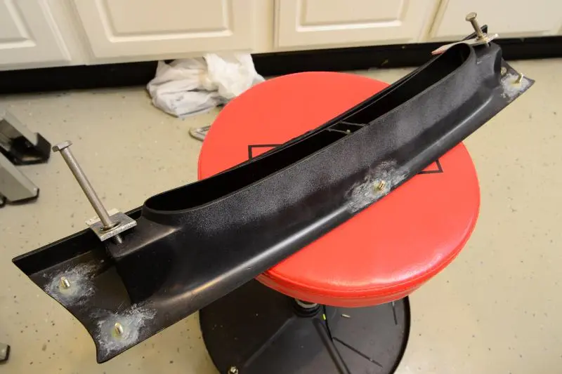

Cobra grill got mounted up. My method is possibly a bit overkill, but it sits flush and surely isn't going anywhere.
I used plastic weld epoxy to mount screws to the grill insert.
Double sided tape on the bumper also.
The insert has two holes for mounts, so I made aluminum brackets that will do most of the holding to keep the insert in place.

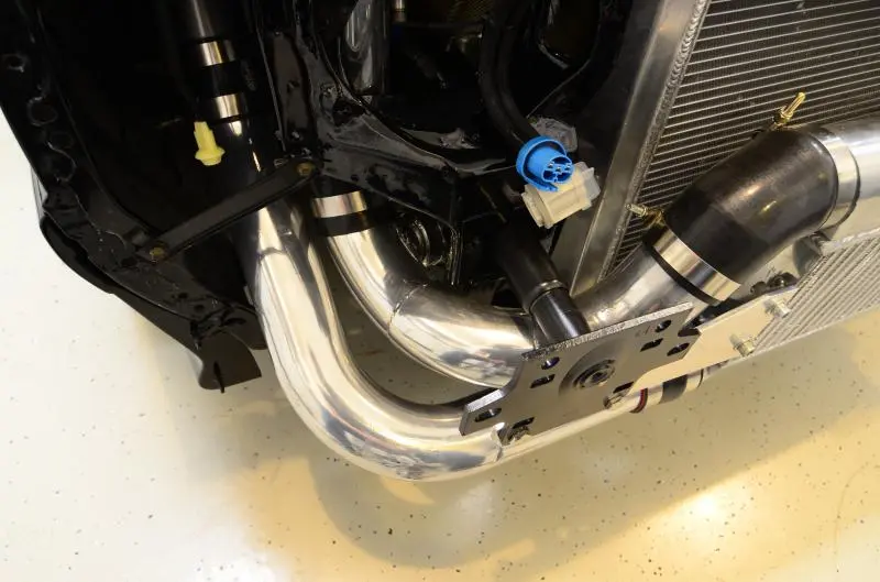

I also got the intercooler clearance ordeal figured out.

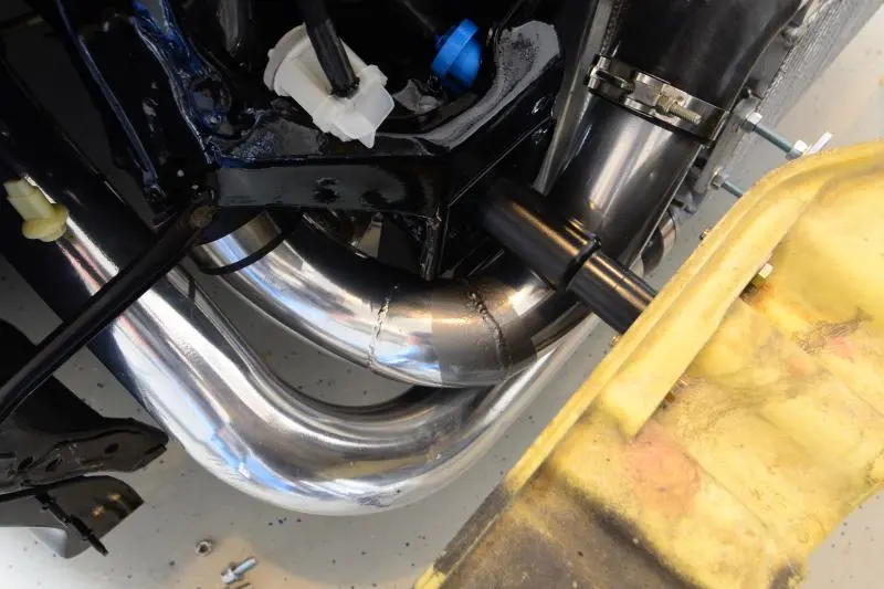

Here's the pipes before I butchered up the top one.
After some butchering. Shortened it by about 3".
Welded and painted.

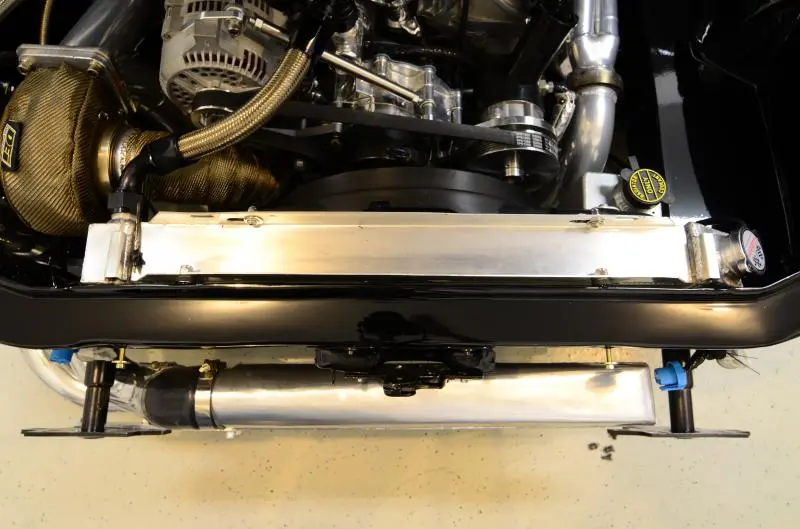

Intercooler mounting before.
Intercooler mounting after.

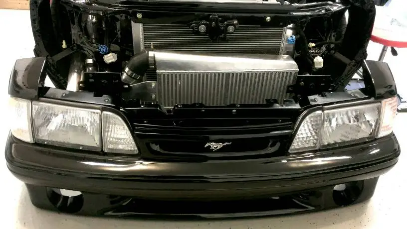

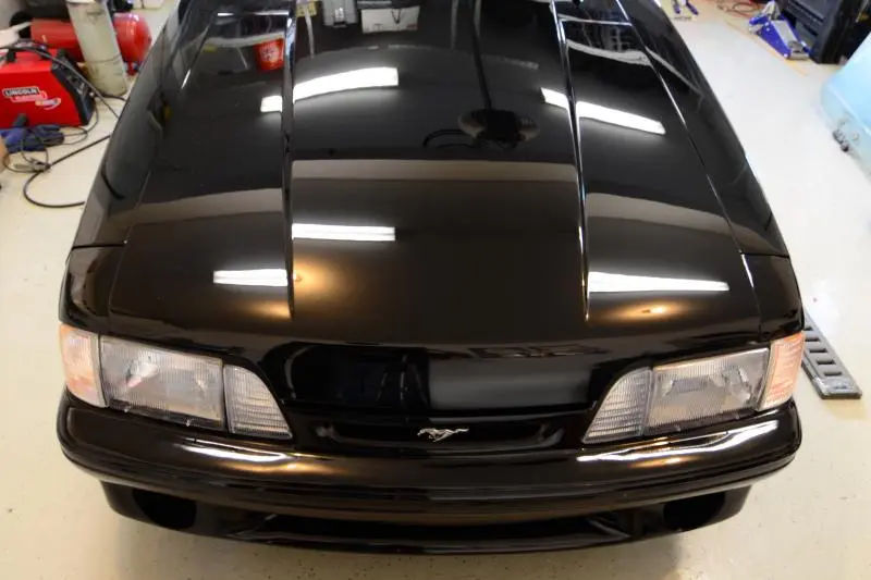

The bumper fits!
Teaser of it mocked up. I'll be permanently mounting it this week.
