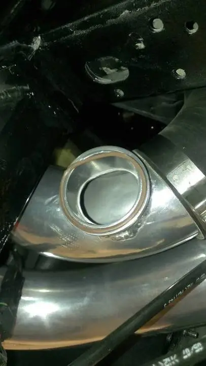

Hmm, guess this could cause a boost leak, huh?

That's where the BOV mounts. I pressurized the cold side and it wouldn't even hold a single psi of pressure. Massive hissing coming from under the turbo. Pulled off the BOV and found that.

Id be willing to bet a ham sandwich that the pressure on the turbo side is higher than 15 psi. You essentially have a nozzle and a diffuser back to back, where a nozzle converts pressure into velocity and the diffuser effectively kills the velocity... Since the air lacks pressure and velocity, it is unable to pressurize V2 to the pressure that it once was.
That's the plan Mike. I can leave my Holley MAP sensor as is and just tap my plx gauge into the compressor lines for the boost controller. Both will give me max values, so I can easily compare the numbers. All this theory talk is fun though.
It would be cool to see. I still think that the engine would be a larger restriction than the intercooler. If that's true, then pressure should be equal on both sides. :chin

There will still be a measurable pressure drop, but it shouldn't be more than 1-1.5 psi.
