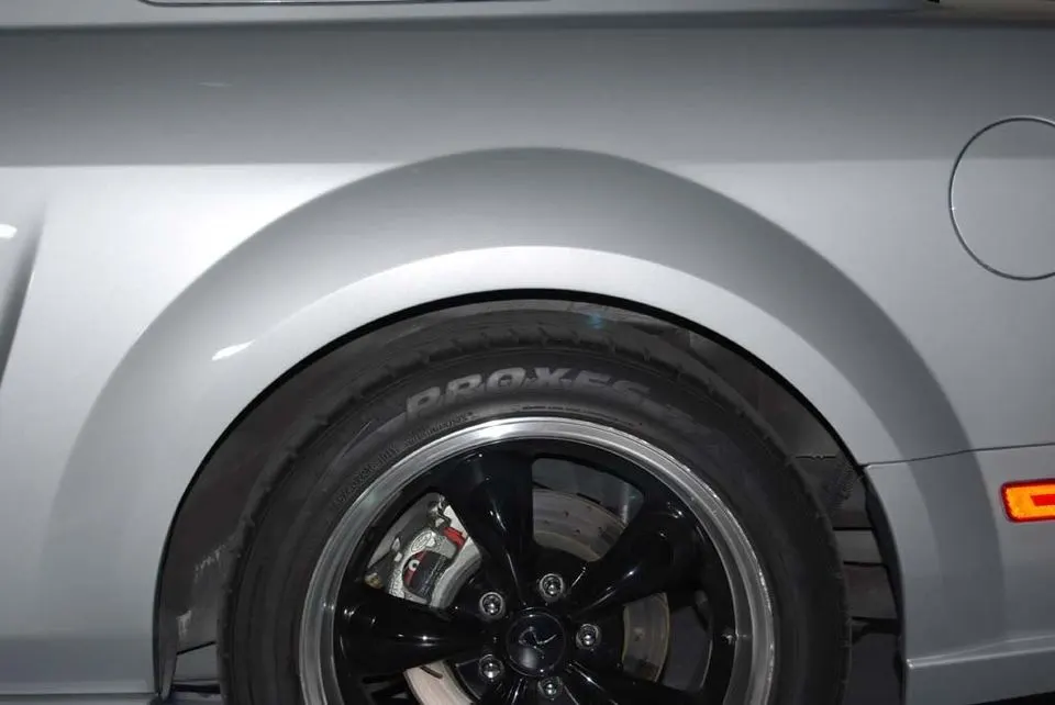

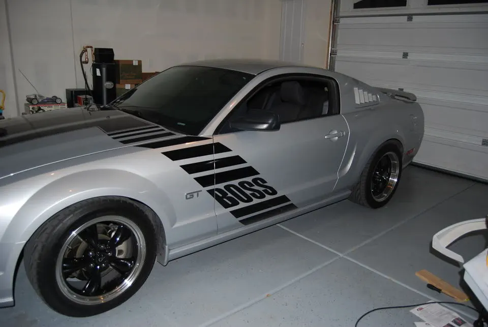

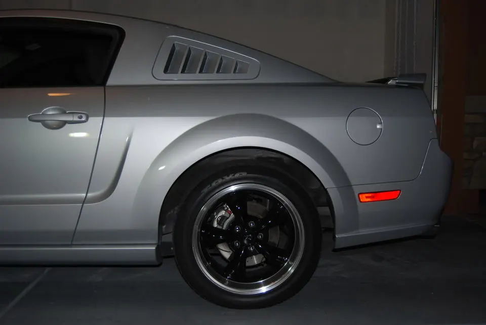

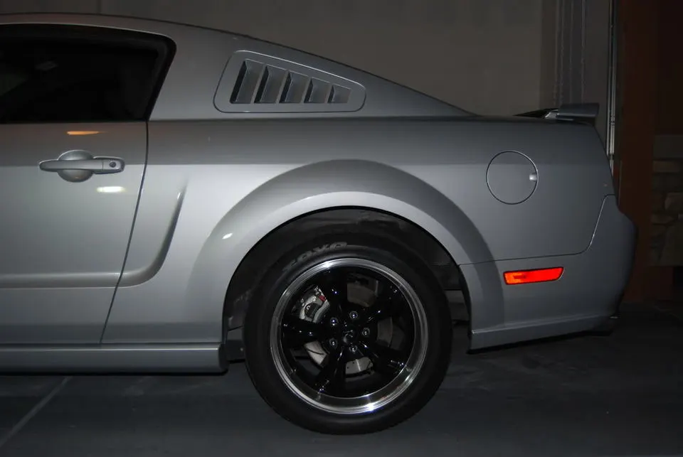

Stock struts and shocks are tuned to the stock suspension. When you you change your ride height and spring rate, if your shocks are not specific to those they will wear faster. I just lowered mine about 1.5" and kept the stock struts and shocks on for now. It's not vital that you change those now. You may encounter alignment issues or you may not. Your planned drop is pretty mild and may not have any issues, but be prepared just in case. With the drop in the rear you may encounter whell hop issues because your LCA's may not be at the optimum angle to work properly. When I put my eibach springs in I cahnged over to an adj. panhard bar, billet LCA's with relocation brackets, and an adj. UCA. If you have any more specific questions just PM me. I did the install last week and have everything fresh in my head.
Before install
After install
