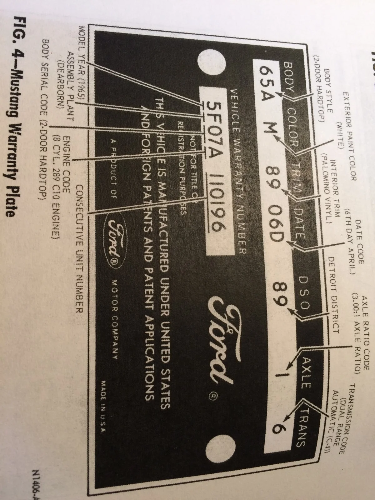

This information sounds correct and seems to be what is commonly practiced. However, this is a picture from the Ford Mustang manual 1965 and it clearly shows a distinct difference between Warranty # and VIN #., thus, my confusion.
Only difference is there is a space between numbers ,i still have the door tag and the fender apron numbers on my 69 and they match . The other numbers on the tag are motor ,transmission ,body color ,interior ,body trim and rear axle and DSO or district sales office
