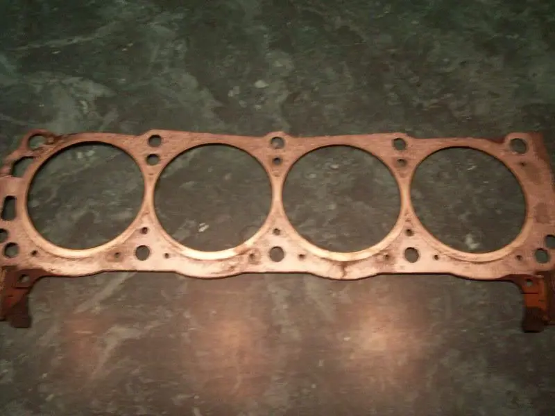

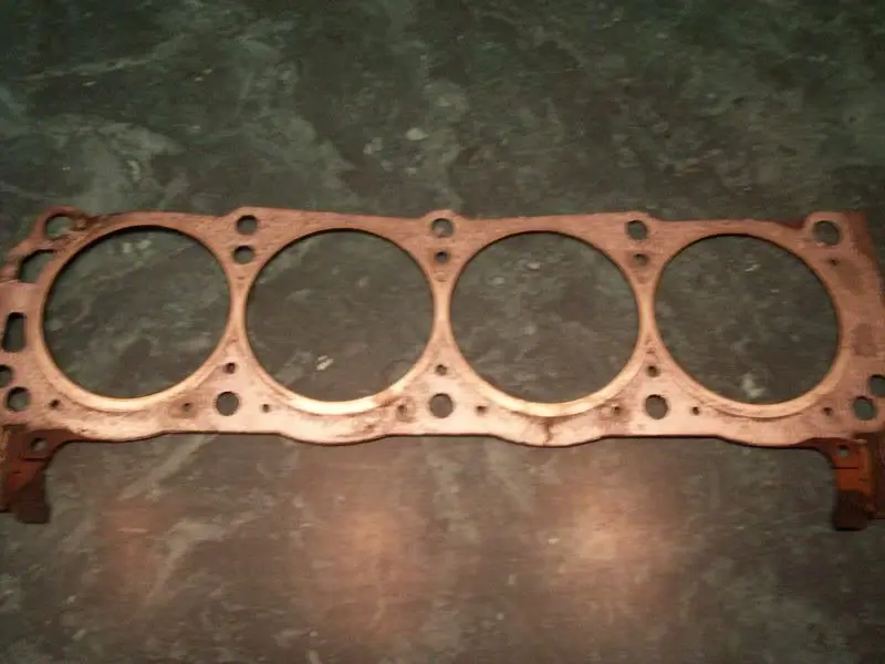

that is correct...pic of my old headgasket...look at the pistons are any noticeably cleaner than the others? alot of times if you have a bad headgasket leak the pistion where the coolant is leaking into will be alot cleaner than the others because the steam cleans the carbon off the piston..
look at the pistons are any noticeably cleaner than the others? alot of times if you have a bad headgasket leak the pistion where the coolant is leaking into will be alot cleaner than the others because the steam cleans the carbon off the piston..and you have to look closely at the headgasket to see signs of coolant passing from coolant passages to cylinder..
The h/g's where only on there for about ten minutes of run time. So I guess they look pretty good to me. I don't see any signs of a blown h/g. I think that maybe the heads did'nt get cleaned by me good enough. Oh well I will start from scratch and see if that fixes the problem unless you have another idea. Should I get the heads checked by a machine shop? I just got done cleaning the scaling.
