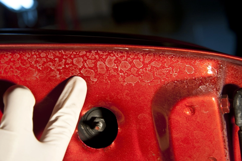

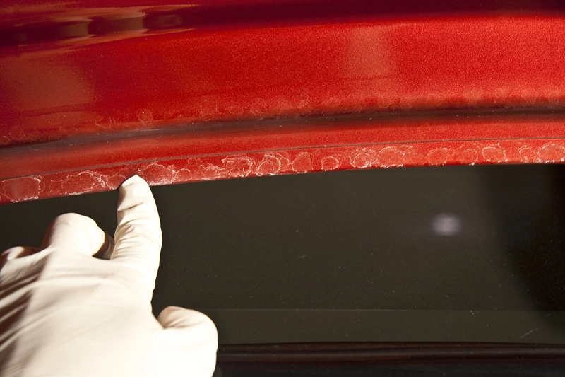

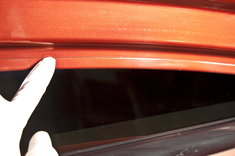

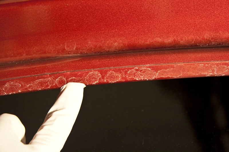

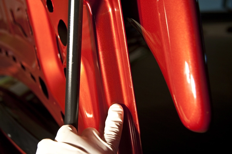

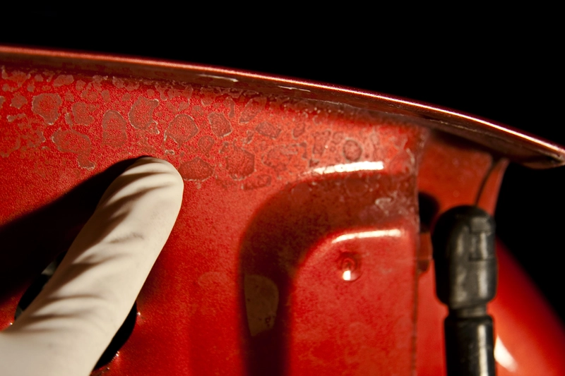

Problem: My house has REALY REALLY REALLY hard water. From years of washing my car at home with hard water, I developed water spots where on the outer side of the trunk seal in the Jams. The Water spots were REALLY BAD and VERY thick. I got sick of seeing the spots so i wanted them gone.

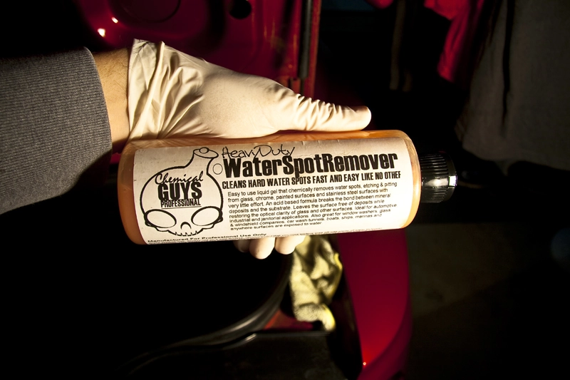

Solution: Chemical Guys Water Spot Remover
I decided to try CG Water Spot Remover on the problem and see what happens. The product itself is a Gel, so it doesnt drip and run where you dont want it to go. The Product itself smells HORRIBLE!! Its smells like Stinky Vagina To me. Kinda Odd because every other CG product has a Great fruity smell.

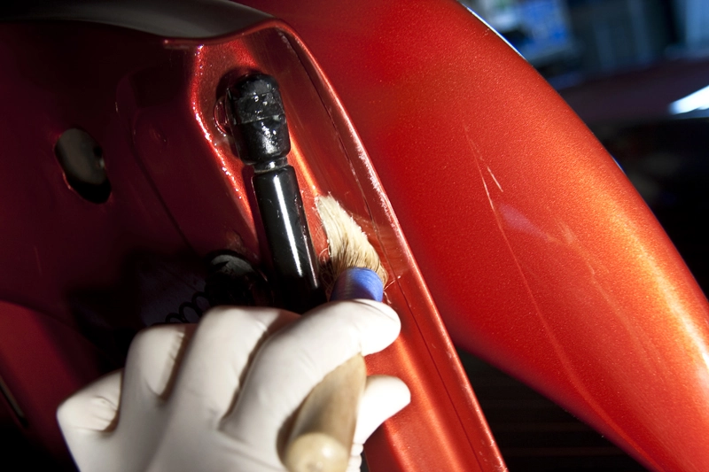

Process:: I washed the area with Soapy water and Wiped with IPA. I then used the WaterSpotRemover with a MF towel and rubbed the area. The Product does not need alot of muscle, but needs some action to do the job. I used an MF towel for the large areas. I also noticed you need to keep the gel on the area, if it soaks into the towel, it doesnt work as well. I used a Brush to apply the gel to the crevasses and agitate. Once the job was done I rinsed with Water and wiped down with IPA

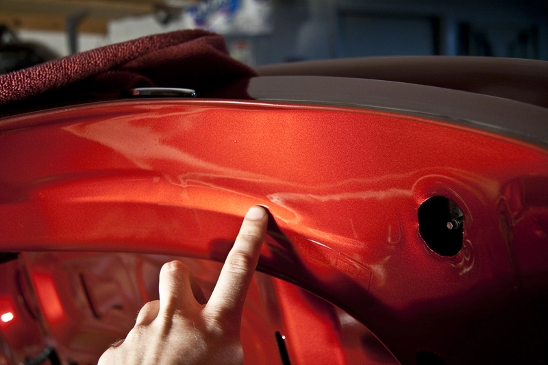

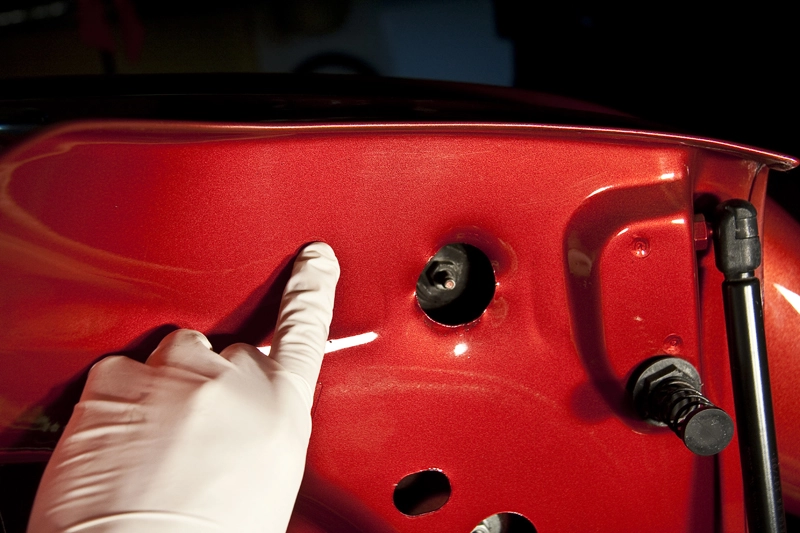

Results: AMAZING!!! The spots are GONE!!! I didnt even have to work hard to get them off!!! Awesome Product that is a MUST HAVE in the collection. This will come very handy in the future!!!
Before
After CG Water Spot Remover
