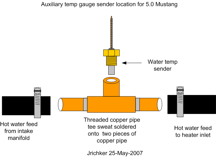

Alternate placement for a temp gauge sender: Use the heater feed that comes off the intake manifold. Cut the rubber hose that connects the manifold water feed to the heater and splice in a tee adapter for the temp gauge sender. Be sure to use the same water feed line as the ECT sensor. That way you will get the most accurate temp readings.
Tee adapter info:
Make a pilgrimage to your local hardware or home supply center and get some copper pipe and a tee that fits the temp gauge sender. Solder two pieces of copper pipe onto a copper pipe tee with threads in the tee part. Find the correct brass fitting to match the temp sender threads to the tee fitting.

Hmm ... never thought about the tapped water outlet being a spot for a temp sender, but now that you mention it, I do recall seeing those with the included plug for sale while crawling around the back parts room. You wouldn't happen to have the part # off hand for the one with the tapped outlet, wouldja'? I'd like to be able to run both my stocker and the Autometer gauge I've got on my notch; the Autometer one "sticks" a lot of the time and doesn't pop up to read correctly for a minute or two, and the stocker is just laying on top of the intake manifold doing near-nothing.
I swapped out the water temp gauge of my Autometer three-gauge set once with some other brand of temp gauge because that "sticking" gauge thing was starting to annoy the poopie out of me, but the other one did the same exact thing. It'll sit there on 100* for what seems like ages, and then it either hits a bump or the T-stat opens or whatever and it finally decides to come up to read a proper temp; the stock sender builds up a reading gradually at a normal pace, so I dunno which of the two darned things to believe, really.
Just thought I'd throw that out there, in case you decide to plug it into the same location and wind up having the same issue. I dunno if it's a design thing with the gauge (or brand), or a problem with my choice of sending unit location.
