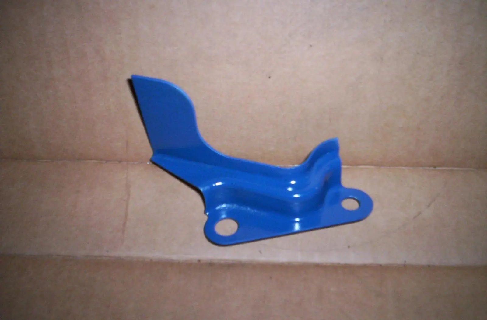

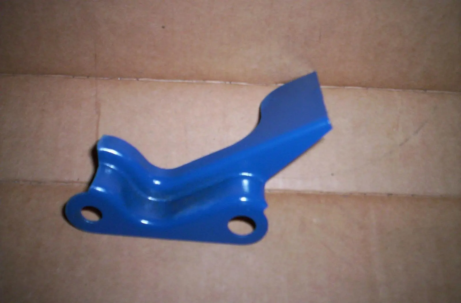

All he needs then is the 70's bolt on timing pointer. This is the only one I have left out of 5 I had. Sold the others one at a time on ebay for $20 a piece.:D He'll also need to remark the balancer to time it or swap to a 70-up unit.
Re-marking should not be too difficult, it's exactly 90°, the easiest way would be if he can find an appropriate degree tape from a speed equipment supplier.
Switching balancers, on the other hand, would require changing all the pulleys and brackets, a major project.
