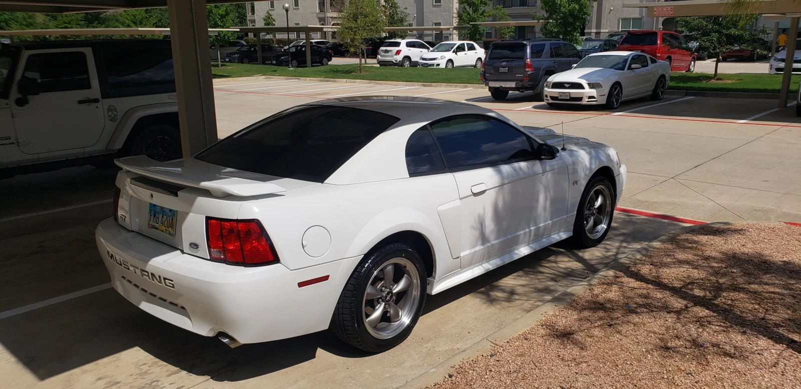

I recently acquired a 2 valve 4.6 L mustang GT (2003)
Any thoughts for getting more horsepower on a budget? It already has cat back exhaust and a cold air. Those things alone don't do much, I'm interested in keeping it street legal, but more fun.

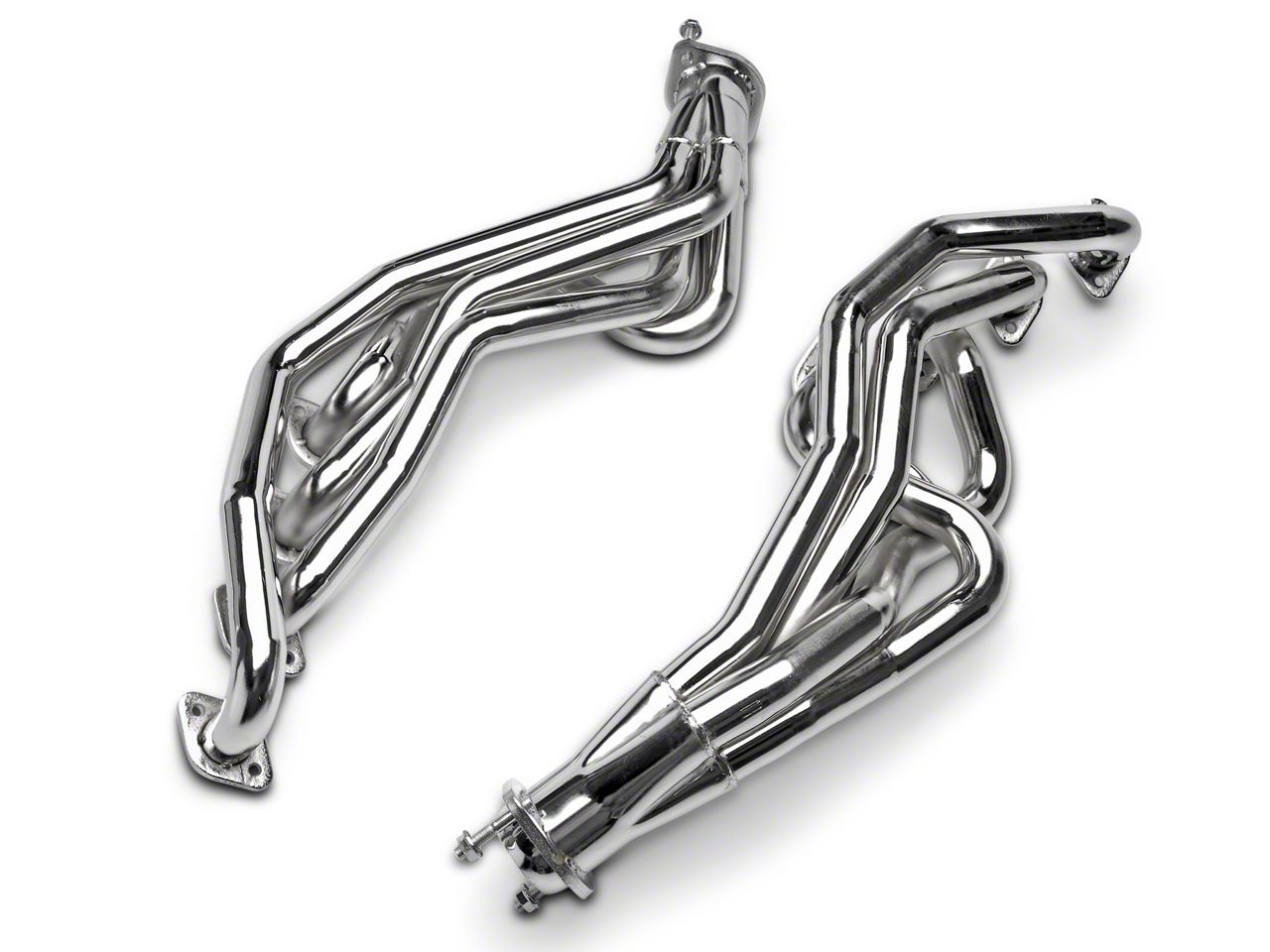

LongTube Headers for Manual or Auto Trans, another 15RWHP with a Tune..Don’t forget 02 Extensions, stock Plugs won’t reach the 02’s.
