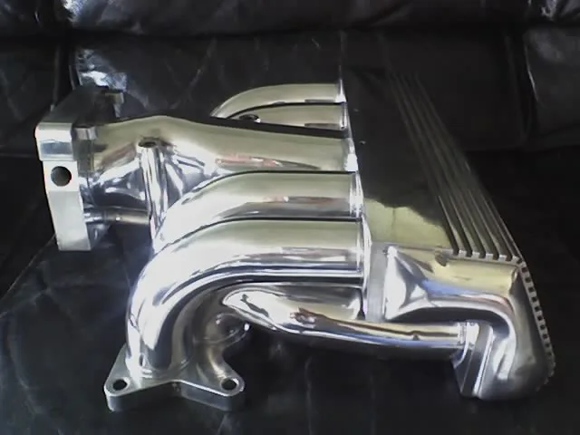

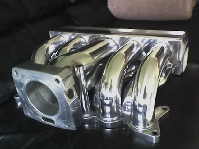

After 42 hours of PAIN!!! hahaah we have BLING!!!
Project complete-
Ant
The biggest PITA were the lower tubes on the inside, because you cannot get your ifngers in there. I had to use a brillow pad to scuff it up, then polish with a screw driver and then ran out and got a 6 inch (ryobi) sewn buff and white rouged the visible parts of the inside tubes about 6X on powerdrill @ 3000rpms. finally bling on the inside. The hardest part is finding out what works. Whatever your not sure about-Just use a brillo pad, some soap and water @ least you scuff it up and gives it the white aluminum stained look, try and get soem type of polish on it-It shines up-real quick.
