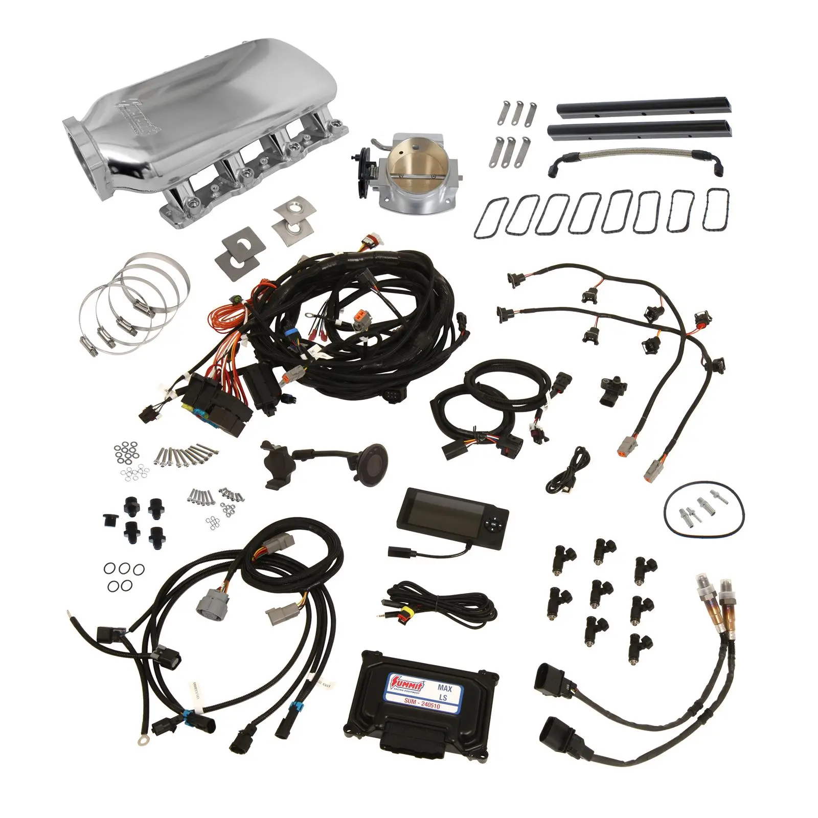

If I was to buy the Summit injection system attached here.....
It says ECM included.. So the computer is included??
Fuel system - NONE Does this mean I would need to buy injectors and such??
ignition system- NONE.. does this mean the included ECM ONLY runs the Fuel injection but NOT the ignition or that i need to buy sparkplugs and coil packs..
Power distribution- NONE ????????
I could save around $2500 using this instead of the stock chevy/ECM/intake besides the Looks good bling....
Any one help me out here some???
Multi-Port Fuel Rails Included: Yes
Injector Size (lbs/hr): 55 lbs./hr.
Oxygen Sensor Included: Yes
Fuel Pressure Regulator Included: No
You would still need plugs and coils and all that stuff.
From the destructions:
The system also comes with a stainless steel oxygen sensor bung, target AFR and timing control, two fan control outputs, 12 volt square-wave tach output driver for most tachometers and a speedometer output driver for most electric speedometers. The system is compatible with LS1-LS3 24X or58X crank sensors, 1X or 4X cam sensors, and compatible with both car and truck ignition coils. Wiring the system is made easy with a custom wiring harness that uses existing factory coil packs and sub harnesses. The Max LS ECU System comes with a knock sensor control and is custom cam friendly. Included are several preset timing curves that are each tailored for different camshafts, final drive gearing, and vehicle weight.

This one from Summit has an rpm range of 4,500 to 8,500 so may be a dog below that, not sure. The low profile one is 4,000 to 8,000 rpm so not much loss on the top end and the curve moves down a little. I've seen several sources say the Summit Racing™ MAX-efi 500 Fuel Injection System
is made by Fitech exclusively for Summit so that is a plus as they have a decent reputation. Have no idea who is making the ECU for the system you listed. That would be a bid deal for me as I would want them to partner with a known EFI company.

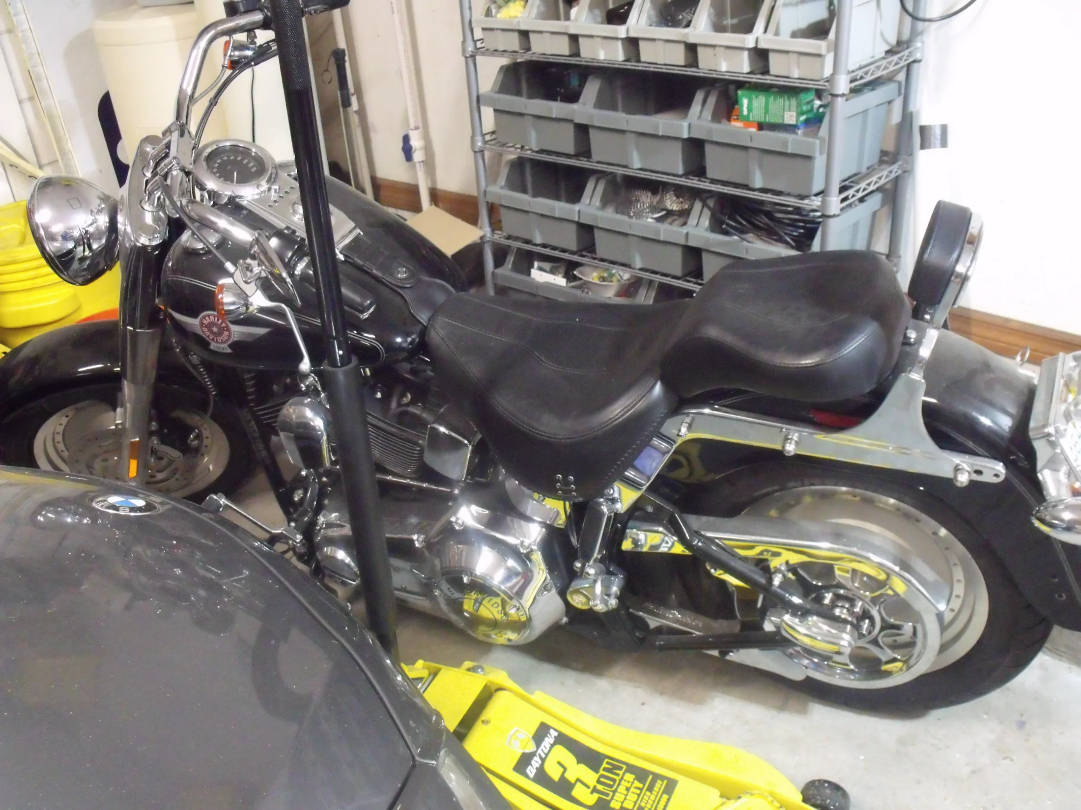

If my Fat Boy was carbureted ( as I ordered it in 06) it would be running instead of broken in my garage for the last 3 years... But the dealer had a FI model in stock and talked me into it...... Just saying

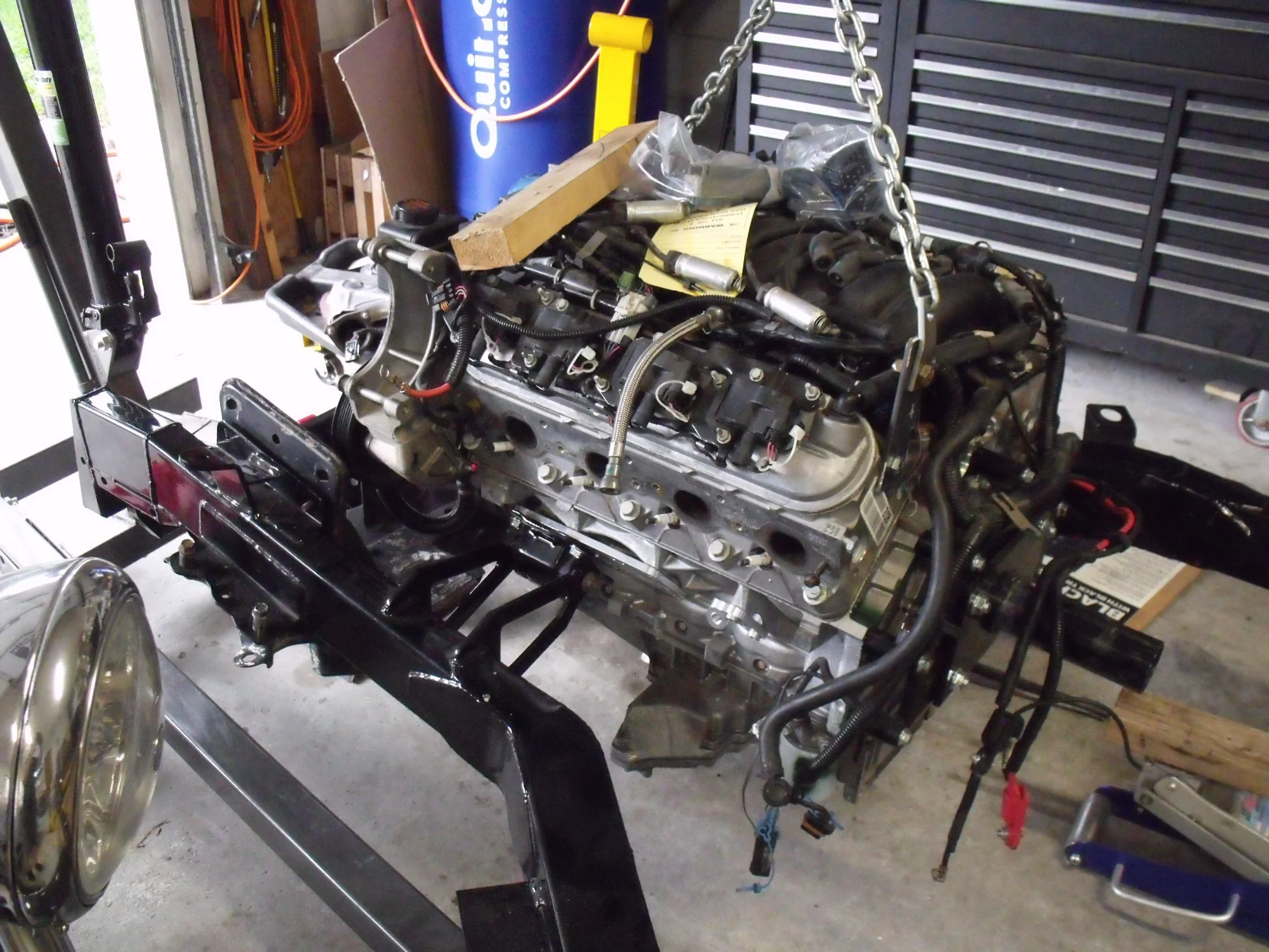

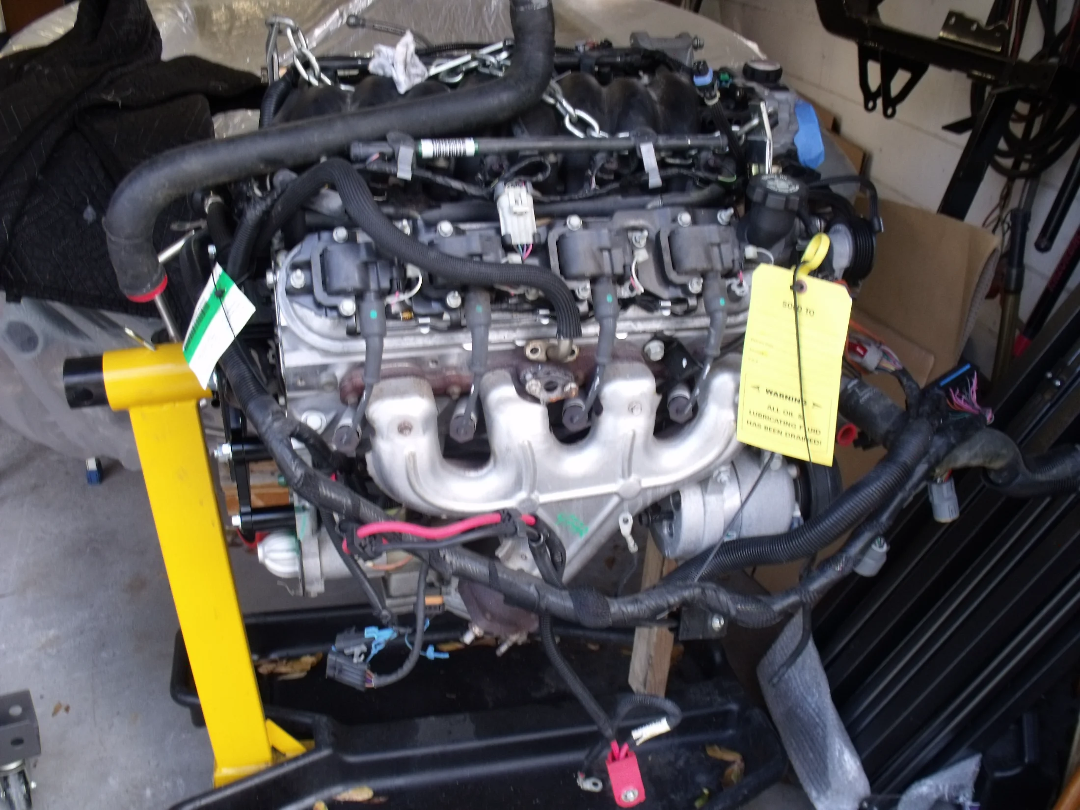

I ended up buying a LS1 from an 01 corvette with 31K miles on it.. It was wrecked and I heard it cold start and run.....
Not only did I save around $7K on buying this, it came with all the wiring harnesses, computer TBW pedal and box.... ALL of the accessories and brackets were on the front, it has exhaust manifolds, and the " Bat wing" oil pan will fit my frame nicely so I dont have to spend $400 on a holley pan....
Couple of pics, second one is test fitting it to my frame before I sent the front crossmember out to powder coating..... Looking to see if I had to cut any where..........

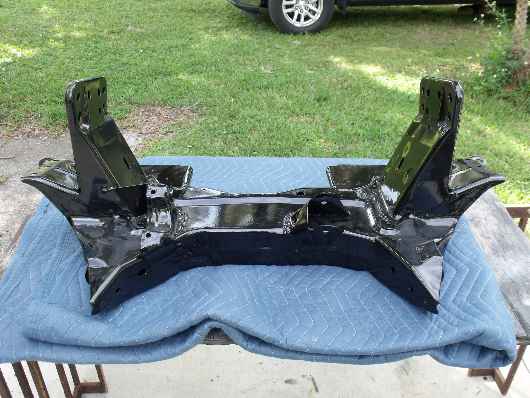

Back from powdercoating
