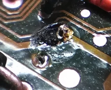

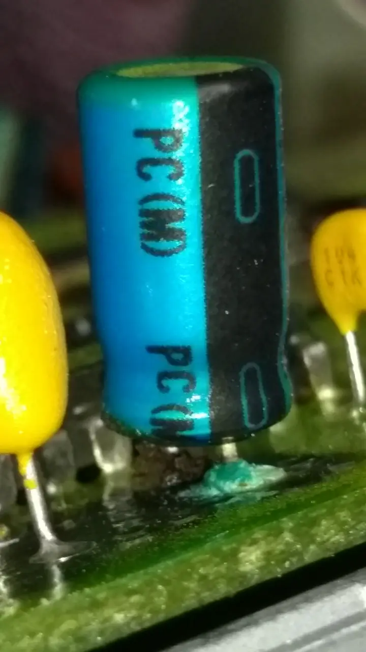

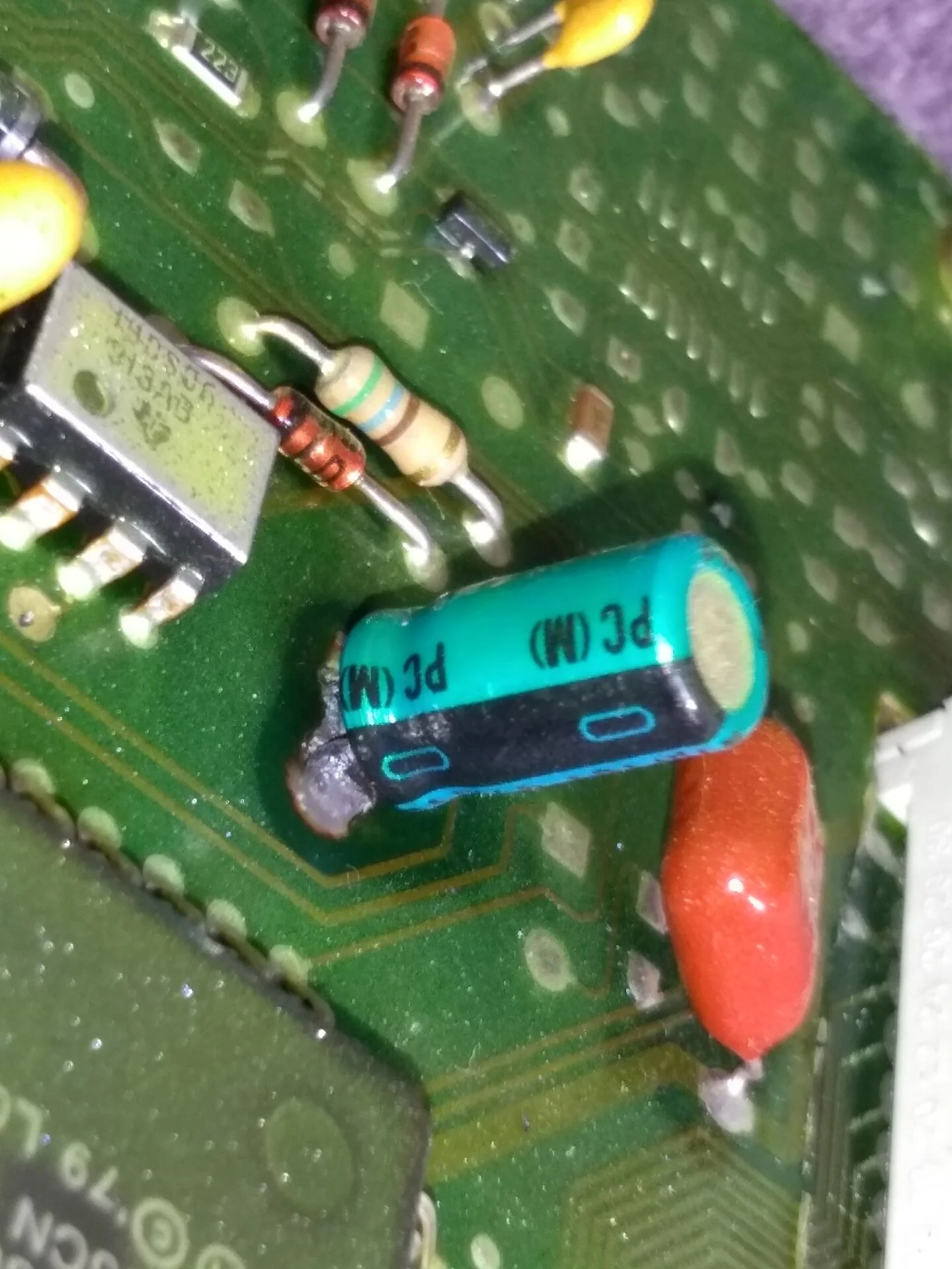

Not hijacking thread. But I've been dealing with problems as well. Finally pulled computer and found this. 2 of the 3 capacitors is leaking. The one with green fuzz is missing a leg.
I sent my computer off to ECU Exchange today. I could probably solder myself, but I want the whole computer checked out.
Yep, leaking pretty good at that.
Shoulda replaced them yourself. It’s easy to do.
Best of luck. Hopefully that will resolve your issues.
