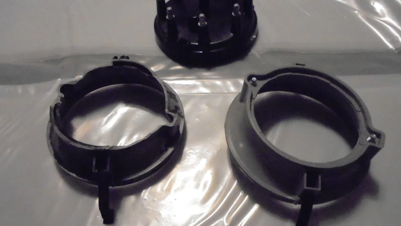

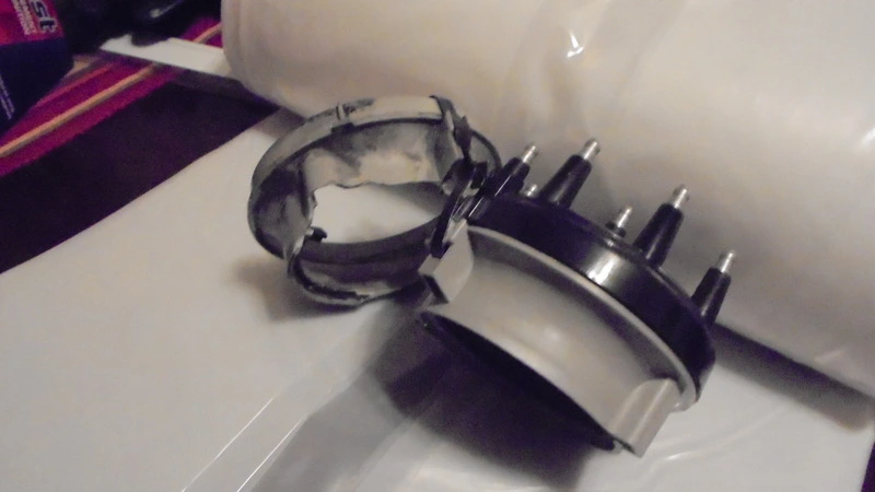

So thinking maybe she jumped time, I loosened the distributor and was going to attempt to move it back and forth while it was being cranked over and I got major Zappage..Looking closer I found the lower cap adapter had cracked (or burned?) completely around as shown in the attached pics.
I never seen this type of weird damage to such an innocuous part.
We had it towed home and put on the $13.00 part only to still have a no start condition..

Is it possible that the PIP/hall effect inside the dizzy could have fried and made the cracks all the way around that lower cap adapter somehow?
and is now causing an electrical interruption in the fuel pump circuit?..

Here's the lower cap damage..wth?caused this and now the no fuel no start?
