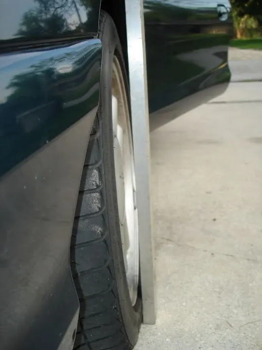

Do your tires look like this.
It handled great, funny thing was the inside of the tread was worn the sdame as the outside.
