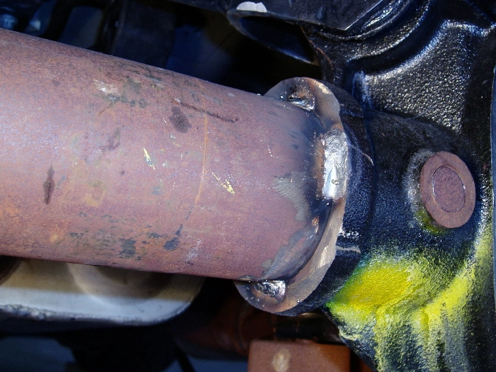

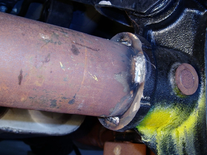

It was fun to do. I don't think I would pay someone to do it though. I think you really only need to do it if you are an all out racer making some big HP.

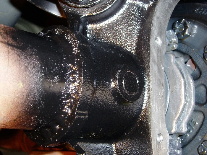

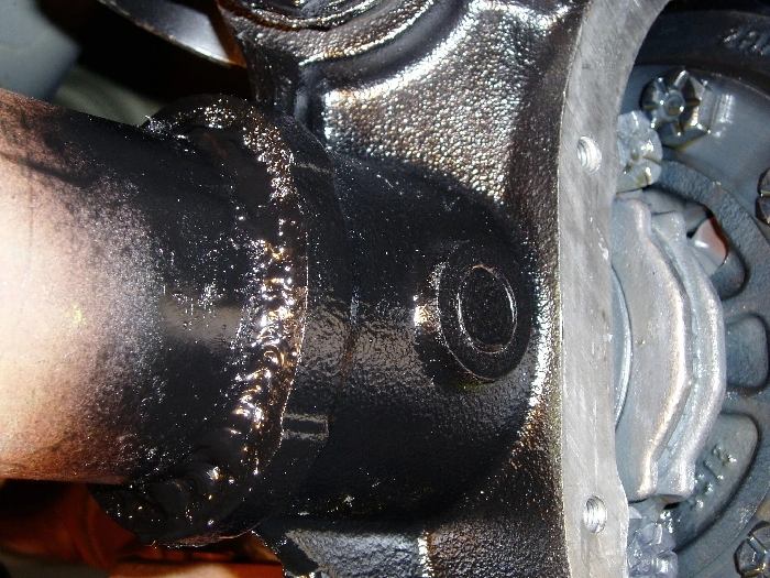

Rocketman, thats an excellent picture. Did you have your 'torque boxes' welded as well?
I've done all the welding myself on my car using a Millermatic 175 gas shielded MIG welder which is a 220V welder.

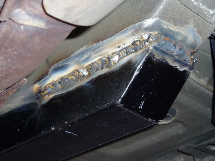

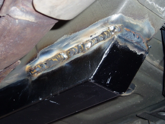

I haven't done the Torque Boxes yet. But plan on it when I change my LCA's to the new Steeda Aluminum weight jackers. I don't go to the track much and don't run slicks or DR. I welded my axle tubes just to see if I could. Welding the tubes to the cast housing is not that difficult if you have any welding experience at all. I've also welded on MM full length SFC.
