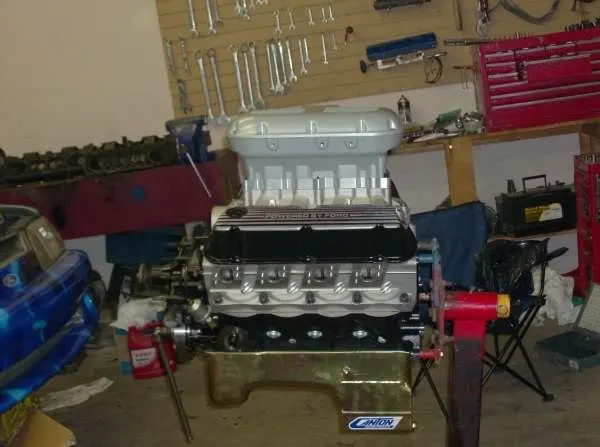

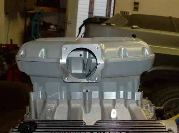

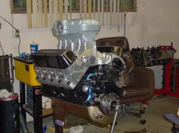

Here's some pics of the motor. Damn is this thing Ginormous! The intake can swallow small children. I can't thank my buddy Dan enough. He has done an amazing job getting this heap put together. Now we're just waiting on headers and she should purr like a wildabeast.
