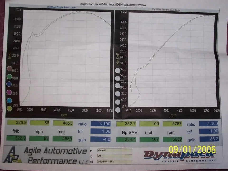

Your SC needs a more conservative tune(am guessing since you blew up your motor)

Have you talked to Tim yet? Also, was the car dynoed to check the a/f ratio? Sorry to hear your car broke man, its the worst thing to not be able to drive it for any extended period of time like that. Hope it gets back up very soon.

my tune was not the problem and after kicking out 4k for the blower i'm not going to sell it maybe just take it off the car for now

i posted this before but here it is again my a/f and dyno run
so as i said before its not the tune
