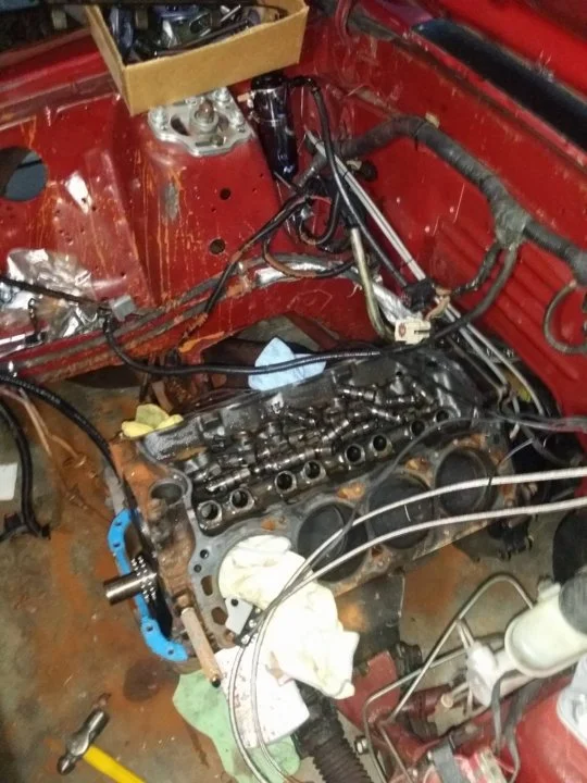

11.66@115mph
on a 250 hit pulling a metric assload of timing
bypass fitting rusted through ending my day early
anyway pretty much everything is off now. the short block will prob stay till its sold or i get time to bring the hoist from the shop down and pull it out along with the transmission.
