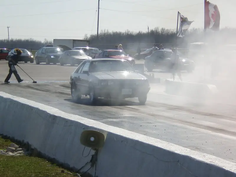

Well I went again yesterday and let me say...total waste of money. Stupid opening day for bracket racing. I was there from 11-5 and I only got 5 passes. The first 3 passes my car kept stalling out and I found out that the fuel pressure was totally bleeding out through a loose fitting. So I got that all straightened out and made a pass to check things. I really only was able to do one good pass on it. I couldnt tune or tweek anything, it was way too busy so it sucked.
My only real run I ran a 13.26 with a 1.806 60 foot. I kept 16psi in the tires this time around and launched at 5000rpm. The extra psi caused the car to spin off the line as opposed to bogging like it was doing last week.
Heres a vid and you can see it spinning. I'll post some pics later
Ya I was amazed that 1psi would make that much of a difference. The track was even prepped better yesterday too. This means that now I gotta do a bit more playing with my launch rpm to get that sought after 1.6x 60'.

I didnt even notice the to missing, but what sucks is every track day will change. The suspension might work, but the launch RPM, tire psi, and burnout technique will change with how each track day is. Found this out with our two step car!

Nice video and pics. :nice:
Seems to launch fine, and a little bit of spinning, is easy to solve.
But, you need a lot of timeslips, to solve out your way of driving, launchtec, tirepress, weathercond, and as mentioned , burnout tec. etc.
