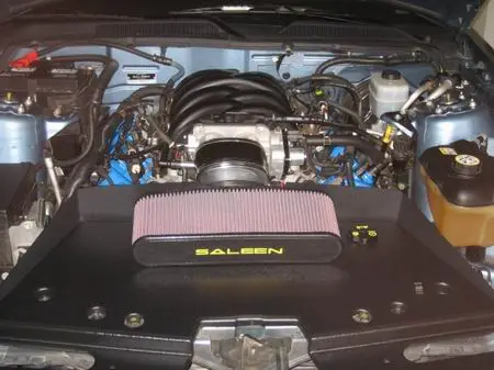

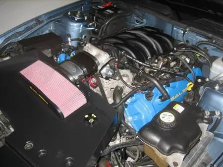

Western Motorsports CAI installed!!!!!
Cooldawg6: Love my WMS also. Really a breeze to install. Makes great intake suction sound reminiscence of the old tri-power intakes from the late 60's.

I agree. I love the WOT sound now. Kinda hard resisting to hear it every chance I get. That and having swapped out for the 4.10s. I'm lovin' my Stang more and more!!!!! BTW, I love the Saleen valve covers. I will get the blue ones for mine when I swap out the cams/valve springs in the future.

Hags1, I'd also like to know about the braided hose covers as well. Plus are those the QuickLIFT hood props? If so, where did you get them and how do you like them?
The filter cover is from Outerwears Pre Filters. It's part number 100-2084 O/W. It comes in different colors. It's not listed on their website, but if you call they'll know what your talking about.
The hoses and clamps I purchased from amstreetrod.com. They are Earl's brand and are really good quality. You can order the hose by the foot and the clamps come in different colors as well. These are actual stainless steel braided hoses, not the ugly braided sleeves you can buy and slip over your present rubber hoses....that stuff never looks right IMO...
The hood lifts are the Quick Lift Elite from Redline Tuning. They work really good with the stock hood. You can open the hood to the position you want and it'll stay at that position. It can also be open all the way like the pictures shows. I purchased these when I got the WMS Ram Air Box so I wouldn't have to notch the edge for the prop rod. I've read that these hood lifts aren't recommended with the after market fiberglass hoods tho.
Couple thoughts I had when I did my WMS CAI and WMS Ram Air Box. I followed someone's idea of lining the back side of the Ram Air Box with heat barrier sheeting and tape. You can see the back of my box looks silver, which is the heat barrier sheeting and tape. They sell that stuff at Summit Racing. The thought here was to slow down the engine heat from entering into the ram air box. When my hood is down the ram air box slightly touches the hoods liner, basically making an enclosed box that the filter sits in. The air coming thru the radiator and into the box is probably as close to cold air intake as your going to get. Enclosing the box with heat barrier sheeting keeps the heat of the engine out of the box. I've run my car during the summer's heat and popped the hood to see how hot the ram air tray is....it's never hot and you can touch it with your bare hand....My other CAI was hot from the engine heat and touching it had to be done cautiously.
I mentioned I purchased the hood lifts so I wouldn't have to notch the ram air tray for the hood prop. I also decided on the braided hoses since the ram air tray sits on the upper radiator hose. I wanted to make sure the tray wouldn't wear thru the hose since it's sitting on top of it and the hose moves when the engine moves. I know it's kind of anal, but I didn't want the tray to wear thru the radiator hose....probably wouldn't happen even with the stock rubber hose.
