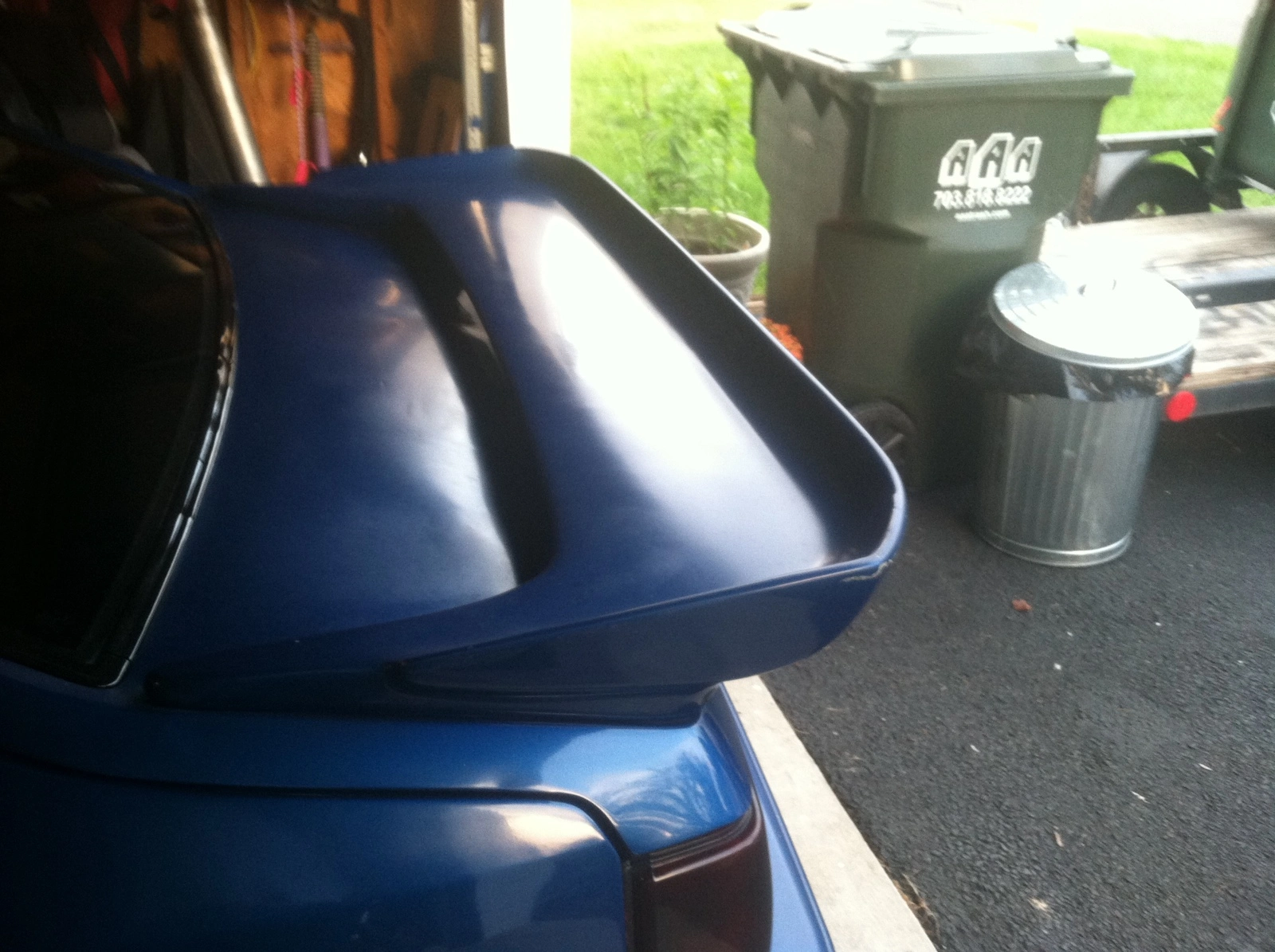

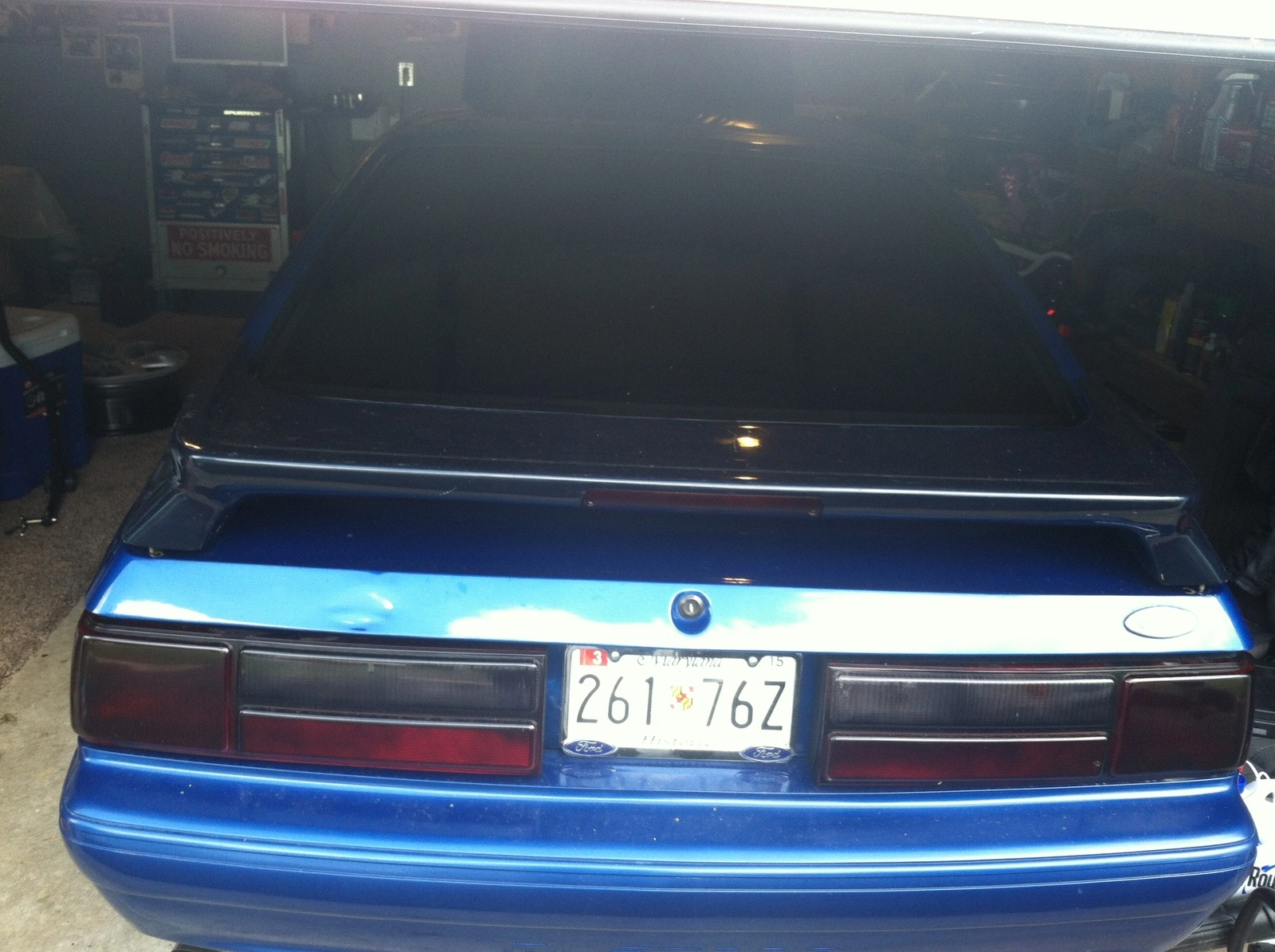

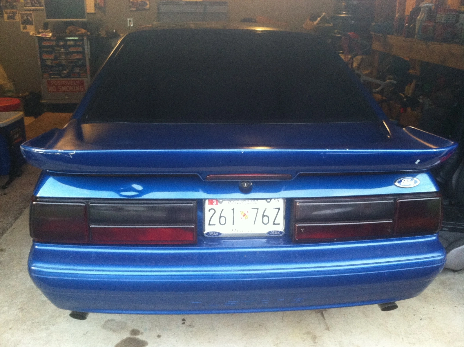

Well, I've had major intentions on getting rid of my Saleen spoiler as I have kitchen counter tops in my house and I sure as hell don't need any on my car so it had to go not today but yesterday but here is where my dilemma starts... This was the previous owners idea and I could see how it could be a good idea but in my opinion, its days were numbered the day it went on!

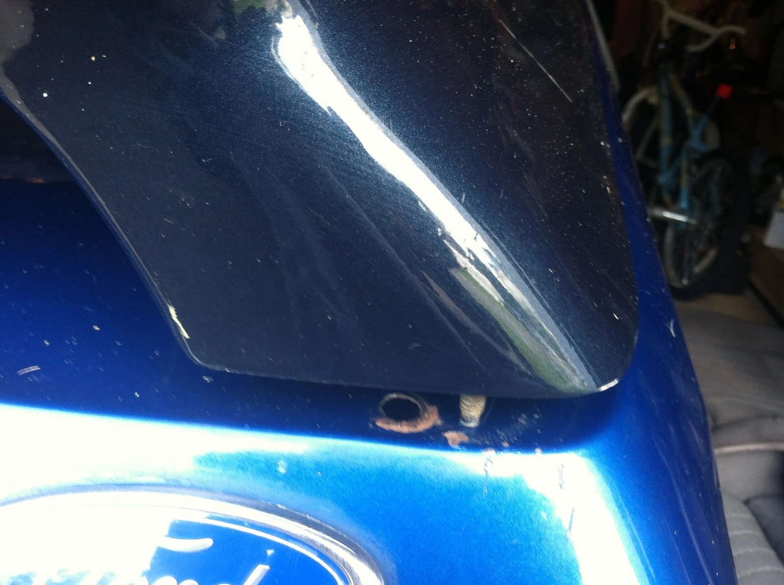

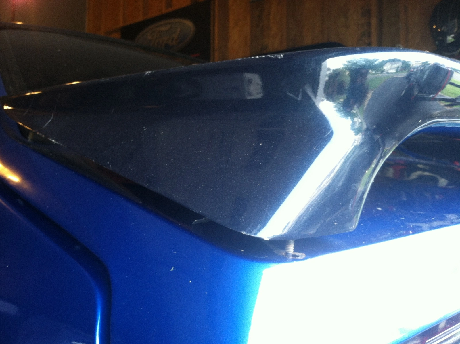

So I take off the table......

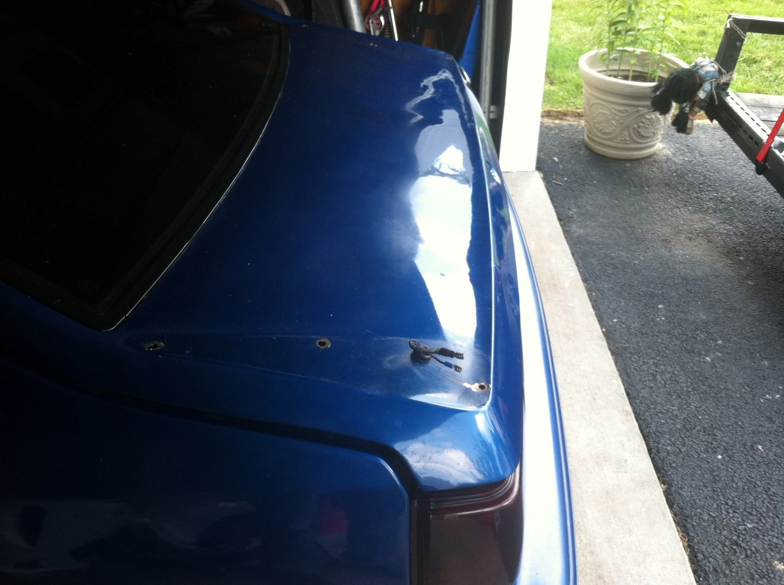

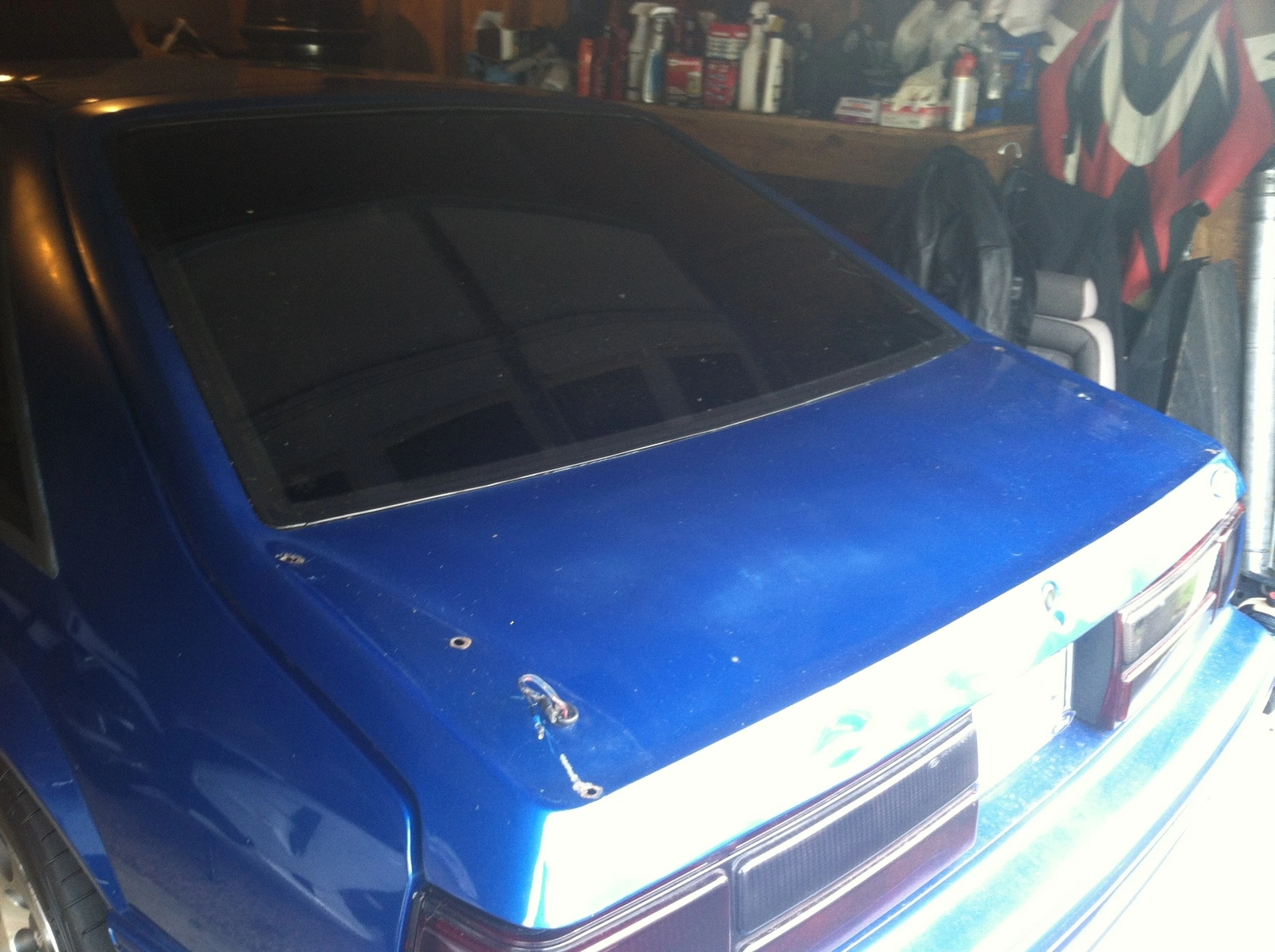

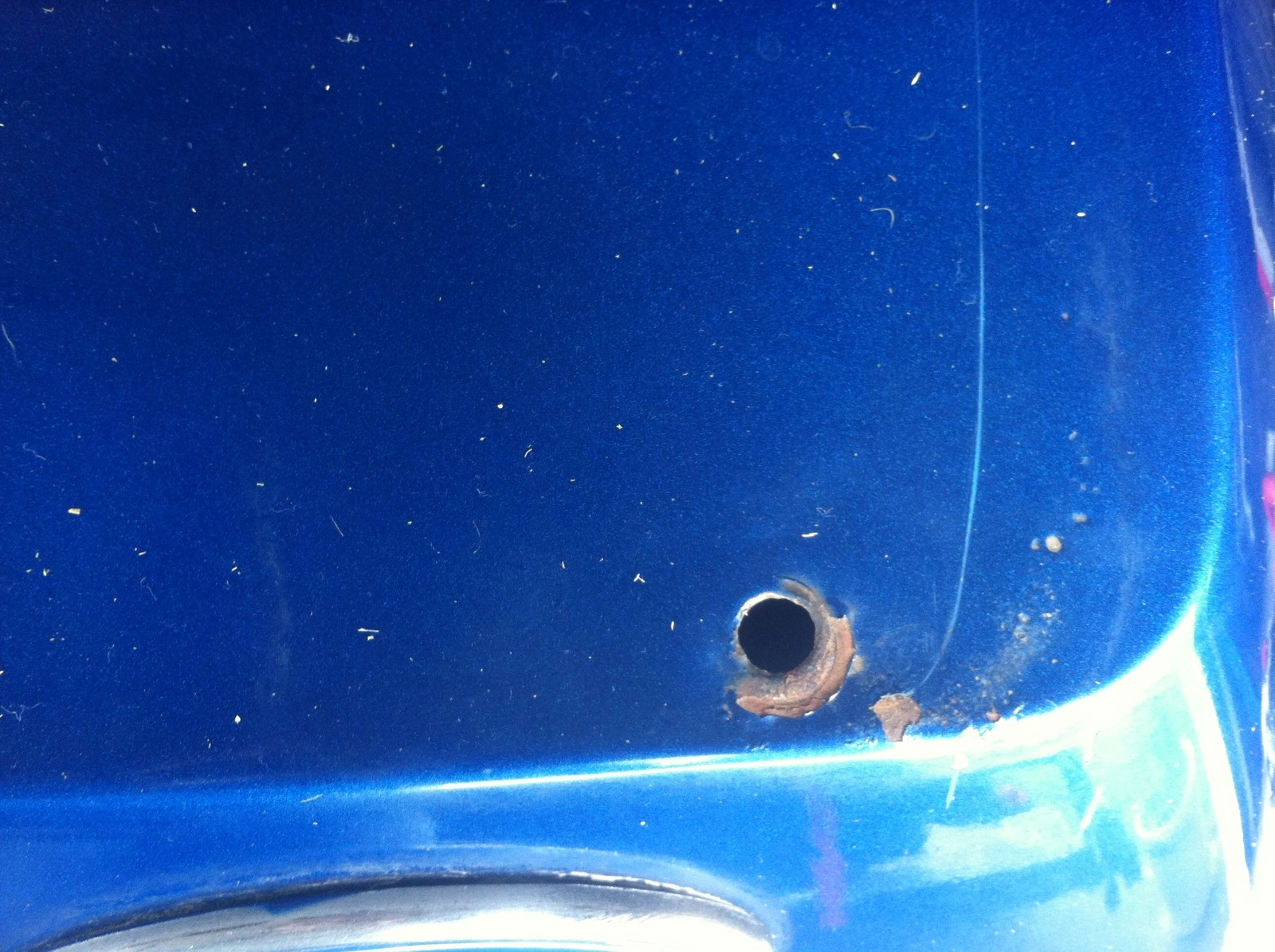

I see boogered up existing welds and it made me wonder. I always knew the old lx holes were welded up but then I see this...
not a one fuggin hole lines up. So obviously all the old holes were welded and the holes for the Saleen spoiler redrilled. This sucks..... What can I do now? Need some opinions.
If the holes are all underneath the GT spoiler, then just put some rubber plugs in the old holes, redrill the new holes, and move on. Unless you really want to replace or repair/repaint the hatch to fill some holes you will never see.

You could just do what Twighlight suggested and plug and redrill.
I got cha bud!!! As much as I don't want to drill any "new" holes, I'm obligated if I want the wing. If it takes drilling some new holes for a new wing, any thing is better than my busted Saleen!

i had the same issues when i pulled my saleen wing off. a few of mine lined up and a few didnt so i just opened a few of them up with a unibit and used washers under the studs
