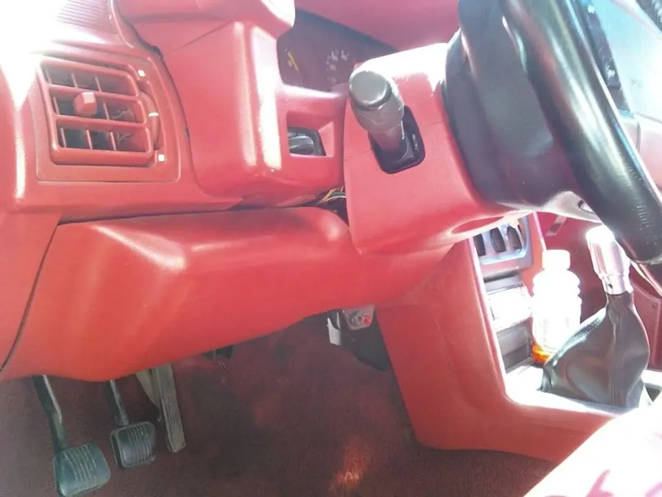

What am i missing to complete the gap on my 93's steering column? This is the 93
And this is my 92 column
the only thing i can think of is that my 92 is a 4 banger and my 93 is a 5.0? Or is it because my 93 is a ssp car? Can someone post pics of both 92's and 93's so i can see what i missing. peace

My 92 is the same as your 92.

Smokedya,
It looks as though you have a 92 steering wheel on a 89 dash. My 89GT has the same bottom dash as yours, there is a small ribbed piece that has screws on each end that covers this opening under the column. Probably best found (~$5) at a salvage yard. I don't have a picture, but I know for a fact this is whats missing.

agreed.... it will curve around that gap and there is two screws. see if there are holes for them

The ribbed piece was my thought too, though I couldnt remember for sure. I just remember that the tabs for the screws are kinda lame and the plastic cracks pretty easy. Be careful if you score one.

^^^ What they said as far as the ribbed piece. I have an 93 5.0 and it has the same lower dash piece. The steering wheel cover on the column does look off, it might be from a different year as stated above.

100% correct wrong dash for the that well and coloumn cover

You need the 90-93 knee pad. Your SSP has a 87-89 knee pad. Prolly cause it would be a PITA to put that trunk button on one

no its a little rubber trim piece that is attached to the knee guard.

Hummmmm ok guy's. My buddies 88 has that ribbed cover that covers that spot i'm talking about thats why i was asking what the hell is going on here? Didnt know if the 93's were diffrent then all other years or what?peace

I can see you have the two piece under dash instead of the one that the 90-93's have

That dash panel is pre-90...a 93 should have the same bulging out panel that your 92 has...
