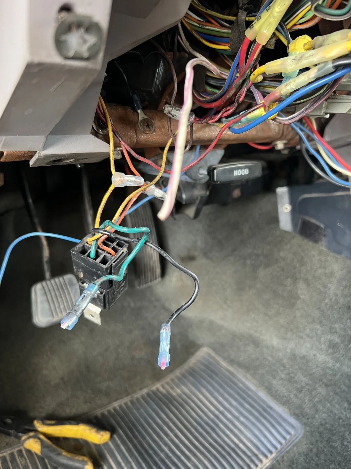

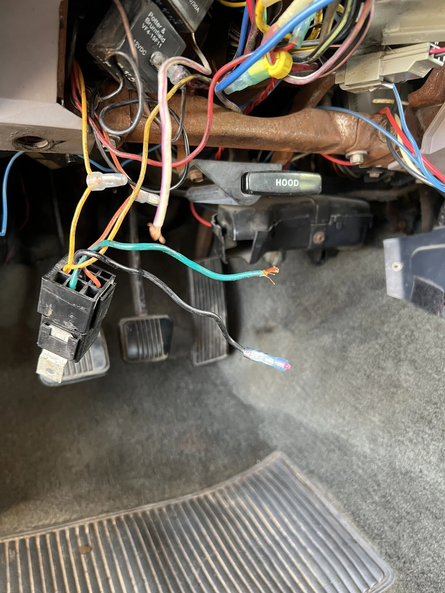

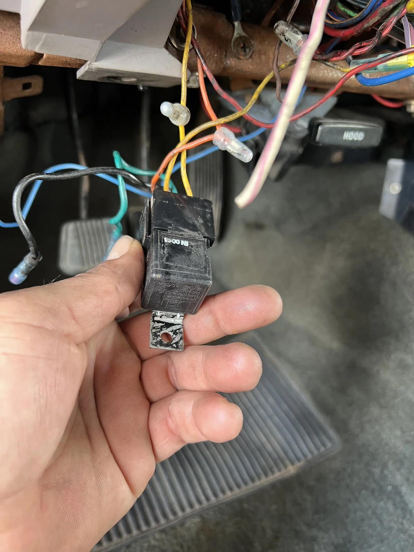

Hey guys my cars not starting,well it was. I’m not sure if it’s that I’m not stabbing my new Distbutor at tdc, or if it’s a wire. So I see 3 relays under dash but the one hanging looks really bad. Anyone know what this might be for? I see a white with pink stripe wire and it was connected to the green wire. Any input is much appreciated

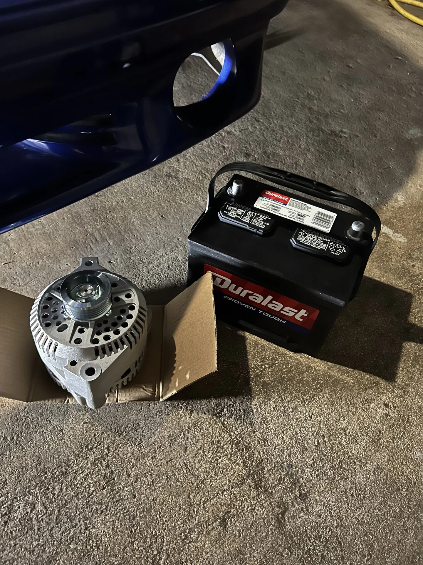

Still checking. Bought new battery and alternator . It cranks no start. I take back what I said before I said it turned on and turned off. It was more like it wanted to start but didn’t, just cranked . Crank was weak took alternator to have checked failed replaced but still doing same thing. Stabbed over and over. I have 2 foxs so I’m pretty good at setting timmng. Usually it they fire off for me but this one is a different from my 89. The wiring on that relay that’s hanging off Dosent look soo factory. Anyone know what that relay is for? The one hanging in the pics.
