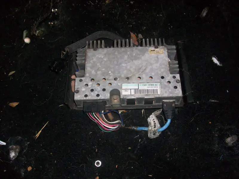

Hey guys I finally got started on cleaning out my interior, I took off the passenger side seat and found this box, I knew it was there but never looked at it until now because I have the seat off, I am guessing its the factory amp? its a 93'.

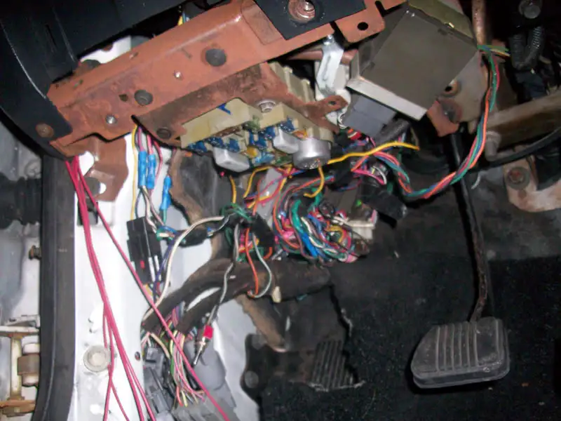

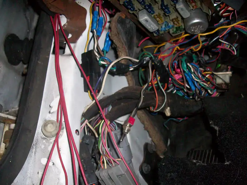

Last I guess the person who had this car before me butchered the wiring under the dash and didnt realize how bad it was until I started taking apart all the kick panels, and dash pieces. It used to have an alarm so I am thinking maybe some of the wiring is from that? There are tons of butt connectors where I can see they have spliced something in, there is a small switch, and there a few loose wires just hanging out, also in the engine compartment behind the driver strut tower there are a few loose wires. Not sure what to do about this?
What a mess...
The first picture is sound amp for the premium sound system that came with the car. If you put an aftermarket sound system in the car, you can ditch it or sell it on eBay.

The third picture is frightening. PM me you home address and I will send you a CD with the 92-93 Mustang service manual on it. The service manual software looks like it was written by a 12 year old kid, but it is usable and has all the diagrams in it.

Joe, I have ALLDATA for my car, I think that should have the wiring diagrams that I need? I will have to search through it as I havent gone through the ALLDATA info at all really. I almost want to just pull the dash out and go through each wire and redo it, should I do this you do you think I can fix this mess the way it is?

Success in fixing what you have is a function of your love for pain... :(
It can be done, but it might be simpler to get a junkyard harness and use it. The dash harness for 4 cylinder and V8 cylinder cars is the same. That fact is witnessed by the 4 cylinder to V8 swaps that don't seem to make any mention of replacing the dash harness. A 91-93 Mustang would be the donor for the dash harness.
