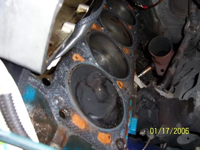

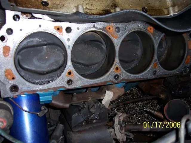

Hey, I just took the heads off the car and I know the engine has been rebuilt before I got the car. I was just wondering if anyone knows around what compression ratio those pistons are giving me. I have stock heads on it also. Thanks, Mike

I would say with a stock head you would be in the 8.XX range. CC the reliefs, once you know how much volume they take up I could give you an accurate number. Do they have a PT# scribed in the tops under all the build up?
Yes, if they are doomed pistons the compression should raise. We (some buddies) built a 302 last year with some doomed pistions and stock heads.. compression was right around 11:1... but its hard to tell by just looking at ur pistons what compression you may be running.
They look like the old TRW's to me! If they have a .440 dome there probably TRW Forged. If they have a .200 dome then there probably Keith Black Hyperutectic. If they are the K.B. pistons then You'll have high 9's-low 10's on the compression ratio with a 60c.c. head, uncut block and around a .042 gasket. I don't have a Federal Mogul Book in front of me to give you a round about figure on the TRW's.

Dude, right on the money!! TRW sounded a little familiar so I checked the pistons and one of them said TRW and they all said L2249N 030. Can anyone tell me anything about these pistons?

Pistons are L2249NF They made these in std.+.030. Bore sizes only. They have a 1.600 Compression Height and a .440 dome. The listed compression Ratio is anywhere from 9.91- 12.85 depending on the cylinder head c.c. (chamber size). With a stock 60 c.c. Head (69-70 351-w) the compression ratio is listed as 11.17:1 with a .036 gasket and the quench pad on the piston down in the cylinder .010. I'd say your compression is in the high 10's with a E-7 Head without knowing any specifics. I got these #'s out of an old 1989 TRW catalog I had Laying around. The ring grooves are listed as 1/16"x1/16"x3/16". Put on a good set of heads and match a cam and int/ex systems and the car will fly. The stock heads are not a good match for those pistons unless they are worked pretty good.
