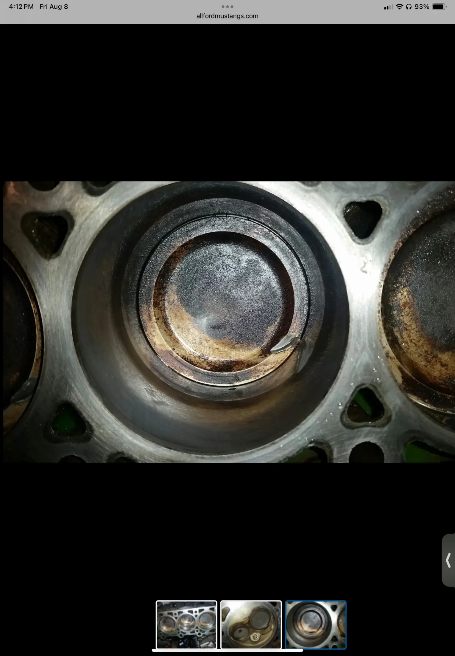

Found a small ding 5-6mm, another piston had smaller ding.
I tested compression 150 psi, it took 30 compression strokes to get to 150. But it’s consistent on all pistons.
My car was heavily modified by previous owner. Supercharged and valves look thicker, I think transmission has been built,,so I’m assuming it has low compression pistons.
I think no damage has been done. What you think? Thank you.

Check the blower impeller. Looks like debris has entered the chat and caused those. Dings/dents will cause hot spots and those lead to other issues that get exaggerated with boost. I agree with the others that at least pulling the heads is in order, but I'd be planning a full tear down if it were me.

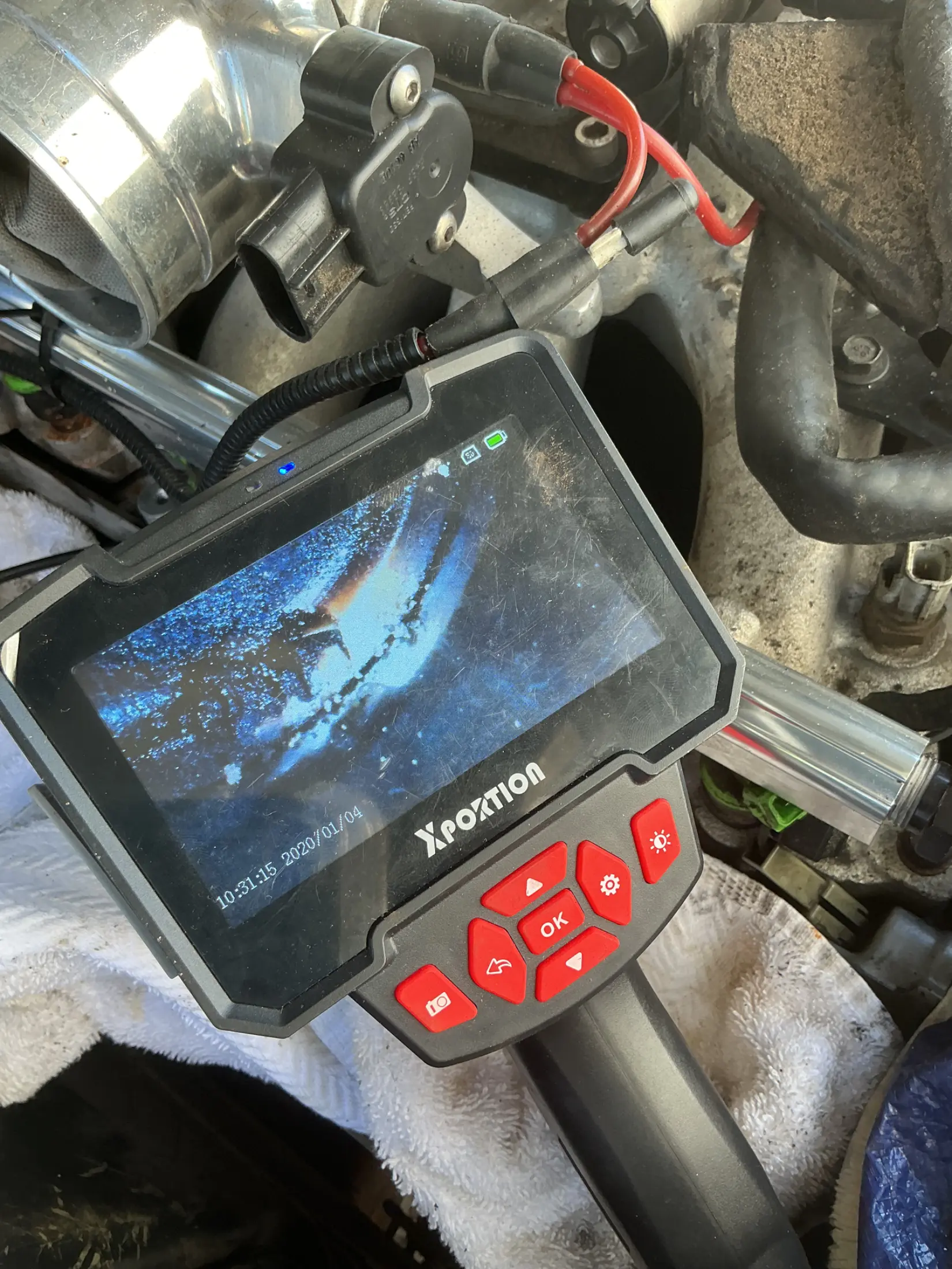

With more expensive scope I could see valves perfectly, it allows you to see upside down. That might be an option without having to remove the heads.
What about this pic. New edge Mustang that has valve ding very close to ring land.
That looks like it might be possible with an oversized valve.

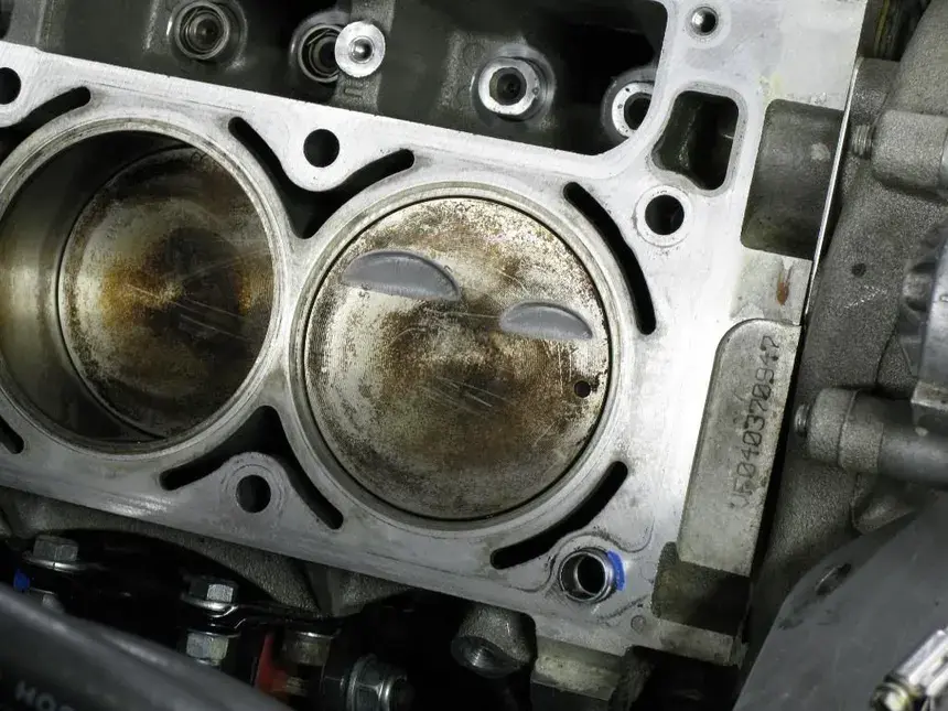

If you're getting valve interference, you would see marks in the areas where these pistons are fly-cut:
Those reliefs are intentionally made to prevent interference and also mark the location where the valves would interfere.
With the right head/valve combo, I could see where the image you posted could come from valve interference.

Cool. 150 psi on all cylinders indicates to me that there is no valve damage. Just a low compression motor that was fully built for boost.

Here is more details on car. It looked like with scope that valves are very thick, I think they are aftermarket. The ding in piston looked like it was a small object. I can see it’s not valve.
It has a grove with 2 parallel markings. I’m pretty sure someone ran the car without a filter before the supercharger and something must have gotten inside the engine.
