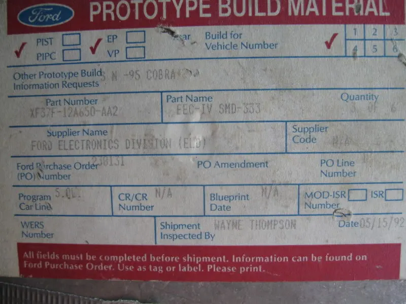

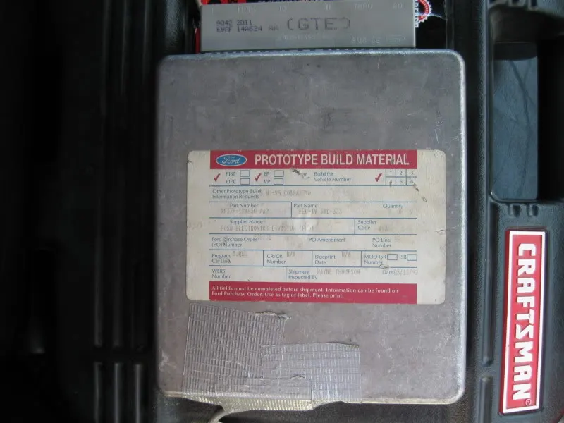

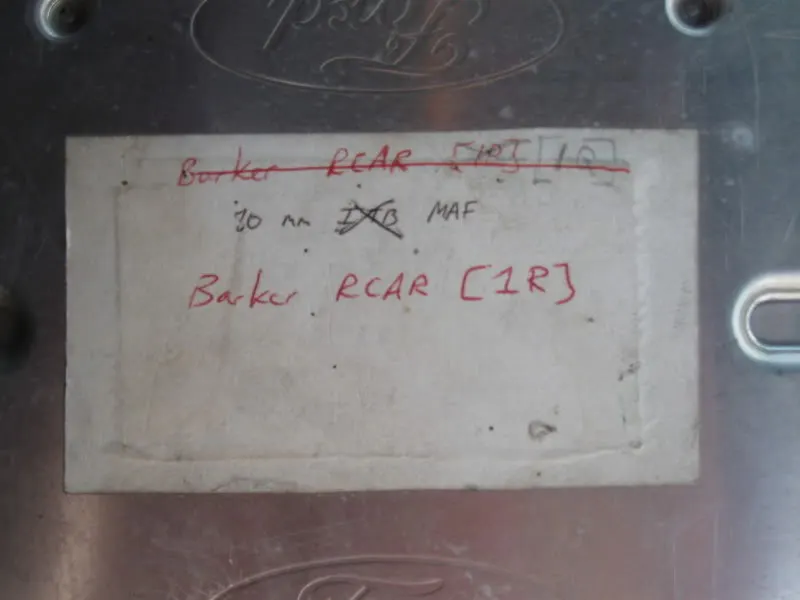

the ECU that was in the car was a custom program computer. When I had the SCT chip put in there was not specific code he could use to sync the chip w/ the ECU. He just put in a regular code for a 94/95 ECU. Since then I had picked up a 94 Cobra ECU and have put that in and been running that so far this year

The ECU that came in the car was not a standard ECU. It was a prototype unit that had a custom tune in it for the 351 swap that was done in the car. It was programmed by Craig Barker who at the time was the power train manager at Roush industries. All ECU's from the factory have have as you stated the catch code that tells what type of ECU it is. I cant remember what the catch codes are off the top of my head but there are a few different ones for 94/95 ECU's. When my SCT chip was made it could not be synced with any of those factory catch codes b/c none existed for my prototype ECU so he just put in a code for a standard 94 Cobra ECU. Since then I had bought a 94 ECU and have since decided to run it in the car. It runs fine, idles fine I did not think anything would change at all and I dont even know for sure if its the cause of my poor MPH as far as the chip and the actual 94 cobra ECU not being synced with each other.
