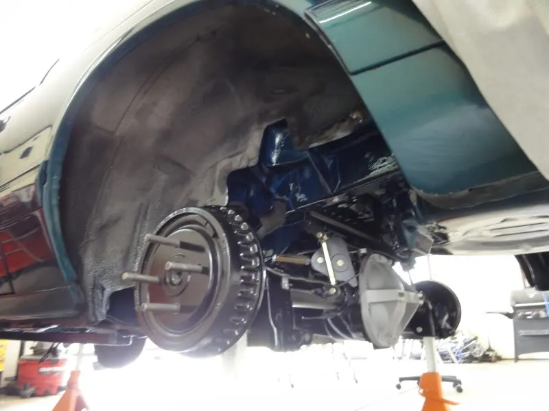

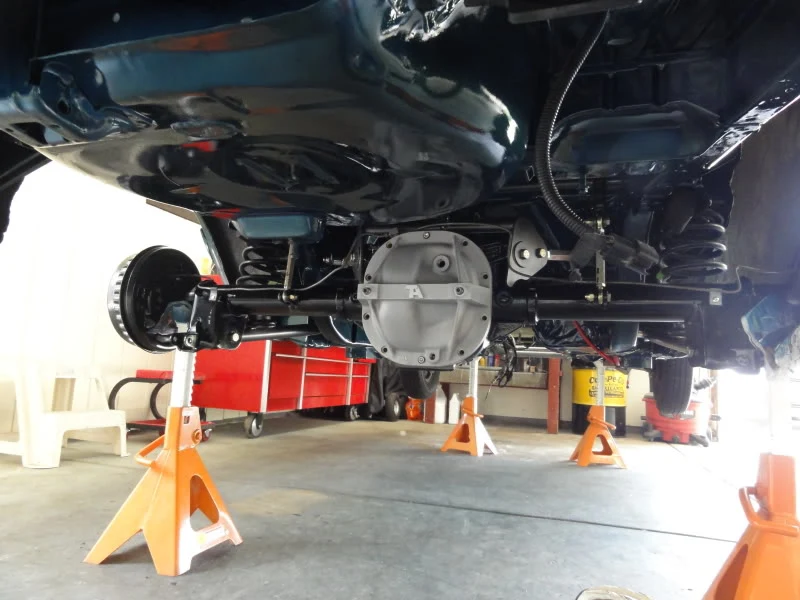

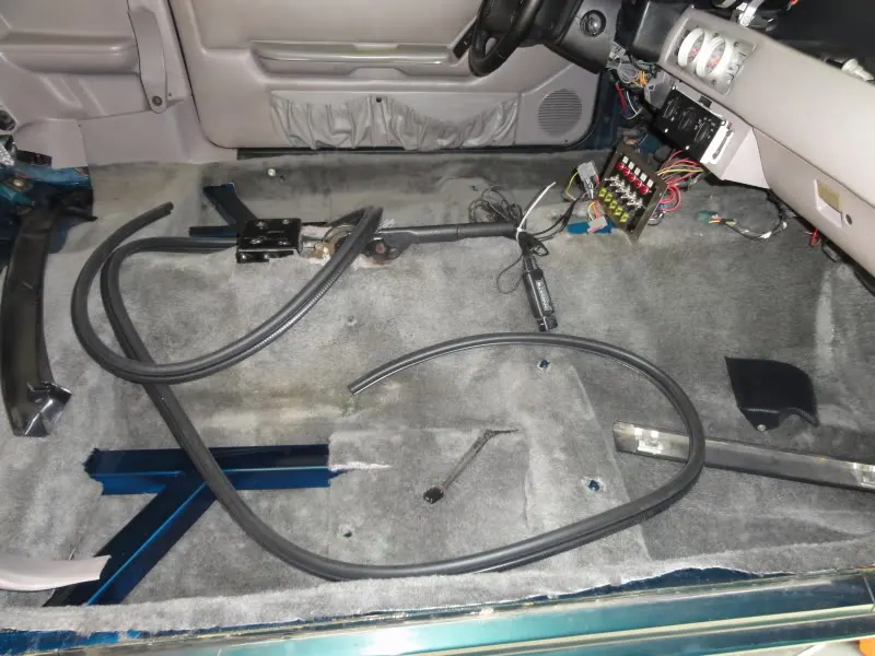

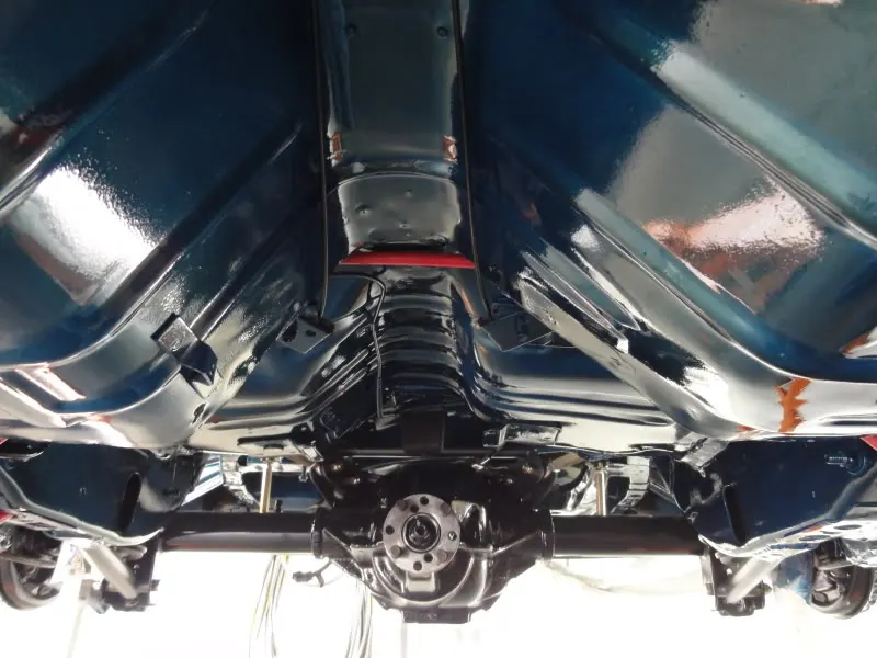

Reassembled rear brakes, park brake cable, clear coated diff cover, did a little on interior work, also not pictured are setting the install valve heights on the heads and cleaned old gasket surface off block and set new heads with new gaskets.
