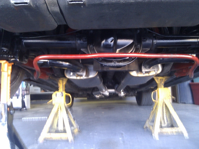

I tightened up the passenger side muffler/tube. It was leaking...
Also, since I cant fit 2.5" mandrel tails around the tires, I made a quick side dump pipe setup with clamp on elbows. They exit between the axles and the rear sway bar. The pipes exit in front of the conrol arm but it's still better than just dumping right at the muffler. There is about 2" of space around the pipe so there wont be any issue. Keeps the fumes out of the car much better this way.

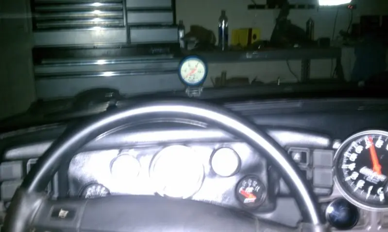

this normal
i know its a stock guage, still seems hot for me. only gets that high idling in traffic with the ac on. its been getting that high sometimes since i replaced the water temp sensor. id like to own a temp gun to help me figure this out but i no haz one.

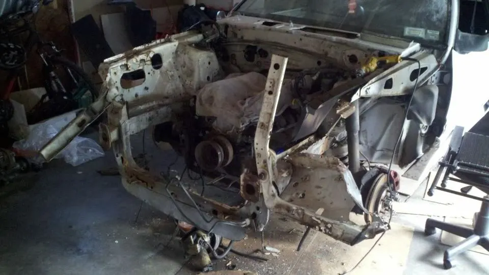

cut her up
lol getting creative with the core support and inner fenders before taking them off

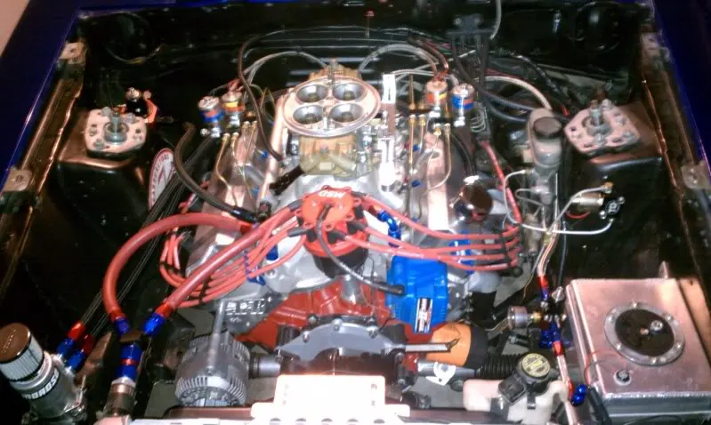

Made new lines and setup a catchtank for the crank case

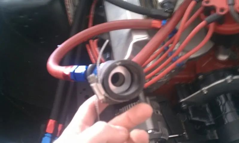

Made a coolant flow restricter since I got no t-stat and it runs a little hot

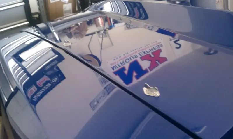

Put on some new fasteners on the hood.
Little stuff but a good day

fivespeedsteed said:
this normal
It does seem high. My 93 is usually on the second notch above 130, it goes a little over with the lights on. I have a Mishimoto aluminium radiator, 180* t-stat and Police fan clutch. with all else stock. It is not my daily though and the A/C hasn't worked for years.

you cant trust that stock gauge aside from it being cold, warmed up, and overheating....everything else in between is a guessing game

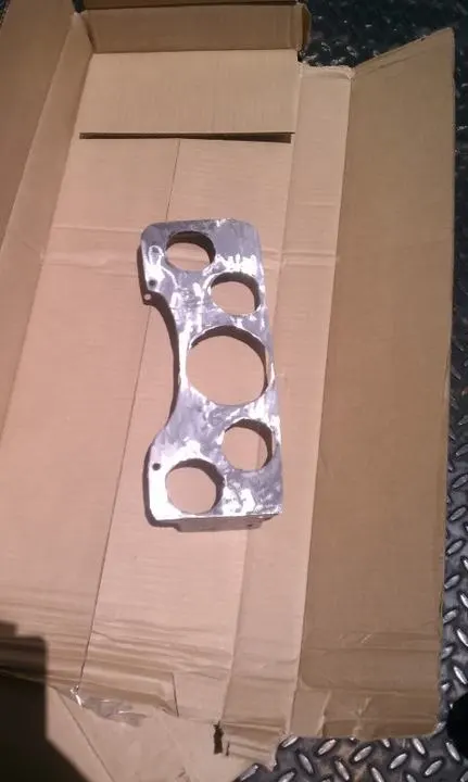

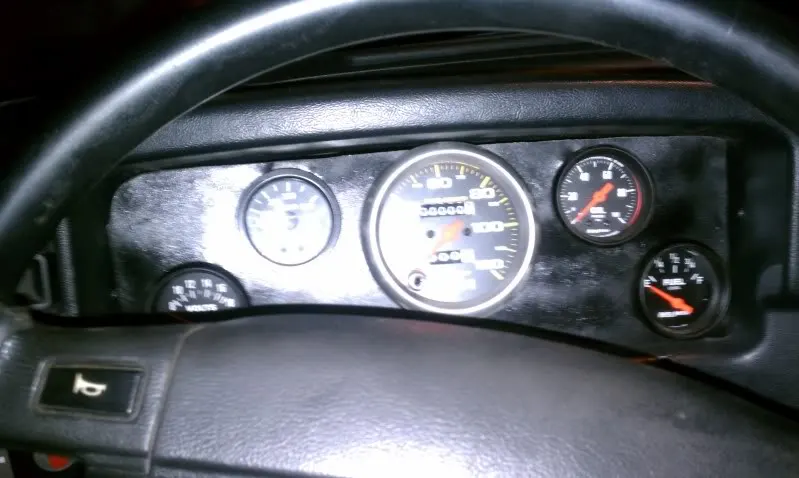

Made a gauge cluster...kinda looks ****ty for cell pics but it came out pretty good for the time I spent on it

I love your car. great color!
