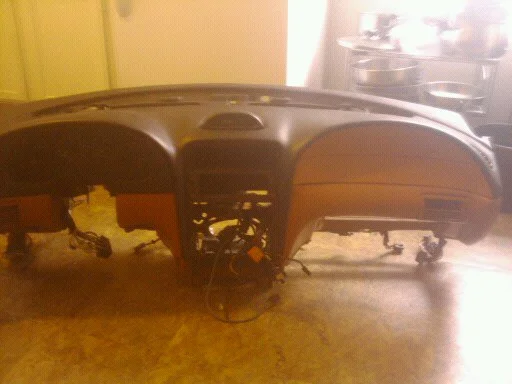

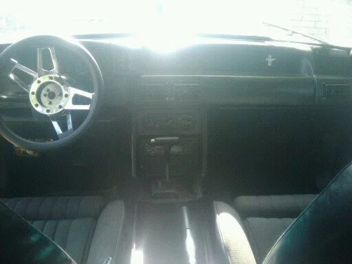

What do you think? SN95 Dash 93 Notch
It's still a project car, everything works, Cruise, A/C, drives well, and I love it. Still contemplating a color choice.
What do you think?

that looks sweet, i wish i had the time and money to do that but my fox is my daily. i think ive seen a write up on how to do this for a fox before. looks like it blocks the passenger side inner door handle tho.
I have maybe a weekend in doing all the work. Fab and what not. What you dont see is the brackets I made from 1/4" plate to mount the charcoal seat belts behind the factory quarter trim.
I used the entire harness from a 93 GT (car used to be a 4cyl auto) for the proper V8 harness's. I had a lot of wiring to do under the dash for the wipers (intermittent works too), turn signals, flash to pass, hazards, headlights, and dome lights. Most of the colors were the same as far as what they went to. Just had to either repin, or solder on different pigtails. The cluster was not as hard as it looks. 99% of the colors are the same between them (I used a 95 GT cluster). The most taxing part of the whole swap was making sure I had a good seal between the HVAC and the dash. The A/C in this thing will freeeeeeeeze you out if you let it.
