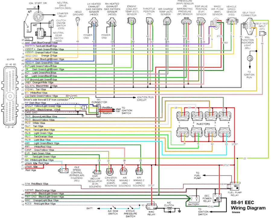

I was rewiring part of my car, and I happend to forget to lable these 2 wires. they are in the wiring loom that is right by the starter selonid. one whire is black with a orang stripe, the other one is a yellow wire, but it is not the yellow wire that has 4 wires going in to one, I already have that one on the starter relay.

i can tell you right now that if you follow those 2 wires i bet they go through the headlight harness to the alternator.

I was laying down i bed this morning and realize that those 2 go on the battery side of the starter selonid

they do and the other end goes through the headlight harness to the alt.i just rewired my whole car.
