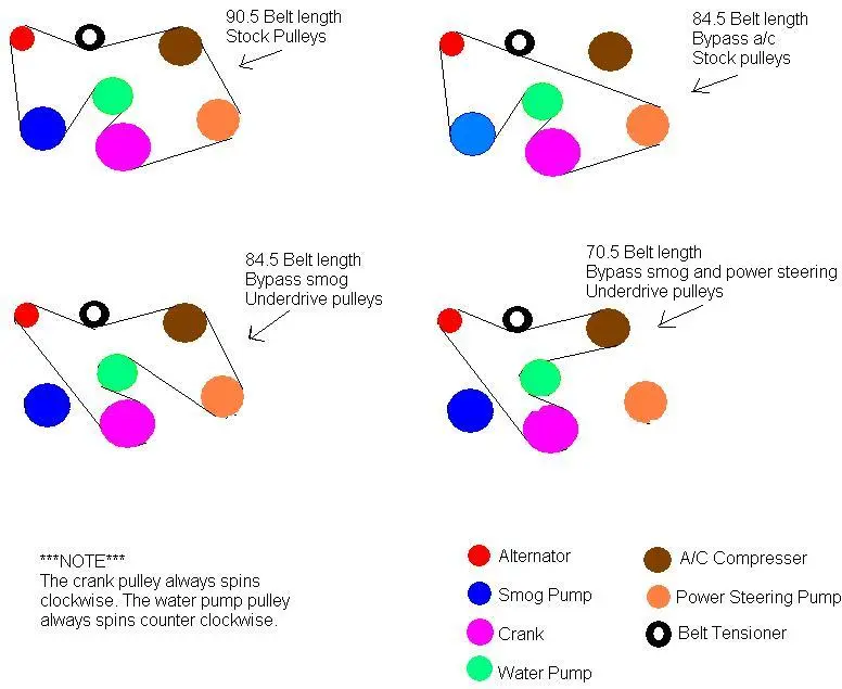

Does this help?

THANKS - are those numbers in inches???? Those diagrams are nice..... thanks again

Yes they are in inches. I updated the diagrams myself. Although I got the diagrams off a site somewhere (they were just to cheesy for me), so don't kill me if something is wrong. But I have seen the same lengths mentioned numerous times so I assume they are all correct. I use the 84.5 with stock pulleys to bypass the a/c (which has been chunked) and I run a Smog delete pulley.
There is one type-o..I am gonna fix now. The last pic has the wrong wording. It should say: 70.5 belt length, bypass smog pump and power steering, with underdrive pulleys.

I fixed the type-o and removed the diagrams and posted the updated one in its place in my original post.
