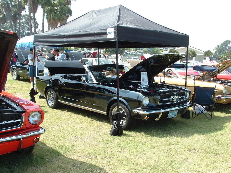

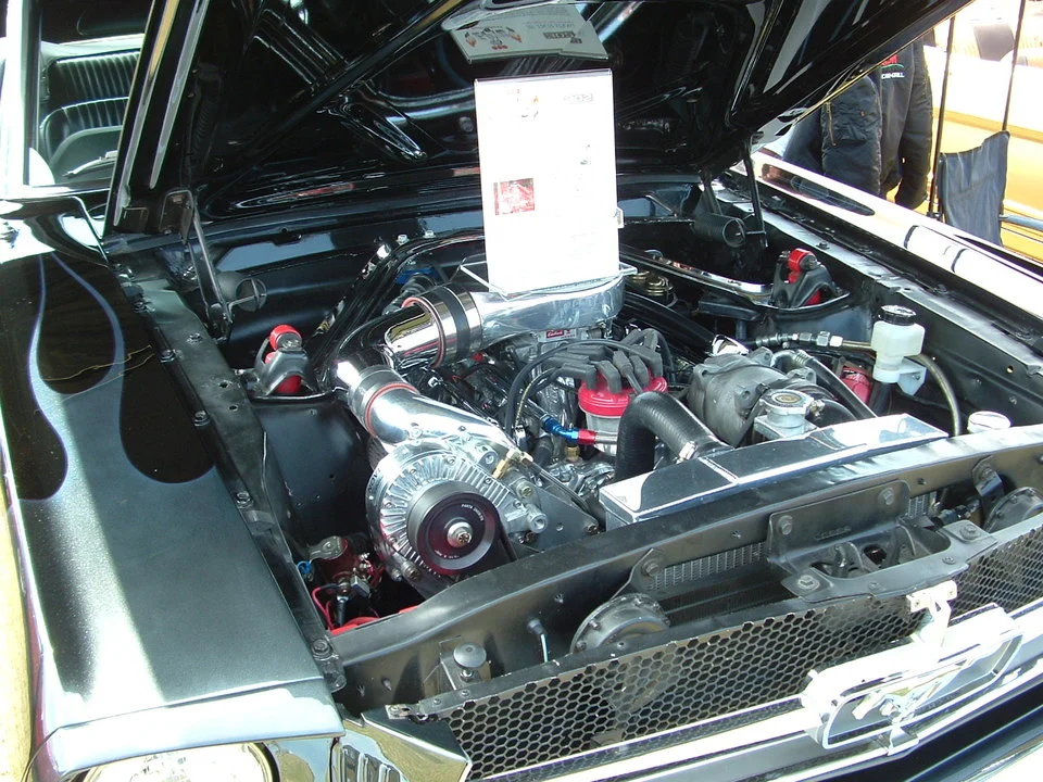

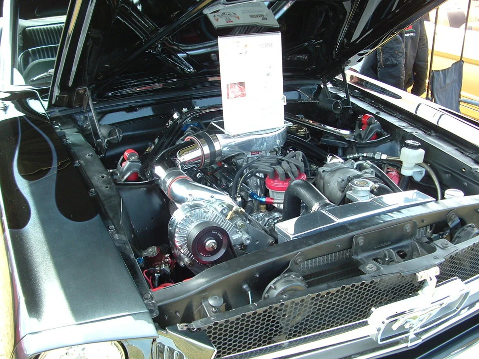

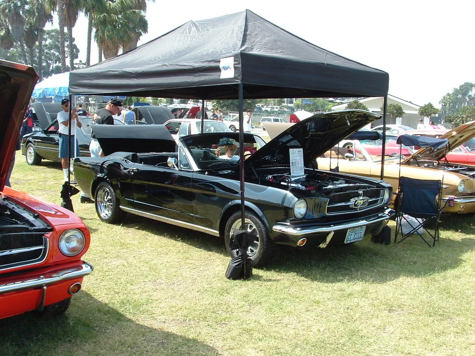

TOM B said:
Tell me what electric fans your using and the CFM. how well it cools when its hot out. And what radiator your using, stock or aluminum.
Isn't this one yours?
I think I met you at Mustangs at the Queen Mary show this year...
That 17" radiator limits you quite a bit. You should consider moving into a bigger radiator to cool that monster! Then move to the fan!!!
