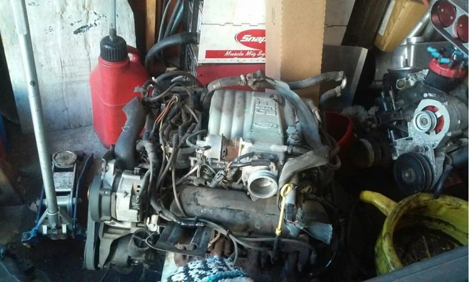

Hello all, just trying to find out what engine this is here, looks to be a 302 HO, wasn't out of a mustang so not sure if it's the HO or not....

The no HO engines have a different camshaft that changes the firing order.
Look at the distributor cap and see where the spark plug wires go.
This doesn’t prove that the block is a HO block. Some trucks evidently use a HO firing order
with a low lift cam (this will result in less than the desired HP output). However, it will definitely prove that a block can’t be HO because the firing order is wrong.
Remove the #1 & #3 spark plugs. Put your finger in #1 spark plug hole. Crank the engine over until you feel compression on #1 cylinder. Slowly turn the engine until the TDC mark and the timing pointer line up. Mark TDC on the balancer with chalk or paint. Put your finger in #3 spark plug hole and crank the engine 90 degrees. You should feel pressure trying to blow past your finger. If you do not feel pressure, repeat the process again. If you feel pressure, it is a HO engine.
No pressure the second time, remove spark plug #5. Put your finger in #1 spark plug hole. Crank the engine over until you feel compression on #1 cylinder. Put your finger in #5 spark plug hole and crank the engine 90 degrees. If you feel pressure now, the engine is not a HO model, no matter what it says on the engine.
Using a small carpenter or machinist square to mark the harmonic balancer off into 90 degree sections may be helpful here.
A 15/16 deep socket & breaker bar or ratchet may be used to turn the engine.
The HO firing order is 1-3-7-2-6-5-4-8.
Non HO firing order is 1-5-4-2-6-3-7-8
Non ho engines come that way. I mean it's a possibility someone flipped it, I've seen turbo cars do it for clearance.
Checking the firing order like posted above would be the quickest way to rule out a grand marquis or town car engine.
My guess would be a 5.0 non HO engine from a Lincoln Town Car or Crown Vic based on the accessory brackets, the flipped intake, and the exhaust manifolds.
