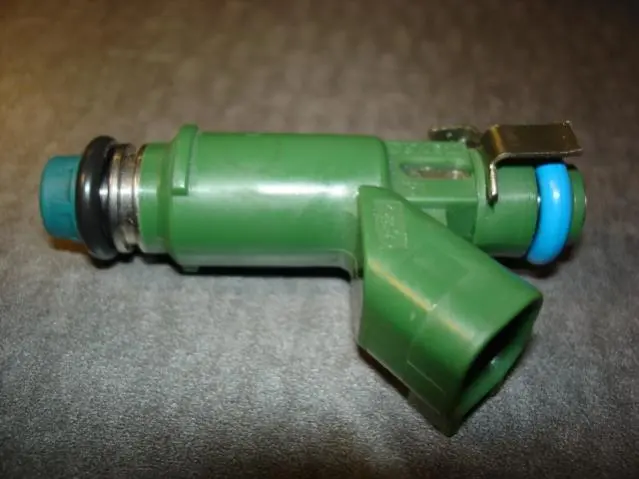

WHT306 Member Oct 21, 2008 104 0 16 HUNTSVILLE AL Nov 19, 2008 #1 Nov 19, 2008 #1 I HAVE AQUIRED A SET OF 8 OF THESE FUEL INJECTORS AND AM TRYING TO SEE IF I CAN USE THEM FORD # 1X4Z 9F593 AB AND WHAT LBS. OF FUEL ARE THEY ANY INFO WOULD BE GREAT Attachments STANGNET. PICS 008.webp 20.7 KB · Views: 193
5.0Droptop ...all those nights we shared, and you're a dude?? Special Agent Mukity-Muck Whats in Charge Round Here May 15, 2002 1,785 1,130 233 Indiana Nov 19, 2008 #2 Nov 19, 2008 #2 I think those are 36# injs
Mustang5L5 That is…until I whipped out my Bissell Mod Dude Feb 18, 2001 43,264 17,952 224 Massachusetts Nov 20, 2008 #4 Nov 20, 2008 #4 I seriously doubt you can use those.
Maryland Stang Active Member Aug 21, 2002 1,656 30 39 Greenville, NC Nov 20, 2008 #5 Nov 20, 2008 #5 Are there any other numbers. The numbers you posted aren't bringing up any hits.
WHT306 Member Oct 21, 2008 104 0 16 HUNTSVILLE AL Nov 20, 2008 #6 Nov 20, 2008 #6 HERE'S THOSE OTHER NUMBERS 1X43-AB 1X43 9F593 AB MM 1X43 AB DENSO/FORD 4011 12 389 I WAS JUST TRYING TO SEE WHAT THEY ARE TO EITHER USE OR TO SELL DEPENDING ON LBS
Maryland Stang Active Member Aug 21, 2002 1,656 30 39 Greenville, NC Nov 21, 2008 #7 Nov 21, 2008 #7 WHT306 said: HERE'S THOSE OTHER NUMBERS 1X43-AB Click to expand... I got a hit off of this number. It's a Denso injector used by GM, Ford and Toyota. The engines it was used in were 4 and 6 cylinders. Low performance mostly.
Mustang5L5 That is…until I whipped out my Bissell Mod Dude Feb 18, 2001 43,264 17,952 224 Massachusetts Nov 21, 2008 #8 Nov 21, 2008 #8 Get a meter and measure the resistance across the leads. If it's not ~ 14.4 Ohms of resistance, you can't use it anyway.
WHT306 Member Oct 21, 2008 104 0 16 HUNTSVILLE AL Nov 21, 2008 #9 Nov 21, 2008 #9 OK I WILL TRY THAT. IF I CAN'T FIND OUT WHAT THEY ARE I'LL PROBABLY CHUNK EM.
