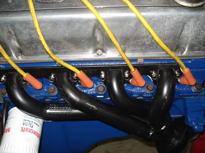

I have gt40 heads on my 65 Comet with Hedman 88400 headers, and no problems.

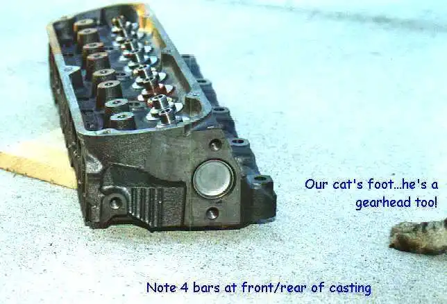

I know you say youre 100% sure you dont have P heads, but maybe you should take a pic of the front of the head to prove it to the rest of us. I had a set of unknown Hooker headers on some unknown 302 heads in my Comet and they fit great. Switched to Windsor Jr heads and they fit terrible (relocated plugs), then put the headers on a 65 Falcon with gt40 iron heads and they fit great. Heres pics of the Hedmans on gt40 non-P irons.

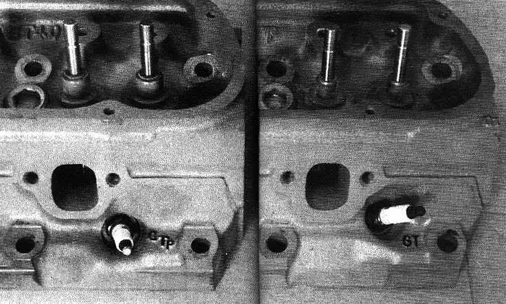

Heres the P heads
Thanks for the great reply - now we are getting somewhere. Ill check and see if those hedmans will work on my car.

I might be inclinded to agree with you if it wasn't for the stuff not captured in that thread - i.e. the three bars on the front of the heads, the "GT" casting, and the wierd off-sized plugs the head takes.

I will say that in the pictures that Decurion posted, those Hedman's on the #5 cylinder go down and then back. My tri-ys barely dip at all before heading straight back at the #5.

Either way, the combustion chamber photos you posted look exactly like the GTP.
In your article on how to port heads you mentioned you had to buy new valves. What size were the exhausts? P heads have smaller valves than non-P heads. Im with 65Shelbyclone on this one. Youve got P heads. Maybe some oddball ones marked as GTs, but the plug angle and chamber volume both seem to say theyre P heads. Non-P heads have ~63cc chambers, and P heads have ~59cc chambers, which after milling would bring them to the 57cc you claim. Youd have to mill the non-Ps almost .050 to get them that small.

I'll be damned if it doesn't look like I have the GT-40P plug angle. Look at the second picture I posted and then compare it to the pictures posted above. Look at how on the GT-40 heads posted earlier, the plug covers the "GT" casting, but on my heads, the plug doesn't seem to cover the casting.
