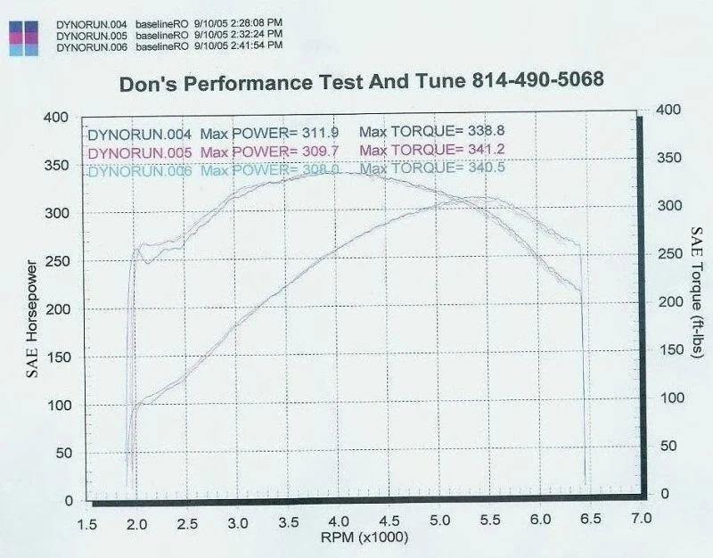

312HP and 340TQ with 302 TWheads and AFM blower cam (if i have one of those custom cams i could have a lot more)
BUT you can build 4.6 with good port job on PI heads ,some good cams and you will break more than 300HP , but it will cost a lot more than build 302
